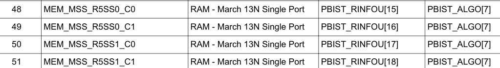

Could you please provide some info on what are these memory regions CR5A ROM0 and ROM1? We are planning to do PBIST Test as part of SBL, we are using R5FSS0- Core 0 in lockstep mode. In this context, are we needed to test memory regions 16 and 17? Can you also provide insight on memory regions 48-51, Since we are using core 0 only 48 needs to be tested as part of PBIST test or both 48 and 49 are required.
    These regions correspond to the TCM (Tightly Coupled Memory) or cache memories local to each R5F core.
    In R5FSS0 Lockstep Mode, you MUST test BOTH Region 48 AND Region 49.
    • In lockstep mode, Core 0 and Core 1 of R5FSS0 execute identical instructions simultaneously. Core 1 acts as the shadow/checker core.
    • Even though Core 1 is not independently programmable by the user, its local memory (TCM/cache) is still physically present and active.
    So, we should perform test for both regions 48 and 49.

  • Hi Jagadish,
    Thanks for the info. So in this context, If we are planning to test regions corresponding to TCM (regions mentioned below)...In TCMA address 0x0, we have vector table residing. Since PBIST is destructive test, Is it possible to move the vector table to some other location and update some register to indicate that moved location; then test TCMA and then move it back.

  • Hi Vandana,
    As mentioned in this user guide,
    User Guide
    PBISTROM, MEM_MSS_L2_0, MEM_MSS_L2_1, ATCM0_R5SS0, ATCM0_R5SS1, BTCM0_R5SS0 and BTCM0_R5SS1 are already taken care by ROM PBIST. So, no need to test these memories again at SBL.
    PBIST at boot can detect permanent faults and ECC SECDED in run time to detect latent faults. For remaining memories, we always suggest customer to perform PBIST at very beginning of the SBL as this test is destructive in nature.
