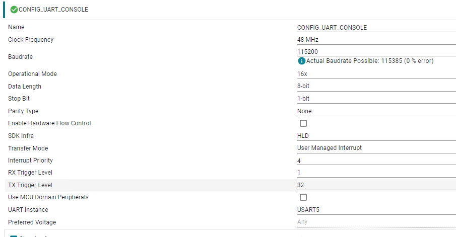

  1. The UART configuration is shown in the figure below, RX trigger level = 1 byte, and the interrupt mode uses "user managed interrupt" mode.

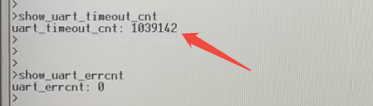

  3. We recorded the number of timeouts and read it after about ten minutes of testing. The timeout count reached the millions, while other prototype units running the same code either do not exhibit this issue or have only one or two occurrences.
Is the i2310 workaround really a verified and reliable solution? Are there any other recommended measures?

    We performed the simple test described below: after executing the WA2310() workaround patch, we rechecked the IIR interrupt register and found that IT_TYPE still indicated a TIMEOUT interrupt, as shown in the figure below. The readings from the uart_timeout2_cnt and uart_timeout_cnt counters are consistent. Does this mean the timeout interrupt was not cleared successfully?
    Customer feedback it is more easy to reproduce at low temperature -10C. Do you know is it sensitive to temperature? If the condition remains, will it retrigger the issue repeatedly and frequently?
    Customer referred MCU SDK workaround code to clear error FIFO interrupt, but it keeps re-enter, and read interrupt status register just after clearing, the interrupt status is not cleared.  is it due to new error interrupt triggered again, or the workaround code doesn't clear status at all?
