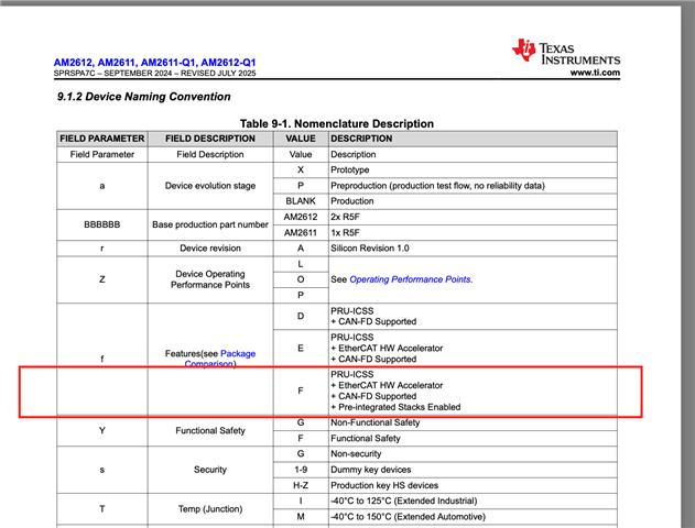

    We are evaluating both options for a gateway product on AM2612. Our target requirement is up to 16 concurrent connections in total. Could you please help with the following?
    1. Licensing and fees: What is the licensing model and cost for Premium (one-time fee, per-unit royalty, or annual)? The same question for Standard in production, since we currently use the evaluation SDK (ind_comms_sdk_am261x_2026_00_00_06_eval).
    2. Upgrade path: Can we move from Standard to Premium later without re-porting our application? Are the APIs and example projects identical?
    3. Connection limits: With Premium, what are the maximum values for TCP and UDP connections? Can they reach 16 or more?
    4. Premium features: Please confirm which features are Premium-only (we understand: Asynchronous Connections, CIP Safety integration, DLR Supervisor, Application Triggered).
    5. “F” feature code: The AM2612 datasheet (SPRSPA7C, Table 9-1) lists feature code F as “PRU-ICSS + EtherCAT HW Accelerator + CAN-FD + Pre-integrated Stacks Enabled”. If we order a device with code F, are the royalty and software licence fees for the pre-integrated stacks already included in the device price, with nothing further to pay? Does this apply to EtherNet/IP as well? And does code F correspond to the Standard or the Premium SDK?
    Thank you very much for your support.
    Daniel
  • Hi Daniel,
    Please find my responses to your questions below:
    1 & 5) SDK Variants and "F" Variant Hardware The Standard SDK is free to use. When purchasing an "F" variant device, the costs for the pre-integrated stacks are already included in the chip price (no additional fees are required).
    For more details on the different SDK package variants, please refer to this documentation: AM261x INDUSTRIAL COMMUNICATIONS SDK: Introduction.
    Please note that the "F" hardware variant is independent of the choice between Standard and Premium SDKs. To use Industrial protocols, you must use an "F" variant chip as specified in [SPRSPA7C, Table 9-1.2], regardless of which SDK version you select.
    The Premium SDK is distinguished by its additional features and enhanced support levels. If you are interested in evaluating these features before a full purchase, we also offer a "Premium-Time-Limited" SDK on demand (which includes all premium features but limits stack runtime to 1 hour). Please contact your local TI Sales Representative for more details.
