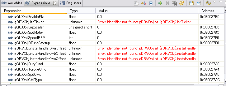

I got DRV8301-EVM kit. And now I am trying to work BLDC motor that it is included in EVM kit.
I built sample project that is in /sw/solutions/instaspin_bldc/boards/drv8301kit_revD/tms570ls1227/projects/ccs5/porject01. And I tried to run it.
But I got some error after execution script. Please see below.
gDRVObj.isrTicker is Error.
gDRVObj.instaHandle -> vaOffset is Error.
gDRVObj.instaHandle -> vbOffset is Error.
gDRVObj.instaHandle -> vcOffset is Error.
I don't know the cause of the above errors.
Please advise me how to solve this problem.

  • They show as an error because the CCS compiler optimize them (I don't think they are not used in the now running flow).
    You can choose to ignore them, or remove them from the watch window.
    Or if you really want to see it, disable the optimization of the project or set to a lower level of optimation, and these variables should be able to show up.

  • Dear Haixiao-san,
    Thank you for your reply.
    I disabled the optimization of the project. But the errors still exist. My motor does not work yet. Why?

  • I apologize for the delay response. I was out of the country on vacation when you post it. And I did not pick it up when I came back until a new post comes to my email box in this thread.
    The problem is:  “gDRVObj.” does not exist in this project. It should be modified to “drv.”
    The factory default position is correct (No 5 and 7 may be 2 and 4 depends on the component orientation) .
