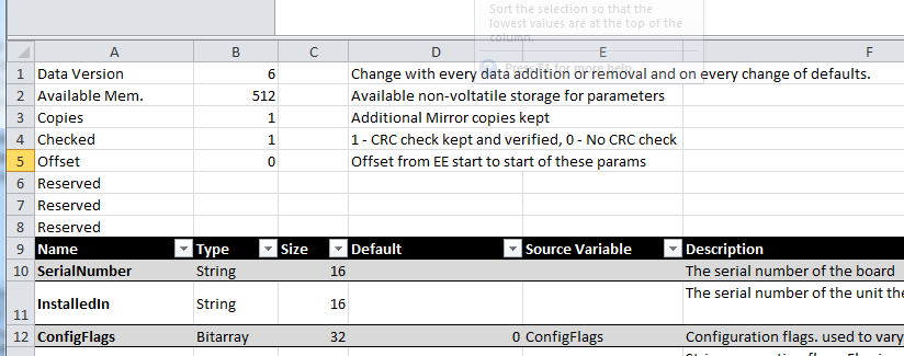

  • And if you are interested in the next level of abstraction. I develop the structures in a spreadsheet (one tab per block) and generate any needed code from there.
    Robert
