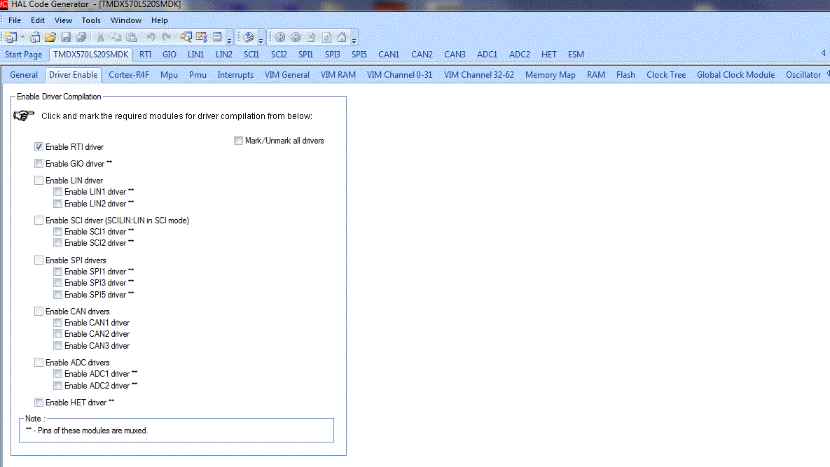

    Create new project (select correct device).

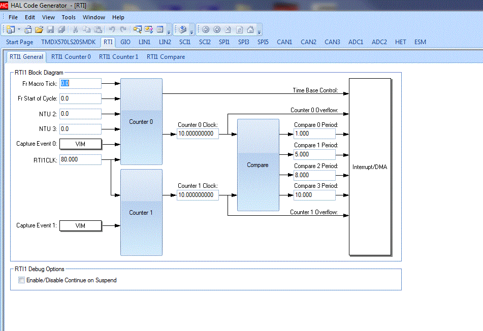

    Go to DriverEnable tab (see attached screen shot) and select only RTI driver to be generated.
    Go to RTI tab (see attached screen shot) and configure interrupt interval time for 1 ms and 10 ms.
    Click on generate codes.  This will be baseline codes.  You can add user configuration on top of these baseline API.

    I took a look on RTI module. At the moment I am trying to generate 10ms periodic intervals. RTI configuration was performed in HalCoGen:
    1) RTI driver enabled,
    2) Comp 3 source is Counter 1,
    3) VIM channel 5 enabled for RTI Compare 3.
    rtiInit () was first called in CCS. Then Compare Interrupt 3 was enabled and RTI counter block 1 was started.
    The problem is so that periodic interrupts are not generated. What is wrong in this example? The project is attached.
