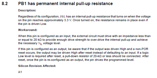

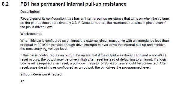

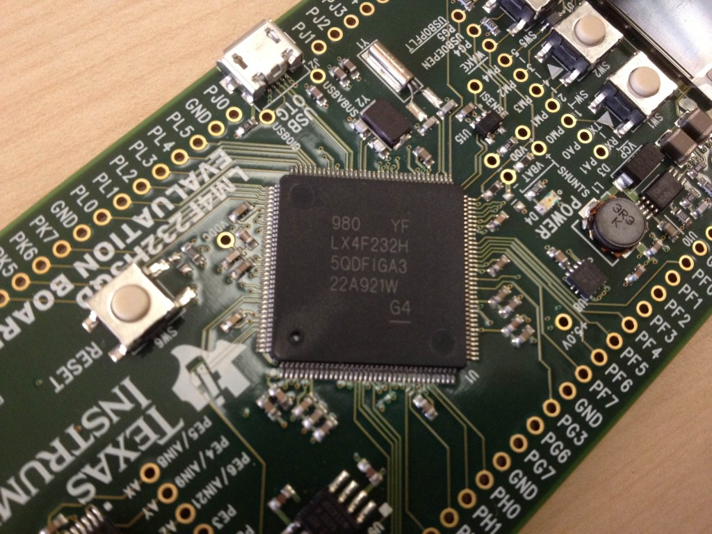

    In regards to the board, would you be open to posting a schematic? For the chip, is there any chance you can provide me with the complete label information on both chips from the EK-LM4F232 board you have, as well as the LM4F230 chip. I'm looking for the date code and the revision (A1 v. A3), because those will specify if certain errata apply on one and not the other. More specifically the following erratum might cause problems:
    Reagan

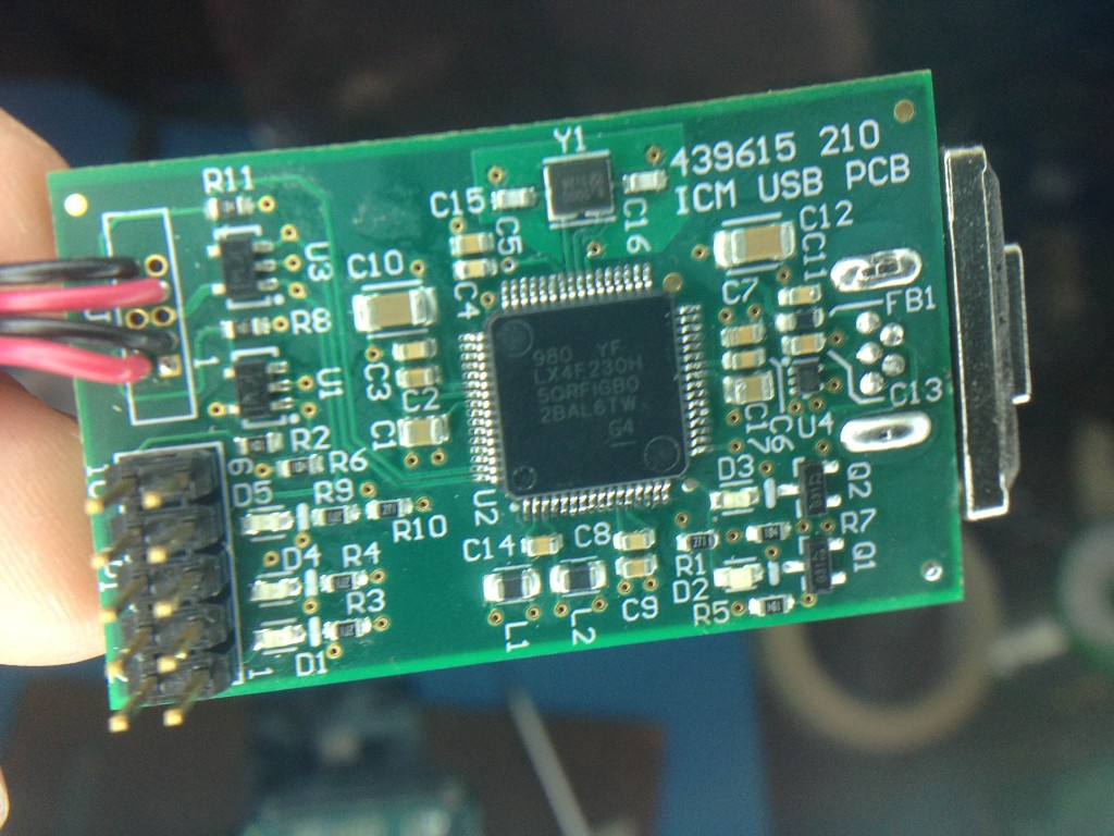

  • Hi Reagan,
    Thank you for your reply.  Below are pictures of the IC on my board and the IC on the eval board.  Attached is the schematic.
    On the schematic inside of the white box that didn't print is an LED and resistor attached to USB_VBUS.  PD4 is listed for both USBDP and USBDM but the pinout is correct, it's just a typo on the port pin label.  3.3V is applied externally and USB_MCU_PWR_EN is connected to 3.3V to turn on MCU_3.3V.  +5V is also applied externally and enabled when a host is detected.

  • Anthony,
    Can you confirm that those were indeed the only software changes you made? In regards to the chip, the errata I was looking at is not an issue since your silicon is revision B0.
    For the hardware, there are two things I'm noticing at first glance: (1) the MOSFETs tied to PA0 and PA1 need gate drivers between them, and (2) is it the case that you have a separate 3.3uF capacitor on the VDDC lines? Generally it's the case that the VDDC pins are connected together and driven by one set of capacitors amounting to that ~3.3uF value. On this point though, it rides on whether or not those pins are connected internally. If they are, then the setup you have is a problem. Ultimately though, I think point (1) might be the problem, since you can't directly drive MOSFETs with the CMOS pins. The USB section seems fine.
