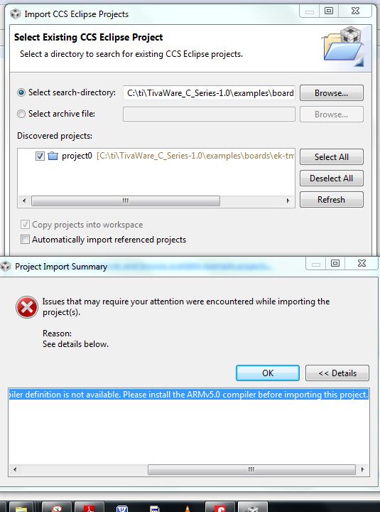

  • Im using stellaris LM4120H5QR launchpad board. LM4120H5QR project0 is work bt  when I import tiva TM4C123GXL project0 its make following error , anyone know the reason? ( data sheet say TM4C123GH6PM is identical to LM4F230H5QR)
    See details below.
    Error: Import failed for project 'project0' because its compiler definition is not available. Please install the ARMv5.0 compiler before importing this project.
  • You will need to install CCSv5.4 in order to pick up the support for Tiva C series parts. Even though the hardware is identical, but CCS tool treats the parts differently.

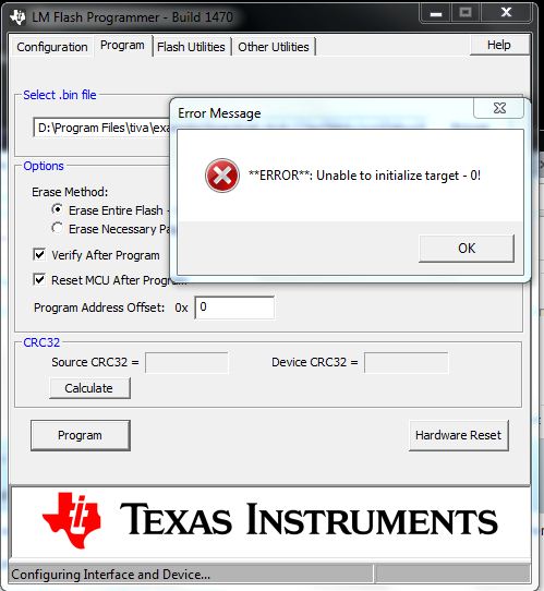

  • Im using stellaris LM4f120 H5QR launchpad board.  i need to program TM4f1236h6pm  uging JTAG port (Debug Out) . i used keil for compilig. when i debug
    it say unable to initialize target.
    bellow show the error massage when i use LM flash progaramer to load bin file.
  • Could you try the second option for erase method which is "only erase the necessary pages"? Does that help?
    Angela
  • same error display again..but when i program on board lm4f120 ic there is no error...
    may i know  what is the meaning of  "crystal vale" in LM flash programmer configuration window? because i used 20MHz external crystal to out board  processor
  • I don't think LMFlash programmer detects your target at all. Could you please clarify something for me? There is no debug out on Launchpad board, did you blue-wire it to your custom board which has TM4C1236H6PM part on it? If so, can you describe how you connect the launchpad with your own board?.
    Angela

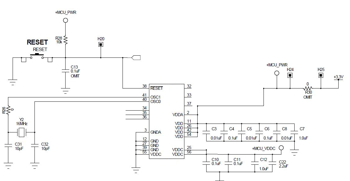

  • dear madam ,
    This is the case..
    I already have LM4f120h5qr stellaris launchpad board...and i made my own  board which has TM4C1236H6PM part on it. (SHOW  circuit diagram . crystal value should be 20MHz )
    so then i need to program my own board using stellaris launch pad and lm flash programmer/keil or ccs.

  • VDDC(pin55) is connected to the ground, this cannot work. Is that a typo? if not, please make sure it isn't directly connected to ground.
  • sorry there is mistake in figure ,
    pin 55 is not a VDDC pin. it is GND pin.so circuit is ok and addition to that  i check the VDDC votage ( LDO output ). it arrroun 1.22V according to data sheet. ..
    thank you..
  • I don't notice anything obvious in your schematics. You can use a scope and see if the 4 JTAG pins have any activity, especially whether there is a clock or not.
    There is wiki page about how to do the debug out with Launchpad, here is the link if you haven't seen it. You might want to connect the reset pin on the launchpad to your target processor.
    http://processors.wiki.ti.com/index.php/Stellaris_LM4F120_LaunchPad_Debug_How_To
    Angela
