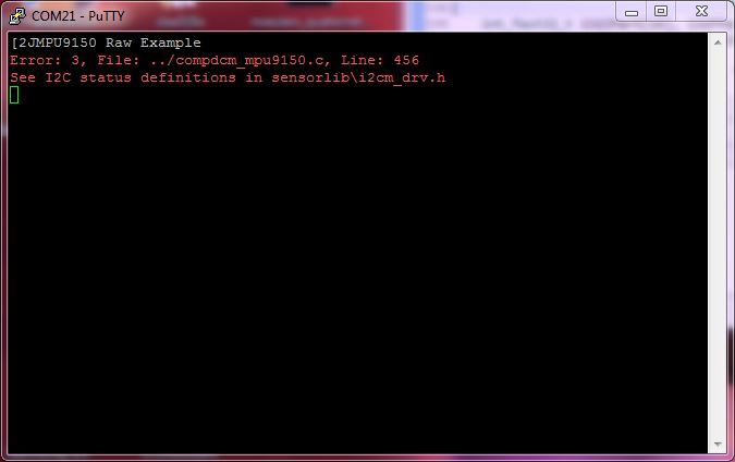

When testing all the samples provided I found that three of them were not working:
- Airmouse --> maybe related to my setup since I'm running CCS in an VMware Virtual machine (win7) on a MAC OS X host

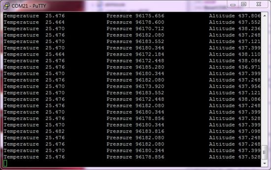

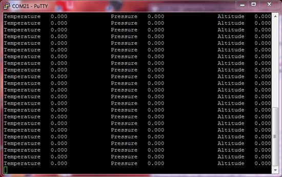

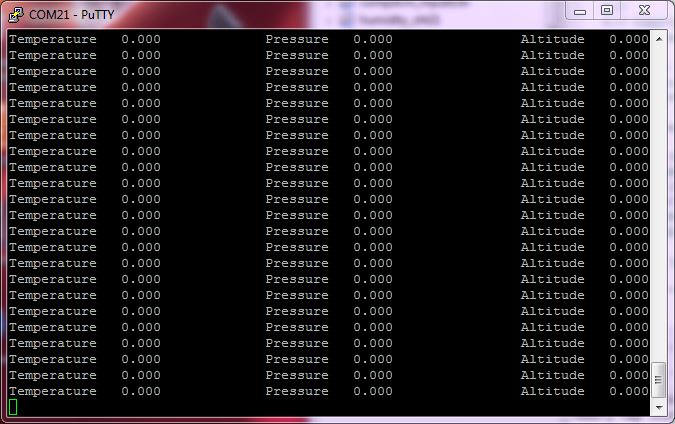

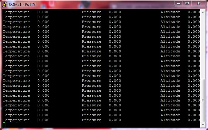

- BMP180 pressure sensor demo --> no air pressure! Don't worry: I'm still alive although there seems to be no air for me to breathe.

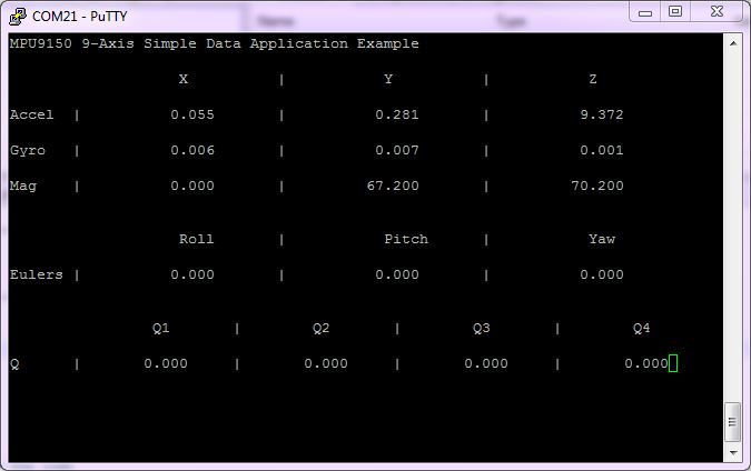

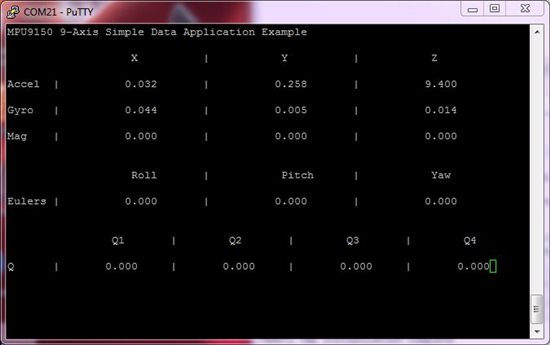

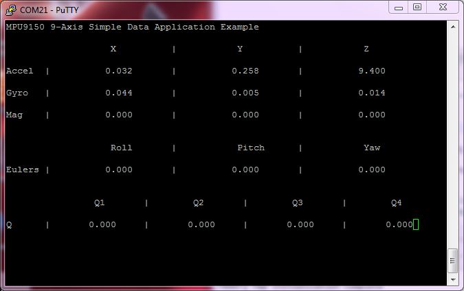

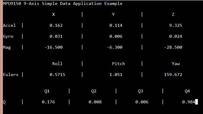

- MPU-9150 --> no MAG data --> no Euler Angles/Quaternations. Board is sitting flat on the table when capturing the screenshot (refer to z-axis value  = roughly 1g).

    Your "9 Axis" sample Accel reading "9.400" - so far from all others - seems mistaken or contrived...  (what's up w/that?)
    Hi cb1,
    this demo software (which is part of the new Tiva Launchpad examples) gives raw sensor data. The Accel Data in m/s^2 --> a value of 9.4 m/s^2 is the Z-Axis of the MPU-9150 when sitting level on my desk.
    The ACC is uncalibrated --> it's value is not 1g (gravity) = 9,81m/s^2 as I would expect from a (perfectly) calibrated ACC.
    The MPU-9150 is a 'lil' beast' (I know what I'm talking about since I also use it on my C3ii INS Booster Pack) --> since no data comes from the MAG something most gone really bad (when the guys at TI did their homework and choose the right way to initialize the auxiliary I2C peripheral interface of the MPU; did not dig into their code if they use passthrough mode, but since they provide a AK8975 API I think they do it the 'easy way').
    The BMP180 is from Bosch Sensortec (very similiar to the BMP085 with some 'marketing spec polishing'). A guy from Bosch Sensortec (working in the headquarters in Reutlingen) told me that the BMP180 (as the BMP085) mostly die by  insufficient handling during reflow soldering. Mounting them with hot-air is a pain in the a**.

  • Mr. Nightmare,
    I believe there is a known timing issue on a initial power up of the boards in some cases.  Not sure that the sensors are up and ready by the time the MCU starts doing I2C transactions.  Still investigating.
    One confirmation is to try doing a simple button reset after powering up the system.  Usually then everything starts working as expected.
    A not yet fully confirmed solution is to delay after I2CMInit.  At this point we have configured the pins and are ready to do I2C but this lets the bus sit idle while the BoosterPack finishes powering up and those sensors do their own init.
    We configure the MPU9150 to automatically do the transactions with the internal mag.  We use slave transfer (either 0 or 1) and 4.  The first transaction does a full read of the mag data into the 9150 data registers.  The second (slave transaction 4) does a simple write to initiate the next sample by the mag.  The slave transactions auto occur every fifth sample of the accel and gyro.  I am pretty sure we accept the default mag configuration and let the 9150 auto send trigger next mag sample and read mag sample into the 9150 data registers.  The M4 then does a single burst read of all the sensor data: accel, gyro and mag from the 9150 data registers. The mag data includes ST1 and ST2 which we use to confirm if the data is good.
    Another note. The current code does not do any attempts at I2C bus recovery.  When doing resets or debugging if the M4F resets during the wrong phase of an I2C transaction it can leave the bus in a stuck state.  The code is set currently to flash the red element of the RGB at 10hz and do nothing else if any I2C bus errors are reported by the I2C Master driver code.  On any example if you see 10 hz red on the RGB it means the i2c bus had an error and you need to reset or power cycle. There are ways to recover the bus but they were not implemented on these examples.

  • Hi Dexter,
    Confimed! But I needed multiple Button Resets to get a full set of data. Turning the board on all 3 axis while looking at the ACC values  gives data as expected (1g reading for each axis facing into gravity direction).

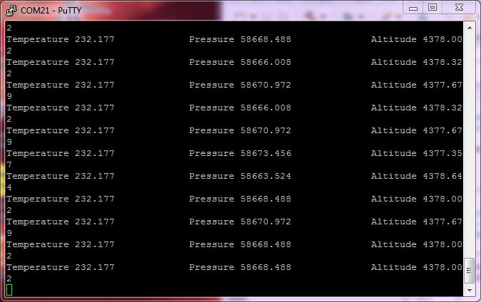

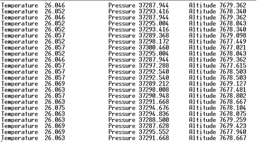

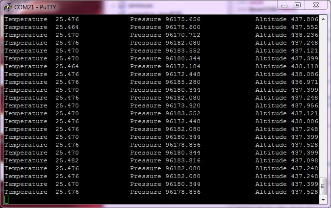

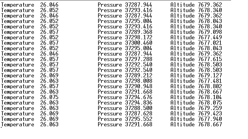

    Nevertheless, my BMP180 is still silent! I've connected a BMP085 I had on hand and get the data (Temp/Pressure/Alt). Since the BMP180 is the same device (only minor spec changes and another package) I assume that the BMP180 on my BOOSTXL-SENSHUB is faulty (since it gives no data; not even temperature).
    Any idea what to do? The other sensors (Light/Humidity/Temp) were nice, but I bought the boosterpack because it is a 10 DOF IMU (9axis + pressure).

  • Fixed up a couple of issues with the MPU9150 driver that i think are worth putting out now.
    Issue 1) We did not correctly issue a reset to the device during init.  MPU9150Init fills one buffer with the init data sequence and then transmits the other buffer over I2C.  This is resolved.
    Issue 2) On power up (and after any actual reset see issue 1) magnetometer data was not flowing from the device.  This was do to order of operations.  We first enabled I2C Master on the 9150 then brought device out of sleep mode.  This was done since that is the order the register appear in the 9150 memory map.  We now swap this order and bring device out of sleep mode (default reset state). Then enable I2C Master transactions.
    Interaction with MPU9150 is now much more robust and appears to work out of power up or reset conditions much more reliably.
    Attached is modified MPU9150.c file.  Put this into TivaWare SensorLib and build sensor lib. then REBUILD any projects that use sensorlib so that the linker will bring in the changes.

  • Hi Dexter,
    thank you for the information and the update of the MPU-9150 driver.
    Well, I'm sad to say but I'm facing issues with your latest driver version! Here's what I did:
    1.) Download your attached source file 6862.mpu9150.c, renamed it to mpu9150.c and droped it into the sensorlib-folder (replacing the old one)
    2.) imported and rebuild sensorlib
    3.) Cleaned 'compdcm_mpu9150'-project and build it
    4.) Flash it to LM4F120 Launchpad
    5.) Running the App (Resume (F8))
    Here's what I get:
    The terminal window will show the error message shown above!
    O.K.! So far -  so good!
    6.) stopping the active debug session
    7.) Reseting the Launchpad by Hardware reset (as we need to do before) results in:
    MPU-9150 gives data for ACC/GYRO/MAG, but neither Eulers nor Quaternations were calculated (outputted on the terminal). Several attemps to (HW-) reset the Launchpad always show the above picture.
    Conclusion:
    I can't confirm that your latest MPU9150.c solves the issues with MPU-9150! From my point of view the startup is better (HW-Reset), but there seem to be some (more) bugs since the app throws an error message after starting it for the first time and, in addition, it will not calculate Eulers/Q (with the old one the data was present afar one/multiple HW-reset).
    Rgds
    aBUGSworstnightmare
  • Downloaded and installed a fresh copy of TivaWare from the web to replicate this issue.  This behavior is actually a side effect of the "fix".  By virtue of the way the mag is set up it only gets new mag data after a sample or two of the accel/gyro.  The very first accel data sample you get triggers the mag to sample which data is then collected the next time around.
    End result is that mag data is 0.0f when you call CompDCMStart and this does not properly init the DCM.  I added the if(pfMag[0] != 0.0f) statement to the application compdcm_mpu9150.c code and this fixes the issue for now.  We'll try to make a cleaner solution for the full release.  A similar change will be needed for airmouse.
    if(ui32CompDCMStarted == 0)
    // Set flag indicating that DCM is started.
    // Perform the seeding of the DCM with the first data set.
    ui32CompDCMStarted = 1;
    CompDCMMagnetoUpdate(&g_sCompDCMInst, pfMag[0], pfMag[1],
    pfMag[2]);
    CompDCMAccelUpdate(&g_sCompDCMInst, pfAccel[0], pfAccel[1],
    pfAccel[2]);
    CompDCMGyroUpdate(&g_sCompDCMInst, pfGyro[0], pfGyro[1],
    pfGyro[2]);
    CompDCMStart(&g_sCompDCMInst);
    I can confirm that the BMP180 on my newly-received Sensor Hub is not functional.  Although I'm using an EXP430G2 with my own software, the code is proven to work with both BMP085 and BMP180s.  With the SensHub the code reads plausible configuration information, but the raw temperature reading is always 0xFFFF, and the raw pressure reading is 0x8040 with zero oversampling (the high bit gets shifted as appropriate when oversampling).
    Based on other comments I'm guessing the chip was mishandled during assembly.  I'm just hoping the remaining sensors work.  (I don't intend to use TivaWare so don't care if the supplied software is wrong.)
  • Peter,
    Thanks for the report.  Since you are getting data (though wrong) from the device this suggests you may have a different error from that found by aBUGSworstnightmare.
    I am going to pull a couple of samples from stock to spot check the BMP180 and the board assembly.
    Do you have a logic analyzer or o-scope? Can you confirm that the your code and the logic analyzer agree regarding the data on the I2C bus?
    Dexter
    Dexter
  • Yes, my Saleae Logic8 and my code agree on the values being read over the bus.  It's only raw measurement values (not the calibration block at a different address) that are completely unrealistic, suggesting a sensor failure not bus errors.

    I've tested a third boosterpack today and the results were shown below:
    - 1st one tested: no data from BMP180 (reason for starting this tread)
    total fail!
    - 2nd one tested: data is as expected (see below)
    Data from a working BMP180; at least Temp and Alt represent the correct figures; can't verify Pressure reading since I'm not able to measure it.
    - 3th one tested: Gives some data, but data is static --> device is not working (needs to be verified with logic analyser)
    Data is all static (except some minor variation) --> Heated it up (with my desk lap) --> Temp is not increasing --> device is damaged!
    Conclusion: BMP180 on two out of my three boosterpacks were damaged!

  • I am trying to get basic examples in Sensor hub to work on the older version of EK-LM4F120XL.
    However, I am getting this error message when I debug the program in CCS.
    The below output is coming through the debug port. (virtual com port)
    Air Mouse Application
    Error: 1, File: ../motion.c, Line: 901
    See I2C status definitions in utils\i2cm_drv.h
    Error: 1, File: ../motion.c, Line: 917
    Error: 1, File: ../motion.c, Line: 932
    Any thoughts what may be going wrong?
    There is an error in eclipse which says I am using a compiler version 4.9.8 while the airmouse source was written in 5.0.3.
    However my CCS does not update to 5.0.3 since the update program shows another error during the update operation.
    Also, I wonder how the compiler might cause such a problem with source.
    Any help appreciated.
  • The airmouse example is tested for each release for each compiler on the EK-LM4F120XL at least for TivaWare C Series 1.0.  One thing to try which would eliminate your compiler differences is to use the binary files that ship with TivaWare.  You can use the binary for any of the supported compilers.  Use LMFlashProgrammer to load the binary file to the LaunchPad.  We test these binaries as a part of the release process.  On good hardware they will work.  This will make sure your hardware is working.
    As mentioned earlier we have found that a reset button press is sometimes required to get the sensor hub and the MCU in sync.  This is being fixed for TivaWare 1.1.
    The compiler difference can change many things from timing to the implementation and optimization of our code.  I would suggest doing a complete CCS uninstall and then re-install from.  Without examing in detail the generated assembly/binary code it may or may not be contributing to your difficulty.  Strongly suggest to use the same or newer version.
    Airmouse and compdcm_mpu9150 both use the same sensor and drivers try both of these applications.
    Dexter
