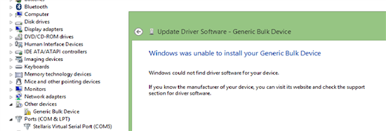

  • Hi Austin,
    I'm trying usb_dev_bulk example code with lm4f232, I am able to build the code, but not able to send r receive data.
    I'm following stellaris Launch Pad Workbook and I have installed StellarisWare Windows-side USB examples(from
     www.ti.com/sw-usb-win),
    After loading the code, on oled I can see usb-dev-bulk, waiting for host, Tx bytes:, Rx bytes: ,but in USB Bulk
    example i'm getting error as shown below,
    Actually in the device manager, it is showing warning symbol and even not able to install it also.
    Can you please help me out where i'm going wrong.
    Mamatha
    Now it is working fine, i updated the driver.
    Mamatha
