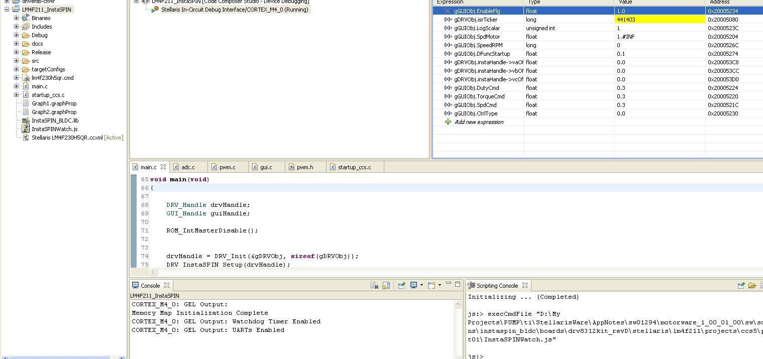

I work with kit DK-LM4F-DRV9312 and use an application "InstaSPIN™-BLDC Sensor less control for the Stellaris LM4F2x" Version 1.0.2. The CCSv5 was downloaded, installed, and i running.Then the InstaSPIN project was imported.I build program in DEBUG mode, launched a debug session to load the code into the controller. The Stellaris LM4F2x device was connected. The InstaSPINWatch.js script was loaded too. After press the Run button program is running, but the motor is not spin. The variable "gDRVObj.isrTicker" is changing (interrupts works). I set the “gGUIObj.EnableFlg” to 1, but motor is not spin.
"gGUIObj.SpdMotor"            floats   1. #INF            0x20005204
         See screenshot:
With "launcher.exe" as described in "DK-LM4F-DRV8312 READ ME FIRST" I successfully operated the motor using the GUI.
What is the problem of running debugging code to spin the motor?

    I've followed all instructions,but the motor still do not run .
    The variable gDRVObj.isrTicker changes from the start even gGUIObj.EnableFlg =0.
    And what is mean "gGUIObj.SpdMotor float 1.#INF " (INF???).

    I'm sorry, I haven't run this since we released it last summer. Since that time I've re-installed CCS (*cough* multiple times *cough* ) and don't have ARM support on any of my current isntalls, so I can't try to run it right now.
    The isrTicker should run all the time as soon as the project is put into the run state, regardless of other flags. So that's working correctly.
    I also saw that the SpdMotor variable had that 1.#INF flag. I've never seen that before.all of the gGUIObj variables are defined in gui.h
    gui->SpdMotor = SPEED_MEAS_CAP_Get_Speed_Output(gDRVObj.speedHandle);
    this is defined in
    sw\modules\speed_pr\src\float32\stellaris\speed_pr.c
    _iq SPEED_MEAS_CAP_Get_Speed_Output(SPEED_MEAS_CAP_handle speedHandle)
        SPEED_MEAS_CAP *speedObj = (SPEED_MEAS_CAP *)speedHandle;
        return speedObj->speed;
    Everything looks ok to me.
