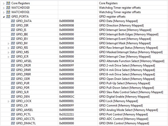

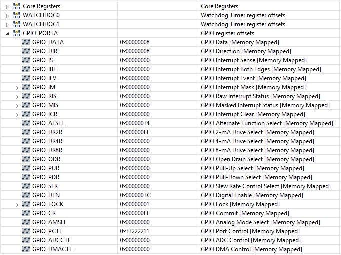

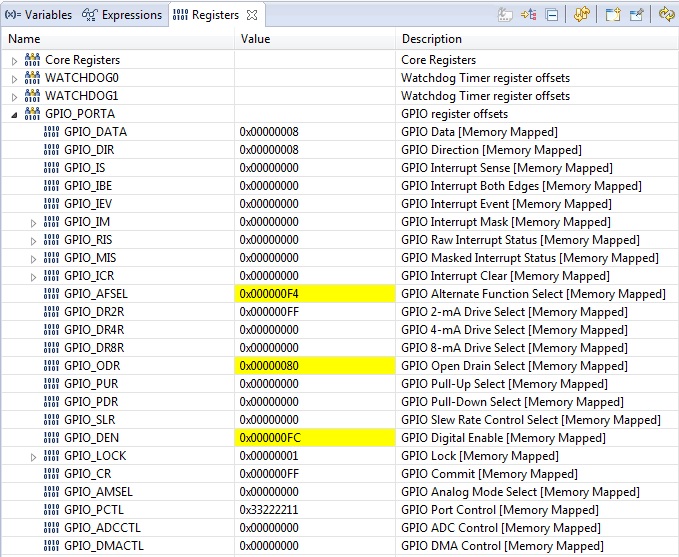

  • So I'm still working on this tonight, but I got some screen shots for you and a couple of things I noticed in doing this.  Attached are the screen shots the first one, "before.jpg", is the working version and "after.jpg" is where I add in those function calls and get a failure.
    Failure induced:
    My PORTA is configure ad follows.  Pins 0, 1 are unused, pin2 is the SSI_CLK, pin3 is a chip select for the SSI Port, but I control this manually as a digital output because I have to do block writes so this is a plain old digital output.  Pin4 and 5 are SSI RX and TX respectively and 6 and 7 are SCL and SDA respectively.  Just so you have an idea of whats going on with the overall port.  One of the things I thought was odd is that there is only one pin being configure as open drain and that is pin7 in GPIO_ODR register.  The other thing I thought was strange is that GPIO_DEN (digital function enable) is enabled for all of the pins except pins0 and 1 which I'm not using.
    Other than that the only change is the analog function select register (AFSEL) which (I think) makes sense because I'm not using anything on pins 0,1 and pin 3 is a digital output.
  • Hello Rob,
    The configuration is correct. The use of I2C is not affecting the configuration of the SSI in anyways. So technically it should not cause an issue.
    The GPIODEN is fine since pin-0 and 1 are not being used. Could you check on a scope what is happening when the failure does occur? That would shed some light to the issue. A good idea would be to get the waveforms when it is working and when it fails.
