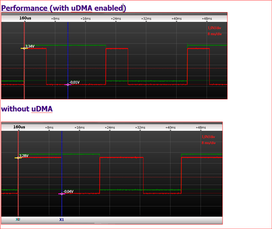

  • cb1_mobile said:
    Might you "sell" your request better - by documenting the "performance improvement" you note?
    Suspect this would raise interest - encourage response - as others would seek to similarly benefit.
    If selling is the thing, nothing better than an image, so I can show you the miracles of a uDMA transfer on a UART port against not using it.  As you can spot, the red line (CPU time busy between processing blocks) is shrunk by almost 50%, from a 12ms time period to a 6ms one.
    A precious time to accomplish the double of matters or just saving energy.
    So nice, I think I cannot live without it anymore!!!
