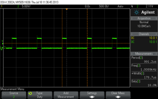

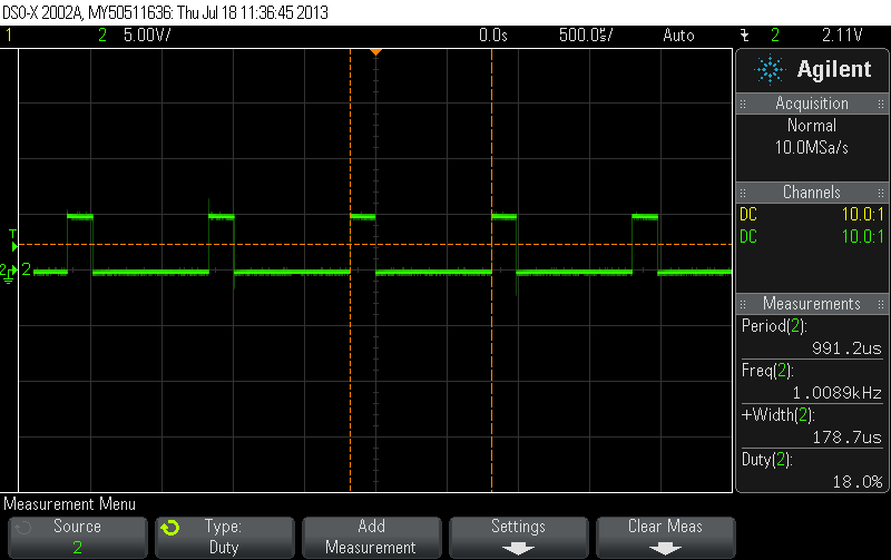

My aim on this thread is to measure duty cycle and width of an external PWM signal. I am developing on the LaunchPad with the now called TM4C1233H6. Workspace is IAR.
My PWM signal inputs to Timer2A via PF4 pin. Its typical width is 990us. The duty cycle can be as small as a 1us ON time (image below displays the signal at 18% duty cycle, with 178us ON time).
Timer2A is configured as half width (16bit), capture mode counting up (TIMER_CFG_SPLIT_PAIR|TIMER_CFG_A_CAP_TIME_UP), and the interrupt is enabled for BOTH_EDGES.
Measuring strategy is to read the TAR whenever it triggers a capture, and at the same time read the GPIO of PF4 to determine if the board was going up or down. The difference between two "going up" borders is the width, and the difference between "going down" minus "going up" is the proportional ON time. The reason why the full width is read, and not only assumed constant, is because the sensor that generates the signal is a little unstable, and can vary the full width by about 1%.
All working good so far, but on the edges of the sensor range, the 1us interval is too short to treat the interrupt routine and properly read the timers before the opposite border capture would happen.
So the idea is to DMA two values to a buffer area in memory: the Timer2A TAR register AND the GPIO F register at the moment of the border interrupt, so that the processor can deal with calculations later when there is free time. Because of the other processing tasks, I would like a buffer with some 16 readings of those two registers. The DMA transfer should circle back to the first address, after storing into location #16.

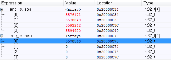

    Thanks! Well, something is not right. I guess it is time to paste a more detailed code so that you guys can take a look...
    The code is below. Please look at the print screen. The "something weird" result is that MOST of the times the value of enc_estado[0] is exactly the same as enc_pulsos[0], which is what I expect. But a few random times, enc_estado[0] records what seems to be the previous Timer Capture value, meaning the Timer DMA did not trigger at the same time as the IO DMA.
    Let me know if I can explain any further or test anything else. Otherwise, a suggestion as how to achieve this goal is most welcome!

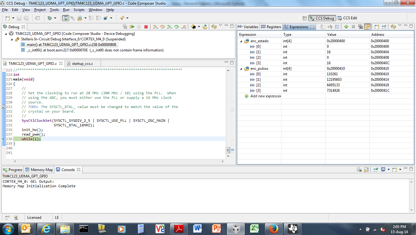

  • Hello Bruno,
    Since I did not have your full code, so I made some changes of my own the code post to get it work.
    I see that the values are always correct. You can diff the changes between your code and mine...
    http://e2e.ti.com/cfs-file.ashx/__key/communityserver-discussions-components-files/908/5850.TM4C123_5F00_UDMA_5F00_GPT_5F00_GPIO.7z
    Of course, couple of corrections as to the number of 32-bit words on GPIO Port F DMA request was set to 1, which I made as 4. The Interrupt Handler for GPIO and Timer does not disable the interrupt mechanism
    Amit

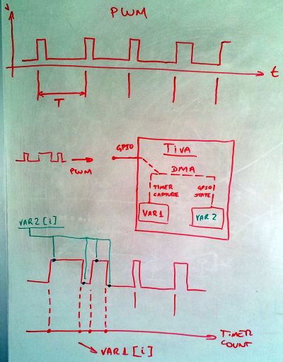

    The drawing below tries to illustrate the situation:
    The problem still is:
    - We would expect that VAR1 [1,2,3,4] be the real counter moments in which the borders were crossed: C1, C2, C3, C4; IN FACT, that is exactly what happens, and we read real counter values there.
    - we would expect VAR2 to be either 0,1,0,1 or 1,0,1,0. But it only reads 0,0,0,0 (yes, the edge is configured to BOTH)
    To further evaluate, we modified DMA settings on the GPIO border interrupt, to transfer the GPTMTAR register instead of the GPIO_BASE value. We see things like C1, C1, C2, C3, or maybe C1, C2, C2, C3 or even C?, C1, C1, C2...
    A second test was to transfer GPTMTAV. The results are even more confusing to be mentioned here... Hopefully you can think of something with the current information before we dump more writing...
    Bruno

    If I read the post correctly, then VAR1 is correct as per the crossing. Using the GPIO Port F DMA Request you read the GPIO Data Register at offset 0x3FC and instead of capturing the data as 0101 or 1010 it shows 0000?
    We have already established that the GPTMTAR in the code post I sent was working fine!!! It seems that the requirement also has changed...

  • Hello Bruno,
    Based on the requirements you have I had to make some changes to the code for detecting both edges. Please see attached project file (you can diff it against the last code). Also attached is the snapshot of the variables as seen in CCS.
    http://e2e.ti.com/cfs-file.ashx/__key/communityserver-discussions-components-files/908/4540.TM4C123_5F00_UDMA_5F00_GPT_5F00_GPIO.7z
    Amit
  • Hello Amit,
    Fantastic! This finally resulted in what we were looking for! Thank you very very much for the dedication.
    Now, if you could just add a comment as to wrap up the knowledge on this subject: what on Earth is that offset of 0x3FC about!? I did find such value on the "memory to memory DMA" chapter, but I had the impression that the GPIO would be "peripheral to memory". Is there a reason why the timer source is the direct register address, while the GPIO needs the offset?
    If and when you have time to enlighten us about it, I believe that other readers will benefit as well. But thank you again for the patience and help. Here's a small image showing our development "web".
