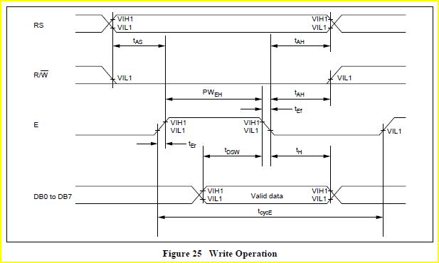

After I program the Stellaris Launchpad nothing happens to the LCD it doesn't get cleared. I have checked my pin connections of my Stellaris Launchpad to the LCD and  they are correct. Do you have any suggestions on how to make my code work.

    As the timing charts I past presented "http://e2e.ti.com/support/microcontrollers/c2000/f/171/p/210923/955141.aspx#955141" reveal:
    you must present data & RS first - with E held low.  Then - after E's hold time is met - you drive E high - maintaining data & RS stable @ original levels.  It's likely that you'll need some delay to insure that E's hold time is met.  And your code shows none!  Look here:

    GPIOPinWrite(GPIO_PORTE_BASE, GPIO_PIN_1 | GPIO_PIN_2, 0x00);  // Error!  E pulse may not meet PWEH (230nS)
    This construct must extend each/every time you "invoke" an E write.
    Note further - when you order E "low" - code shown impacts RS - too!  (of no consequence while in Command Mode (RS=0) but "deadly" when in Data Mode (RS=1).  E must toggle independently of all other bits - thus your code for E (rise or fall) must "strip out" any modification to RS....
    Suggest that you change the init to: 38, 38, 06, 0E, 01 - and provide 1mS delay between each.

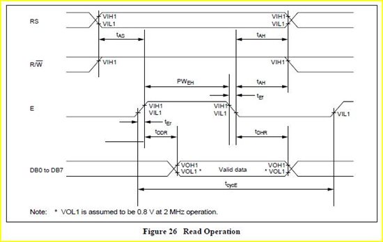

  • Key Specs/Timing for HD44780 Text Lcd Controller.  Please credit Hitachi.   (certain fields may be eased somewhat - newer controllers)
    Note: especially critical that timings: TAS (40nS), PWEH (230nS), TDSW (80nS), TAH & TH (10nS) be in compliance.  Common toggling of RS & E will violate!  {cb1}
    Read is not required.  (RW may tie to ground)  Read proves useful to minimize inter-character delays (via busy bit - D7) & when a display "dump" proves useful.  {cb1}

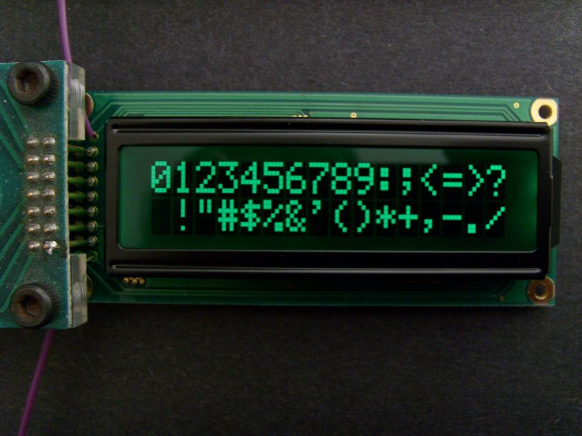

    To encourage your/others interest/persistence - below shines, "light from data-tunnel's end..."
    (early (unretouched) photo of one of our firm's Hi-Contrast, Extended Viewing Angle Text Lcd - accepts UART, I2C, SPI, CAN & up to 4x5 key matrix...)  Note Spring-loaded "data clip" massaged into use as "no solder/quick on/off" Test Clip...

     Update: (12:30 CST) just noted that you describe pin 3 (Vo) as ground.  Depending upon the Lcd - that may render the pixel field too dark.  (I know many do this - but they've not designed/sold 100K+ - use of a pot aids considerably - prevents waste...time/effort...)
  • Hello cb1, the LCD has finally worked. I took your advice and wrote a character on the LCD and it appeared. The pixel field was too dark, I connected the LCD back lights and the character appeared and I was able to see it. I will connect a pot to the LCD to brighten the pixel fields. Thank you for your help.
  • Good for you my friend - you worked hard & systematically - deserve congratulations.

  • As an early contributor to this thread - am concerned that this code:
    //Register Select(RS) = 1, Enable(E) = 1//
    GPIOPinWrite(GPIO_PORTA_BASE, GPIO_PIN_6 | GPIO_PIN_7, 0xC0);
    impacts both RS & E simultaneously.  Can't recall if I placed the HD44780 (copied by most clones) timing chart here - but there was an advisory to "not" drive both RS & E simultaneously.  Now it may be that this restriction "only applies" upon the "fall" of enable - it's been quite awhile since I've checked the spec.
    Also fear that "SysCtlDelay(2);" which shoots for ~230nS delay may be too short.  (i.e. larger value would be safer)
    Beware also that different MCU System Clocks will impact any/all delays which are so based.  (i.e. SysCtlDelay(x);)
    And - Mahmoud great that you took the reins on this one - true spirit of the forum...
