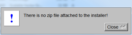

I am downloading TivaWare and am having problems installing it and I have tried on multiple computers.  The file I am getting is:
SW-TM4C-1.0.exe, 82.8 MB (86,884,352 bytes), MD5 71434e3b156ec0d0ae1f588ad72306bb
When I try to install I am getting the following error:
Can anyone else reproduce this?  Can someone at TI post a new file?
Shawn
    The SW-TM4C-1.0.exe I had successfully installed from is of size 86898676 bytes with MD5 d44e48b29ba093b46759961003777f45. i.e. appears your downloaded SW-TM4C-1.0.exe has been truncated / corrupted in some way.
    Downloaded SW-TM4C-1.0.exe again, and got exactly the same file as had previously installed from.
  • Chester,
    Thank you for the feedback.  I am currently looking to see if the zip file is getting stripped from the executable by the firewall we have here at work.
    Shawn
