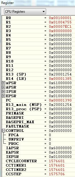

    Note: above shows the "burden" caused by, "SysCtlClockSet()."  That was 1st function call post Reset - CycleCounters (all shown) reported 895 prior to executing that SysCtl.  "CCStep" shows the impact of SysCtlClockSet() when employing PLL & Main Osc...  (this function shows some slight variation - run to run - thus the 1 cycle deviation appearing below...)
    In contrast, "ROM_SysCtlPeripheralEnable()" executed in just 32 cycles...  CCStep saves so much time/effort...
    BTW - "Cycle Counter" reveals both w/in "CPU Registers" (shown here) and "Current CPU Registers."  Have you tried both?
