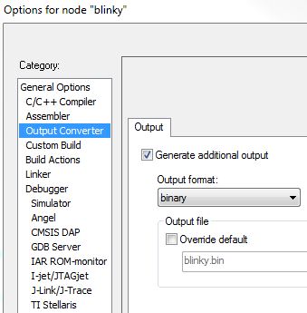

    W/in IAR - Under Project > Options > Output Converter...
    Beyond requested binary - Motorola, Intel Extended, and Simple (don't ask) are offered.  (via listbox)
    Note that both J-Link and TI Stellaris may serve as delivery vehicles...

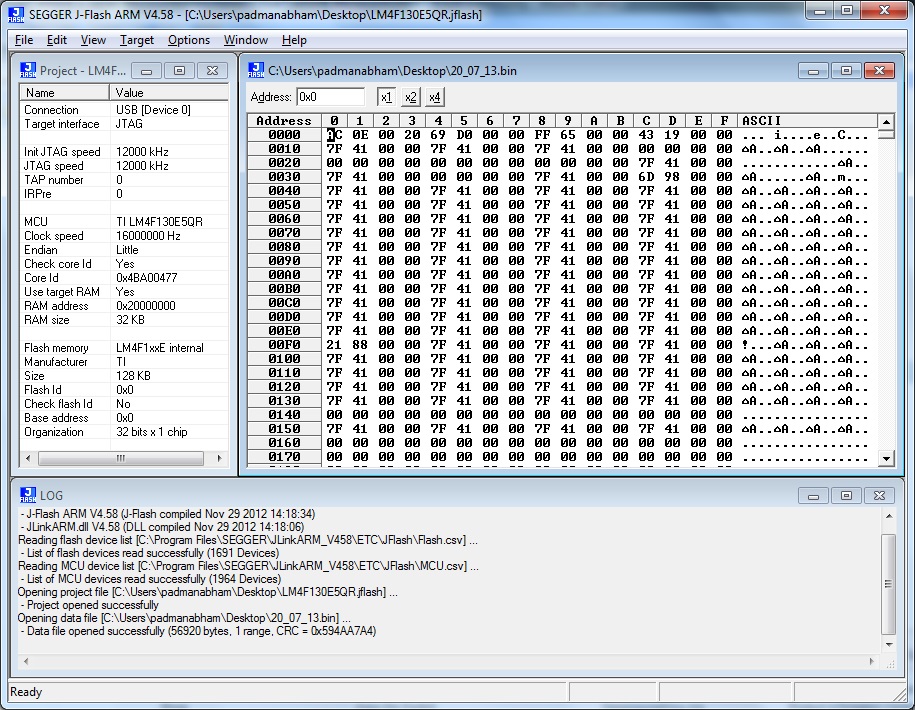

    I have done Programming through Jlink
    Below is snap, and attached is .jflash file
      AppVersion = 45800

    remove .txt extension to use with Segger J-Flash
    Paddy
  • Your method will work - but is far from quick/efficient/seamless.
    Should IAR be available/in use @ customer site - the process you requested is "automatic" - and enables quick/eased/on-site source code updates.
    IAR usage (as earlier post high-lighted) requires no other program or file modification to flash code into the MCU.  (but does require the presence of source code)
    While your opening post did not so state - should customer not have IAR/use experience - or should you/your group be supplying private "code" (non-source) - the method you outline  should work providing customer properly powers/connects target board & has suitable J-Link drivers installed...
    Proper board handling procedures - with emphasis upon ESD safeguards - should also be included with code delivery...
