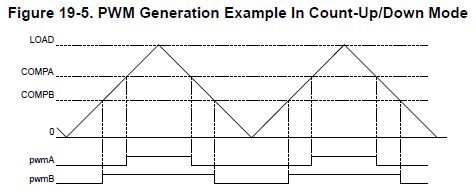

    Several things to consider - but first, (this from our LX4F manual - applies equally - your MCU...)
    "Generally, Count-Down mode is used for generating left- or right-aligned PWM signals, while the Count-Up/Down mode is used for generating center-aligned PWM signals."   Thus - it is possible - what you are reporting is normal.  Diagram further illustrates (same source)
    Issue here is (I believe), "has your observation properly considered this center alignment (and sync) between PWM Generators?"  Note - in the diagram above - the 2 PWM outputs are "sync'ed to center" - not edge!
    Quick/simple test to evaluate "sync" - switch to "down" mode rather than up/down.  Edge alignment (far easier to detect/measure) results...

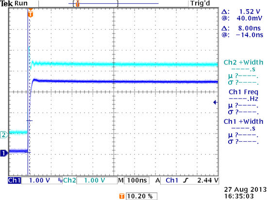

  • Hello again, John,
    In the interest of completeness - and in defense of StellarisWare's creation of, "SYNC vs NO_SYNC" - as regards PWM outputs across different PWM Generators - I have gathered pertinent scope traces which - I believe - support the use of SYNC to insure synchronization across different generators.   Will present here in the next few minutes...
    I offer this as constructive input - my contribution to an area which I sense many will find of importance.  As always - whenever factory personnel can find the time to contribute - such is always most welcome.  Here then - my findings:

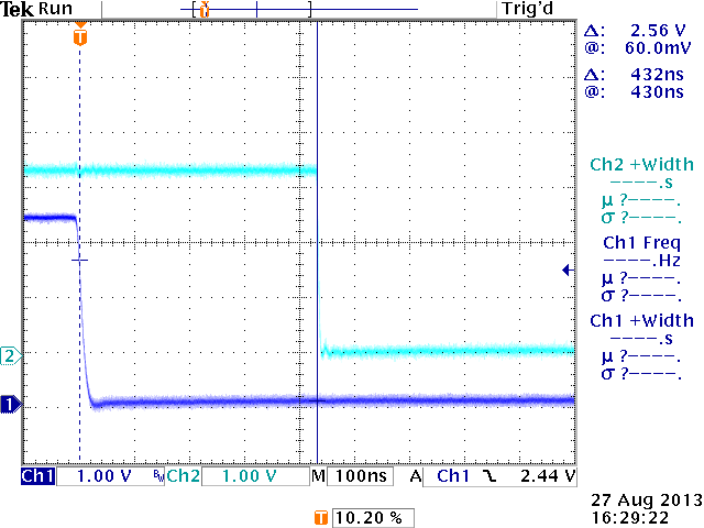

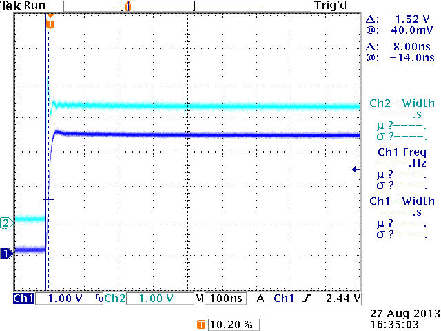

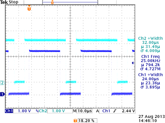

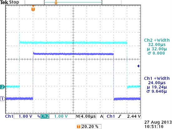

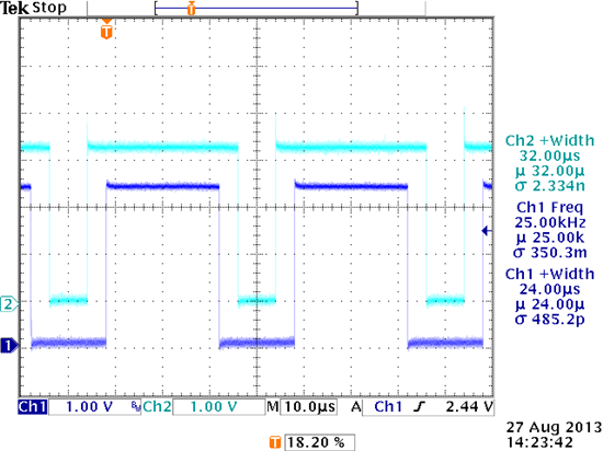

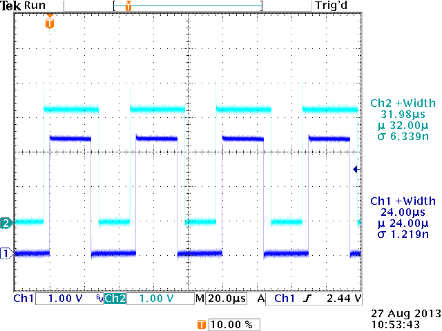

    Here - what I believe to be, "Sync'ed PWM Generators" (Gen 0 & Gen 2, PB6, PG4, here).  Note that this was achieved via, "PWM_GEN_MODE_GEN_SYNC_LOCAL" as param. w/in, "PWMGenConfigure()."  In addition - calls were subsequently made both to: "PWMSyncTimeBase()" and "PWMSyncUpdate()."  Kindly observe that both PWM outputs are precisely aligned about the PWM counter's center - expected when using "PWM_GEN_MODE_UP_DOWN" as active parameter.

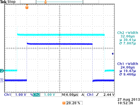

    And below - I monitored the same 2 PWM outputs - but after removing the call to, "PWMSyncTimeBase()."  Note that we've lost the "center sync."  Not horrendous - but does not meet, "normal/customary" definition of, "Sync!"
    And - I show here the same signals under wider time-scale.  Bit harder to note here - but the same Sync Loss reveals.
    Thus it appears that my earlier challenge of, "SYNC" not meaning, "NO_SYNC" - of course counter-intuitive - may be in this case, correct.  And for that - I/others am glad!  Words - even MCU functions - do have meaning - and to reject the obvious may not be especially, "STELLAR!"  (disturbed that you ignored my earlier/obvious protest...)
    This work done under StellarisWare 9453 - LX4F231 MCU - custom board - Scope Tek: TDS3054B.  PWM @ 20KHz.

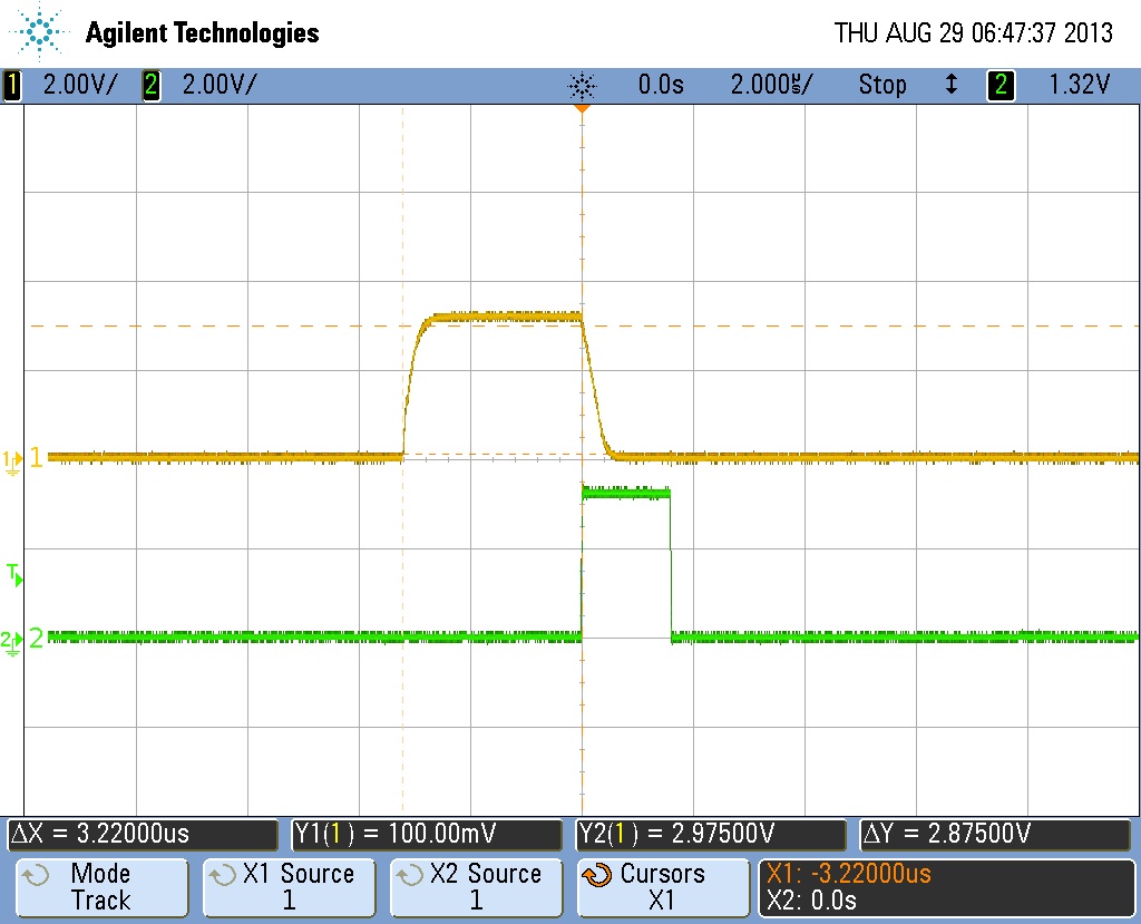

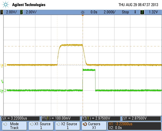

    To confirm - made the effort to change the PWM frequency (seek to eliminate single freq. anomaly).  Now @ 25KHz - scope reveals:
    Capture results from, "NO_SYNC" param. w/in PWMGenConfigure() but only after subsequent call to, PWMSyncTimeBase().   Note that vendor's code example earlier provided (multiple_pwm.c) - made no such call to PWMSyncTimeBase().  My findings - PWMSyncTimeBase() very much required to SYNC!
     Now - without call to, "PWMSyncTimeBase()" (yet still employing "NO_SYNC") - Ch2 shifts right - sync lost!

    However - PWMSyncTimeBase() always is required

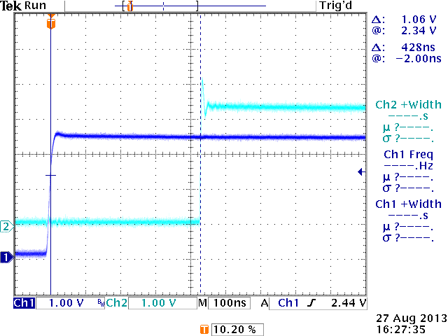

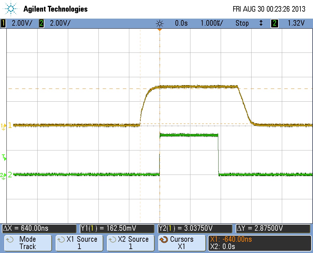

    As support - here leading edge of both PWM Channels - but w/out call to "PWMSyncTimeBase()."  No chance that these signals are "sync'ed" - even though both have identical freq, period & pulse width. (Note: pwm width was adjusted to be identical here - so that the "edges" of "Sync'ed" PWM Generators could be properly examined.  This was not done in earlier captures - as different pulse widths were employed so that predicted channel overlap would not mask results.)
    And - trailing edge of same signals - same conditions as above...  Sync again absent...
    And now - identical set-up - but after call to, "PWMSyncTimeBase()."  And - this is as expected... "SYNC!"
    Facts in evidence seem overwhelming - favor the requirement for, "PWMSyncTimeBase()'s" presence - when synchronization across multiple PWM Generators is desired...  (trailing edges indeed mirror this behavior)   Q.E.D.

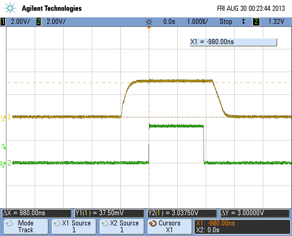

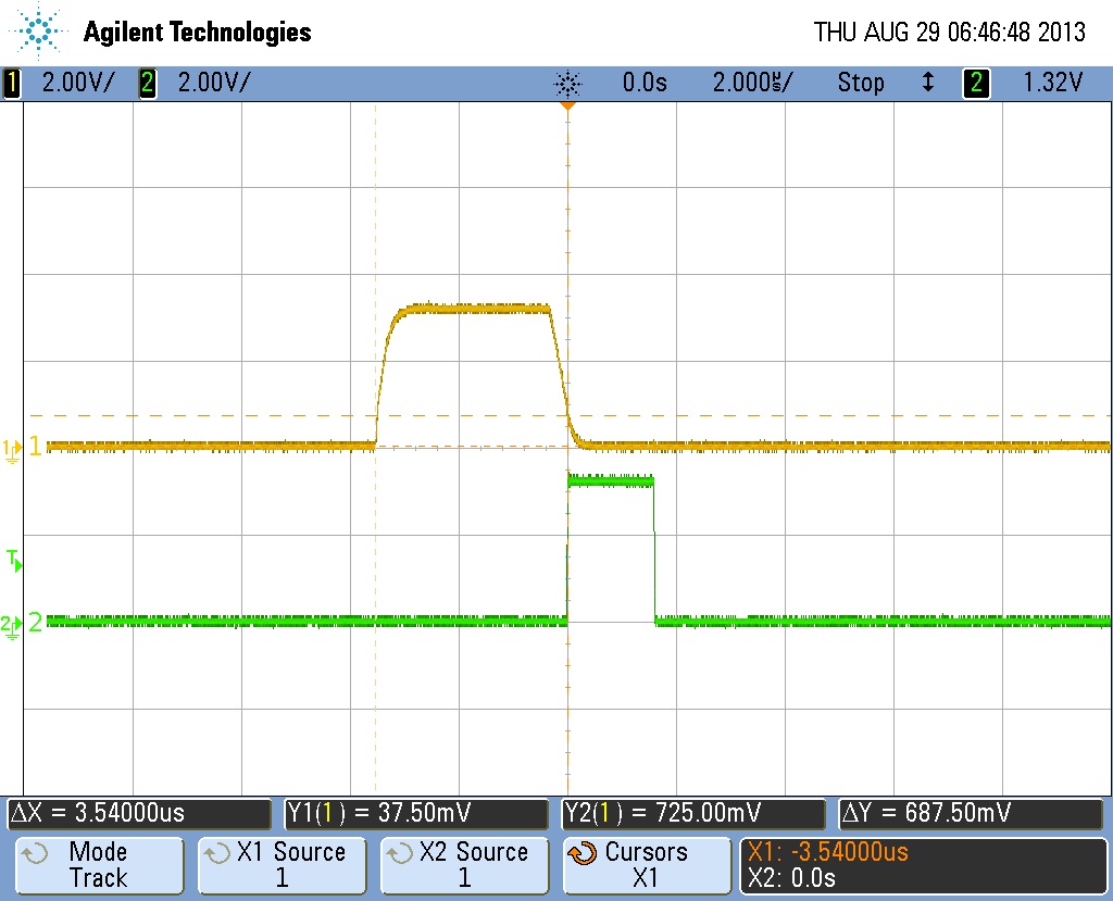

  • My case is that PWMSyncTimeBase did syncrhonize two PWMs but the phase has 1 to 4 PWM clock cycles. I set the PWM clock divide by SYSCTL_PWMDIV_16. 320ns per PWM clock. The phase variation is 0 to +/- 1.2us.  I will create a standaonly project to share with you to repeat the issue which I had.
  • In addition - and as always - some mention of MCU in question, Software in use (w/ver number) and - if possible - scope caps similar to those shown.  Does this happen on more than one board - and one MCU?  (my tests - yesterday - ran over 2 different boards - both M3 (may they rest in peace) and M4.
  • Hi again Eric and cb1 -
    After spending some time looking at my code, I moved the location of the call to PWMSyncTimebase to after the PWMGenEnable function calls, and this, along with using LOCAL instead of GLOBAL, seems to work.  I was able to duplicate cb1's results with no problems.  Source file is attached.  It seems that the order that the functions are called in makes a difference in the sync operation.
    Eric, give this a try and see what you get.  It's virtually the same as yours, except I inserted the delay as cb1 did to force out of sync operation so I could test it.
    JW
  • Hi John,
    Good - glad that you persisted and achieved success.
    Really do believe that the "rapid fire calls" to, "PWMGenEnable()" - combined w/your likely SystemClock @ 80MHz - led you down that early trail.

    Measurement results:
    I measured the outputs at different PWM on time; we can see the phase between different PWM are shifted.
    PWMSyncTimeBase is called before and after the PWM is enabled.
  • @Eric,
    Plot thickens - yours do not much resemble my PWM traces - and do not look like "normal/customary" PWM waveforms to me, either.
    And - after quick review of your code - believe I know why:
    See no calls whatsoever to: "PWMGenPeriodSet()" nor to:"PWMPulseWidthSet()" - are not both required? (both indeed appear - each/every PWM example provided w/in StellarisWare...)
    Note further that you freely mix use of PB6 & PC4 - both as GPIO Output triggers & later as "suspect" PWM outputs - but that PWM function seems most unlikely without the critical function calls - as I list above.
    Thus - your issue appears not to be one of Sync - instead one of proper set-up & config of each PWM Generator.  And of course this must occur prior to any attempt to, Sync!

  • 4382.pwm_test2.zip
    In order that we talk in the same way, I modified the code with library function only. The period and width are set with PWMGenPeriodSet and PWMPulseWidthSet.
    PWM cycle = 320ns; C_TRIGGER: width = 10 PWM cycles; L_TRIGGER width = 6 PWM cycles. I made the PWM operated at UP_DOWN mode which similiar to your example.
    From calculation, the distance between two rising edge shall be 2 PWM cycles; 640ns. The measurement showed that the distance is at 960ns mostly; occasionaly it is back to 640ns. Whatever the hardware does, it shall be consistant in one way or the other. The PWM width are always correct (C_TRIGGER 10 PWM cycles, L_TRIGGER 6 PWM cycles).
    I suspect TI PWM implementation has hardware bug; or my lib function calling sequence is incorrect.
    For many of your case, you may choose divide by 1, so you will notice 1 PWM clock shift. Our project does care 1 PWM clock.

  • In up down count mode the pwm will sync at the center. And what cb1 has posted shows same result if I'm not mistaken and are perfectly synchronized.
