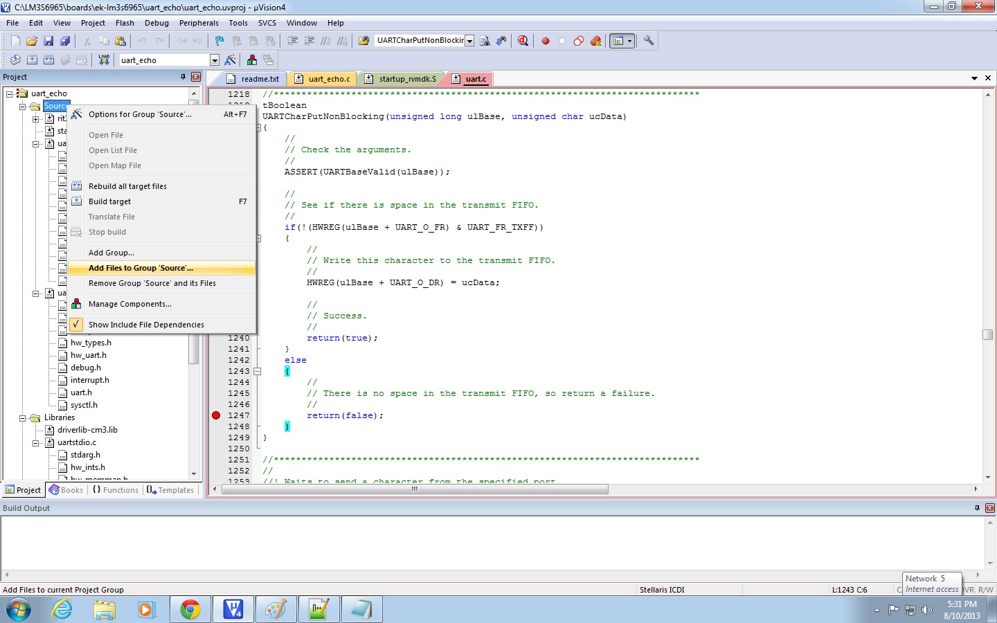

         I think that is because, there is no more space in the transmit FIFO. Transmit FIFO is limited to 16 bytes. You can verify this by putting a breakpoint at "else" part of UARTCharPutNonBlocking().Then run the program in debug mode while viewing the characters printed out at your serial console.

  • Hi Lee,
    Lee Noack said:
    I'm not sure how to access the ROM_UARTCharPutNonBlocking() function
    You need to add uart.c to your project, like this below using Keil Uvision.

  • The cause of the problem is UARTCharPutNonBlocking(), which is called in UARTSend(). See partial description below.
    //! This function writes the character \e ucData to the transmit FIFO for the
    //! specified port. This function does not block, so if there is no space
    //! available, then a \b false is returned and the application must retry the
    //! function later.
    -kel
