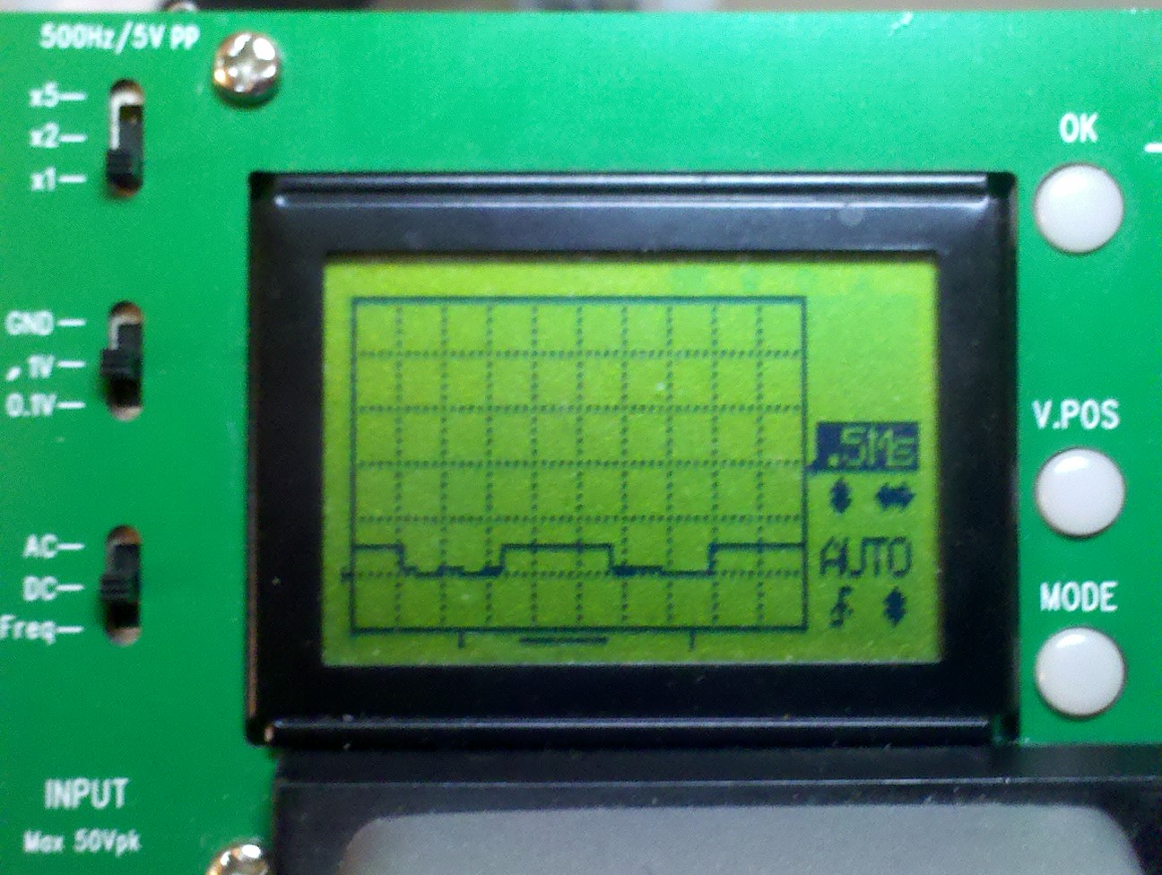

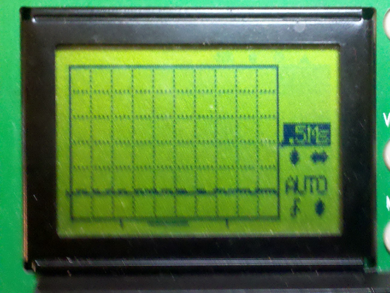

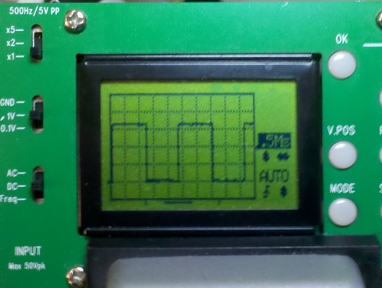

I'm having problems with both a EK-LM4F120XL and EK-TMC123GXL LaunchPads with a BOOSTXL-SENSHUB Sensor Hub BoosterPack and CC3000EM - CC3000 Evaluation Module.  Are these a supported configurations? The BOOSTXL-SENSHUB Sensor Hub applications seem to work OK except for the airmouse.  I'm trying to get the Basic Wifi Application working with the CC3000EM and I was getting spurious interrupts from the WL_SPI_IRQ/RF_GPIO1 line . I'd like to have a copy of the Sensor Hub BoosterPack PCB layout and can't find it.  It looks like the RF_GPIO1 (PE2) and RF_GPIO2 (PE3) are getting shorted out to something else on the BOOSTXL-SENSHUB board even without the CC3000EM present. I don't see anything on the schematic that should be affecting this. I'm using a modified version of the blinky example to pulse the PE2 output as a test.  Without the BOOSTXL-SENSHUB installed the PE2 output (Image #1) and PE3 input (Image #2) look normal and are shown below.  With the BOOSTXL-SENSHUB installed they both PE2 and PE3 look like the third (Image #3).
Image #1 PE2 output  EK-LM4F120XL only.
Image #2 PE3 input EK-LM4F120XL only.
Image #3 PE3 output EK-LM4F120XL with BOOSTXL-SENSHUB installed, PE3 input is identical.
