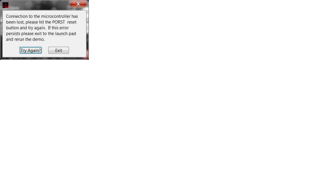

We have bought the TMS570 HDK and I'm trying to run the safety demo software. It says it has installed ok. There then comes a dialogue box with some text obscured...
So I pressed PORRST and clicked OK. I then selected the Ambient Light app (although it fails on all) and the next thing I get is this...
I press PORRST again and all that happens is this dialogue comes up again. I cannot get past this point. Was I meant to do something more than just push PORRST in the first dialogue?

  • Hi Paul,
    by accident I pushed the PORRST 3 or 4 times in succession, then it started to work. So, at least I now know the hardware is working.

  • Hi Andy,
    Pushing PORRST one time is enough. Can you please tell me the version of your demo code, I will do the same test on my bench? Please download the latest CCS from http://processors.wiki.ti.com/index.php/Download_CCS.

  • hi Andy,
       U need to run code through CCS5. HDK doesn't support lower version of CCS.
