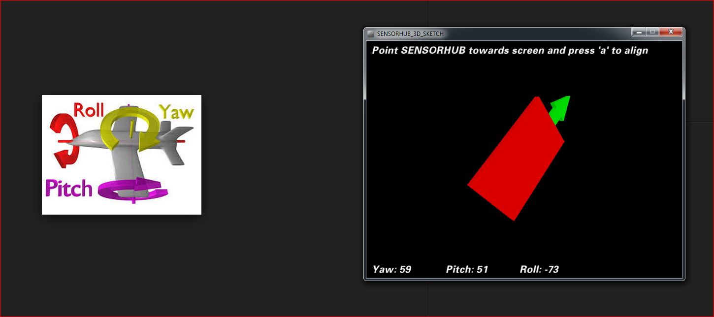

Hello all.
I have started to play with my recently arrived BOOSTXL-SENSHUB,I have been running the examples and trying to understand the data that the 9-axis Motion Sensor MPU-9150 provides.
In specific I have been using the airmouse example and the compdcm_mpu9150 example. Both are a great way to get the data but I find it not very intuitive for a fresh starter.
So, I decided to get some info and stuck some Processing sketches and try to build a simple AHRS ( http://en.wikipedia.org/wiki/Attitude_and_heading_reference_system ) for the Sensor Hub and sharing it.
The result is something like this:
Thanks to the decision of TI of not supporting this device and my effort + time....I decided to not provide that information in this forum.

    I realized that Roll and Pitch data are ok. The problem comes with the Yaw axis.... any idea??
  • My Yaw only varies over about 15-20% of the range and is sinusoidal rather that linear over the range.  I have a rotary platform with protractor that I use for calibration. Did you or anyone ever have any luck with theirs?

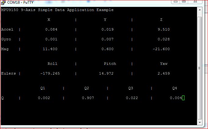

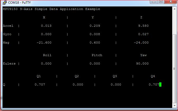

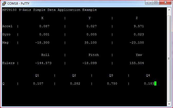

    - If I let the sensor stand on a flat surface finding the 0 of yaw:
    - If I  put the sensor standing on a flat surface, pointing the X axis to the screen:
    - If I  put the sensor standing on a flat surface, pointing the Y axis to the screen:
    - If I  put the sensor standing on a flat surface, pointing the Z axis to the screen and X to the floor:
    - If I  put the sensor standing on a flat surface, pointing the Z axis to the screen and Y to the ceiling!!:
    I haven't changed weights or any other data (as you said in the invensense forum thread).

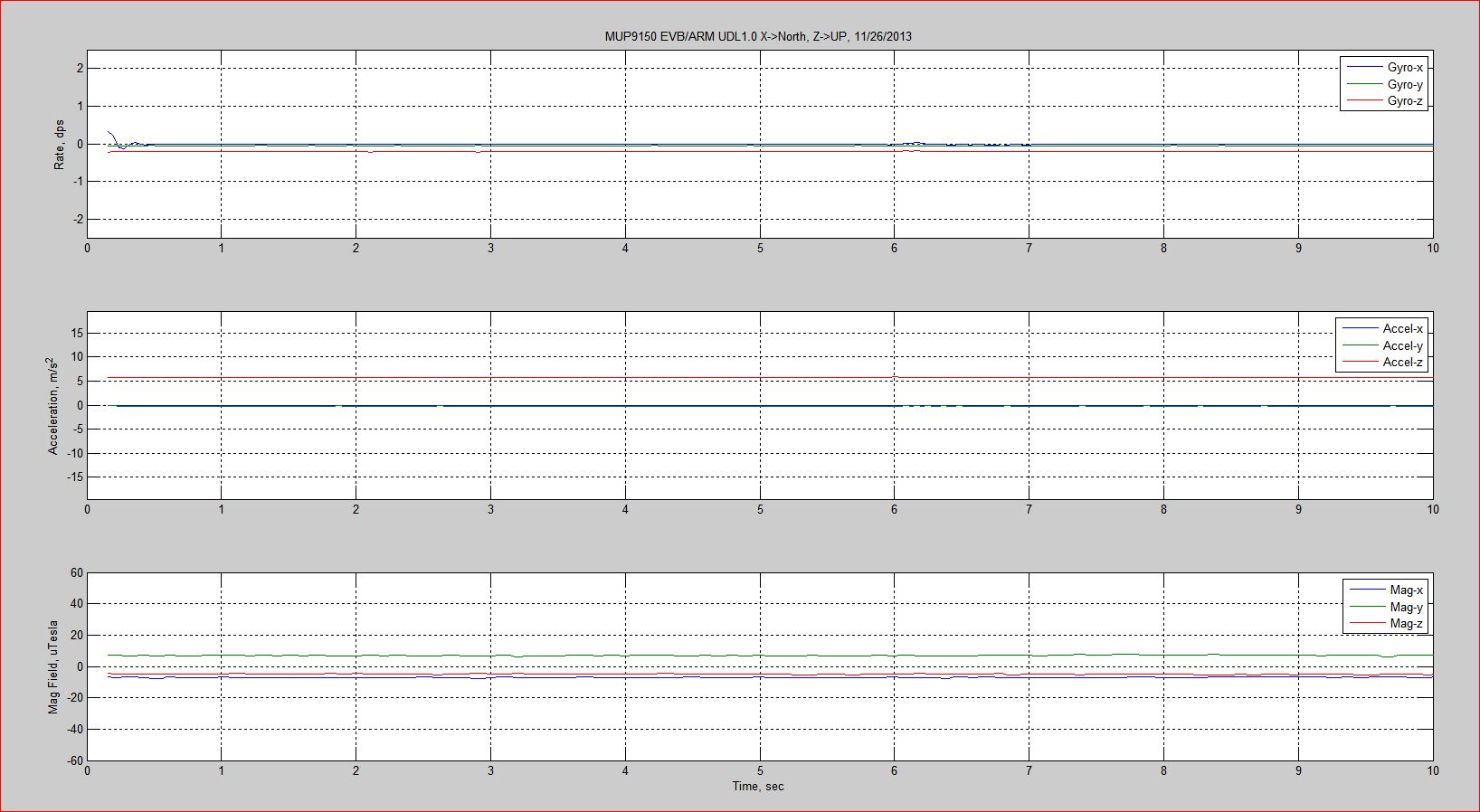

  • You are correct. I meant to paste in the same code correction for CompDCMUpdate() as well as CompDCMStart. It is important that both be updated.
    Thanks for the measurements with non-zero gyro weighting. I will review and get back to you. There is the issue of magnetometer hard and soft iron calibration and practical performance of this type of algorithm with dynamics and gyro updating. One step at a time is desirable.
    Meanwhile to help build confidence see if your static hardware results with zero gyro weighting lock to the following code test result. (Your screen format has the information needed; try to arrange (or else force) similar magnetometer(X,Y) and accel Z values. Repeat the Yaw zero case if needed to get oriented.)
    Forced raw sensor values:
    Psi, theta, phi(deg):  90 , 0 , 0  CCW rotation about aircraft yaw axis
    Mag   (tesla):  [0.0, -3e-05, 5e-05]  Earth field in body after yaw rotation, Psi
    Accel (m/s^2):  [0.0, 0.0, -9.8]  Raw accel output in level flight
    fDeltaT=0.02;pfScaleA=0.5;pfScaleM=0.5;pfScaleG=0;
    After executiion of CompDCMInit,CompDCMStart,CompDCMUpdate:
    DCM:
    [0.000, -1.000, 0.000]
    [1.000, 0.000, -0.000]
    [0.000, 0.000, 1.000]

  • Thanks again Anthony, outstanding work here.
    Anthony Challoner said:
    1) .... So to answer PakSy , the last screen shot was great but the gyro output should be 0 not 90.
    Then, why I am seing 90 degrees. Am I doing something wrong?
    4)  ... Unfortunately the 16-bit MPS430 is firm-coded and the limited CCS demo version I have is only good for viewing code. The 32-bit SensorHub and TI library certainly looks much more attractive for AHRS or navigation development.
    CCS is free for Tiva 123X devices so you can get inside the issue easily.
    I would like Texas to consider give a free Sensor Hub BoosterPack and Tiva™ C Series TM4C123G LaunchPad Bundle  to this man, for the work and results he is achieving. Probably he will save some good work to TI engineers.
    https://estore.ti.com/Sensor-Hub-BoosterPack-and-Tiva-C-Series-TM4C123G-LaunchPad-Bundle-P4538.aspx
    If TI doesn't, I would not mind to create a paypal donation and contribute to buy you one bundle.
  • Aha. So it wasn't your  finger on the 90 deg gyro display !  As I said I want to investigate your results further.
    Thanks for the suggestions. This TI plane would  likely get to its destination sooner if I could also be on board!  And there are a lot more places I we could visit from there !
  • Well, well. It seems that in the TI code (not my Python translation) pfData and the Euler and Quaternions printout is not updated by the DCM algorithm as I had thought. Yet the Eulers and Quaternions are computed from the DCM algorithm and that is what I print out. So in the screen print I believe you are getting the Eulers and Quaternions computed on board the InvenSense MPU9150 ? A bit confusing to say the least. Now I have to wonder what is driving your displays.[Late note: This understanding is wrong. pfData, pfAccel,...pfQuaternion should be the same data and this Tiva code is not accessing on-chip Quaternions]
    So when you set pfData[0]=90 in the main loop of  3264_compdcm... it stuck through to the printout. And when you update the sensors it overwrites the earlier values prescribed by you.[Need to review this explanation]
    If in fact you are getting screen prints of raw MPU9150 data that will aid in the individual sensor checkout for both polarity and noise. With the SensorHub sitting upside down with say accel/gyro X axis pointing north (level flight, yaw 0)could someone write about 10 minutes of data to file instead of to screen along with a time stamp and post. I will do the same with my SDK and EVB MPU9150.[Done & posted below for EVB/SDK, awiating Tiva report. Need to find a point in the Tiva stream where accel, gyro and mag data is stable and understandable for a fixed hub orientation]
  • For reference here are results for an MPU9150EVB/ARM. I aligned X with North using a wall reference but didn't think and left the Z axis pointing up instead of down. (Air mouse configuration, I guess). The mean values of the data were put into my Python SensorHub code translation and it reported the airplane had been rotated 130deg in Yaw a small few degrees in Pitch and a complete 180 deg in Roll. I also re-ran the calculation with the magnetometer axes re-aligned per spec and only the Yaw was changed by 90 deg to 320 deg. All was as expected except for the large Yaw error since I believe Google knows North better than the magnetometer. Was there 60 degrees of iron pulling on magnetometer--maybe. Moving it to the middle of the room will be the next experiment.
    In summary there is certainly no basis for attitude oscillation in this raw data. In fact the 0.7uTesla deviation of the accelerometer data is equivalent to <2 deg variation. (std(m)./|mean(m)|*pi/180=[1.9, 1.7, 1.3] deg)
    What are you seeing in the raw data collected by the SensorHub in same orientation, pfData written to file ?
    Note: MPU9150 registers were configured for 20Hz sampling, 10Hz DLPF, 250dps/2g full scale gyro/accel.

  • A follow up to my last post.
    Here is the image of the MPU9150 EVB data plots that didn't make it in inline. (also included in pdf in previous post zip file)
    7367.MPU9150EVB.pdf (still didn't make it inline?)
    I also checked out my SDKMPU9150 and found it in closer alignment with North. My guess is that it has been and continues to calibrate for hard and soft iron distortions -- and that should also be done by Sensor Hub code. Here are python calcs for the magnetometer and accel data before and after I did a "figure 8" tumble to map the local magnetic fields. Both cases are closer to North than the uncalibrated EVB and there was a change in magnitude but not a large change in yaw direction after calibration. I am not as confident in the North alignment for the SDK measurements so can't be sure which case was closer to truth. Again, however, there was no oscillatory motion or significant noise in either case for either the raw data or Pygame cube display.....
    Let me know what raw data (write pfData values to file; ignore cube display) you find for similar static SensorHub case.This will help box in the source of errors.
    Hi again Anthony, I am checking your data to prepare a program for Tiva.
    What do you exactly need? What is the variable you have called Temp?
    What are the units of time and temp?
    Thank you.

  • I also made some captures in video of the board with the sensorhub attached and the capture of the screen.
    The values are printed in the screen as well.
    -Sketch feed from Eulers(you can spot the oscillations at beggining):
    http://www.youtube.com/watch?v=ptL9xn5-64g
    - Sketch with Yaw=0 (in the sketch)
    http://www.youtube.com/watch?v=cffbjZ3akL8
    - Sketch with Yaw=0 and  Pitch=0 (just Roll)
    http://www.youtube.com/watch?v=CLeRfN58rcY
    - Sketch with Yaw=0 and  Roll=0 (just Pitch)
    http://www.youtube.com/watch?v=9cPk4pFKgws
    AS you can see, both axis make both Pitch and Roll vary.
