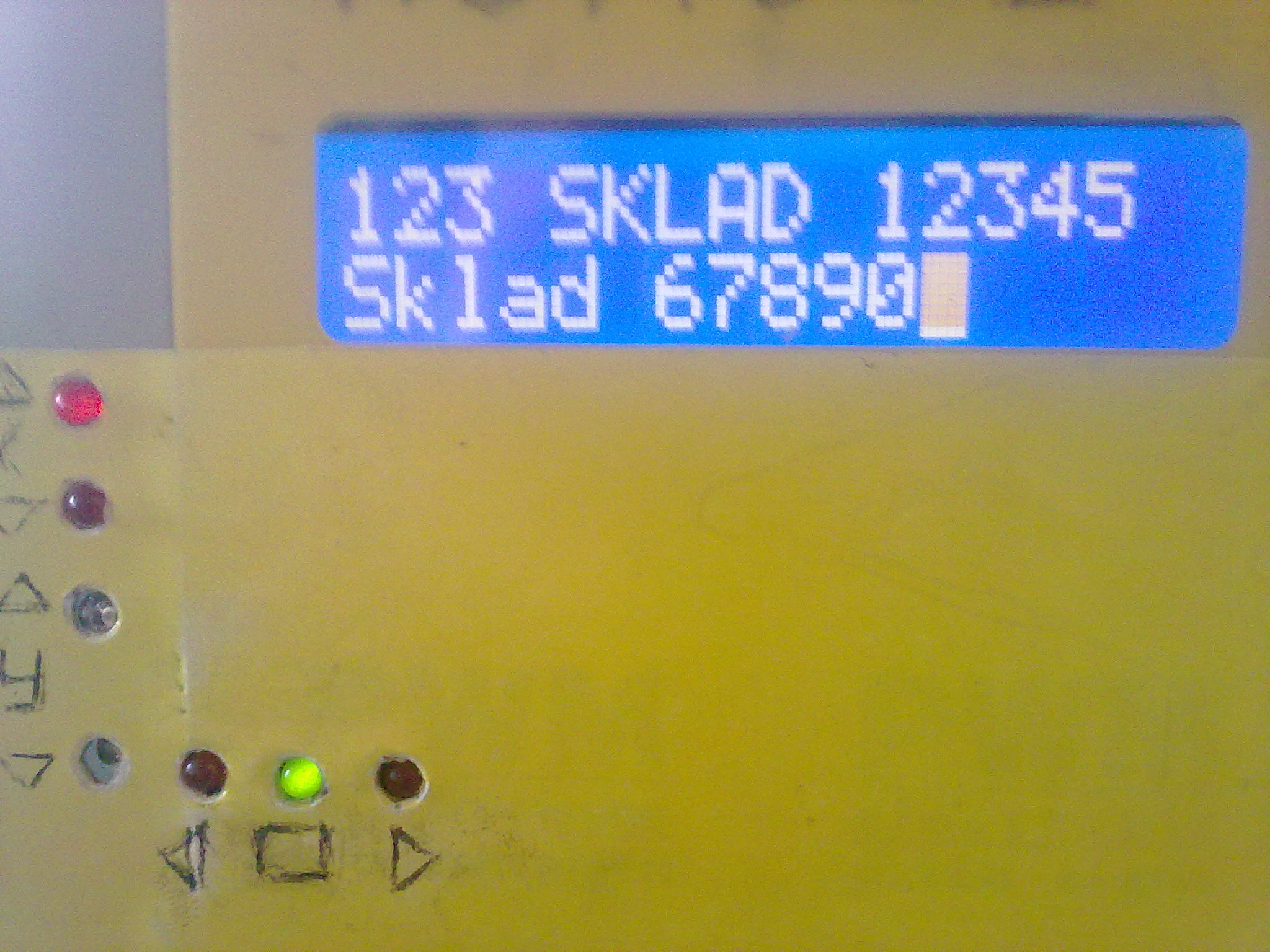

problem with lcd WH1602D and lm3s6965
why lcd works through time or not working at all?
i am using next schems
PE.0(72)->DB4(11)
PE.1(73)->DB5(12)
PE.2(74)->DB6(13)
PE.3(75)->DB7(14)
PB.0(66)->E(6)
PB.1(67)->RS(4)
GND->RW(5)

  • Hi Dave!

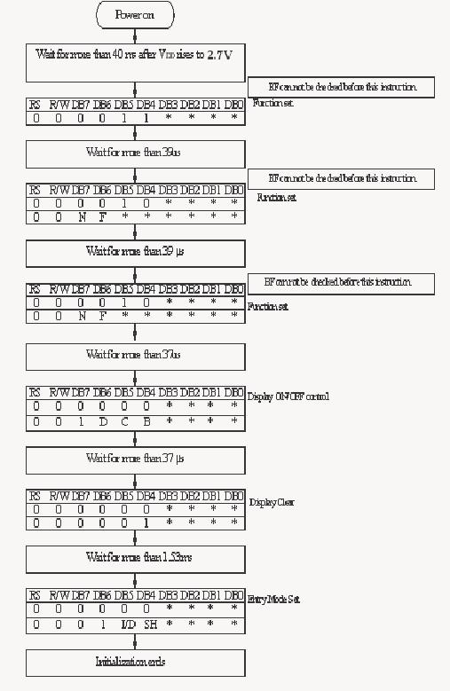

    I'm using lcd WH1602D-TMI-CT (winstar)
    in the datasheet there is an algorithm for a 4 bit interface
    When I program the controller the first time I get the following items
    I program this code again and get the good  finished result
    if you flash a third time, then like firsrt result
    fourth normally again.
    after first turning off
    the controller
    ps im my last code i change some output chars
    flashing by j-link jtag

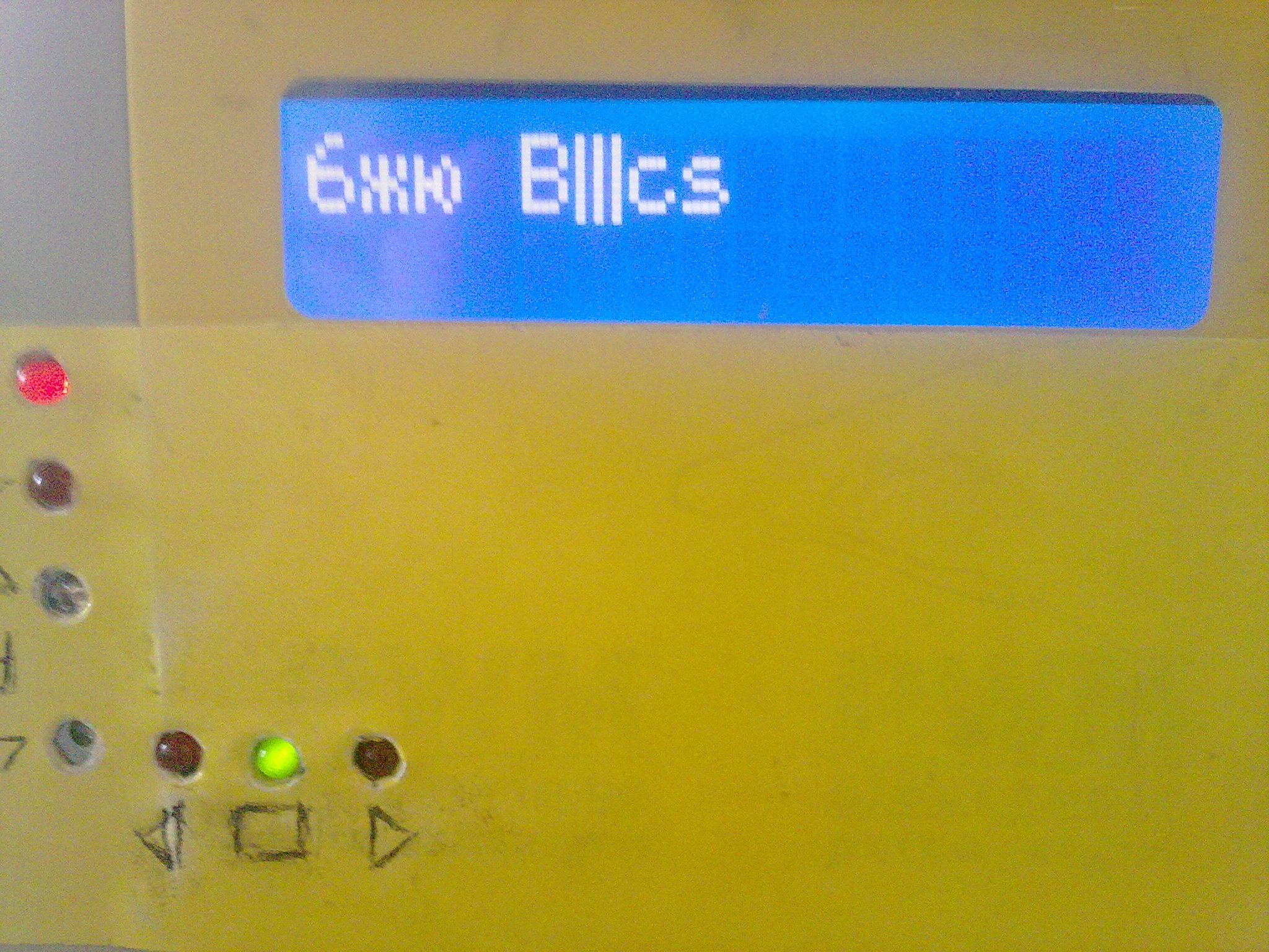

  • If it's working every second time, I would look at the code that initializes the display. Likely there is something wrong in there but the problem is being corrected later so that, the next time you run it, the display looks correct (I assume the second picture shows what you expect?).
    It's normally a good idea to reset the display completely during initialization so that you know that all its internal register are in their default states. Does this display have a reset signal and, if so, is it connected on your board?
  • display don't have reset signal,
    am curious why it works the second time programming, and does not work the first or the third or the fifth, etc.
    after the power switch and can see that the display is initialized
    shows two rows but the command 'clear' 0x01 is not performed as following command
      probably somewhere stray nibbles
  • Thanks for the advice, the display started to work in normal mode after initialization been spending twice, the following is a corrected code  that can be useful to someone

    int LCD_Init(void)
        GPIODirModeSet(GPIO_PORTE_BASE, GPIO_PIN_0 | GPIO_PIN_1 | GPIO_PIN_2 | GPIO_PIN_3, GPIO_DIR_MODE_OUT);
        GPIOPadConfigSet(GPIO_PORTE_BASE, 0x0F, GPIO_STRENGTH_2MA, GPIO_PIN_TYPE_STD_WPU);
        GPIODirModeSet(GPIO_PORTB_BASE, GPIO_PIN_0 | GPIO_PIN_1 , GPIO_DIR_MODE_OUT);
        GPIOPadConfigSet(GPIO_PORTB_BASE, 0x03, GPIO_STRENGTH_2MA, GPIO_PIN_TYPE_STD_WPU);
        SysCtlDelay(1000000);
       // LCD_COMMAND (0x03);    // LCD display
    		 RS_LO;
         EN_HI;
    		 GPIOPinWrite(GPIO_PORTE_BASE, GPIO_PIN_0 | GPIO_PIN_1 | GPIO_PIN_2 | GPIO_PIN_3, 0x03);
    	   delay_lcd();
    	 	 EN_LO;
        LCD_COMMAND (0x28);    // LCD display
        delay_lcd();
        delay_lcd();
        LCD_COMMAND (0x0f);    // LCD display
        delay_lcd();
        LCD_COMMAND (0x01);    // LCD display
        LCD_COMMAND (0x06);    // LCD display
    		 delay_lcd();
    	 return 0;
    }    // End int LCD_Init

    		LED_ON ;
    		LCD_Init(); LCD_Init();//init twice
                    LED_OFF;
    			   LCD_DATA(' ');
    			 	 LCD_DATA('S');
    				 LCD_DATA('K');
    				 LCD_DATA('L');
    				 LCD_DATA('A');
    				 LCD_DATA('D');
    				 LCD_DATA(' ');
    				 LCD_DATA('1');
    				 LCD_DATA('2');
    				 LCD_DATA('3');
    				 LCD_DATA('4');
    				 LCD_DATA('5');
    				 LCD_DATA(' ');
    				LCD_COMMAND(0xC0);
    				 LCD_DATA('S');
    				 LCD_DATA('k');
    				 LCD_DATA('l');
    				 LCD_DATA('a');
    				 LCD_DATA('d');
    				 LCD_DATA(' ');
    				 LCD_DATA('6');
    				 LCD_DATA('7');
    				 LCD_DATA('8');
    				 LCD_DATA('9');
    				 LCD_DATA('0');
