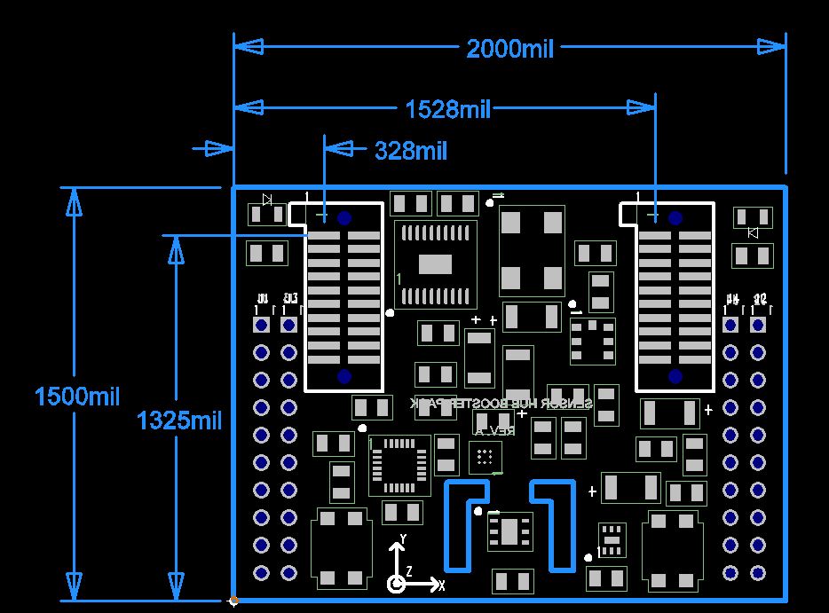

Is there detailed documentation of the Sensor Hub board?
I'd like to know exactly where the EM connectors are placed. There were such figures for the Tiva and Stellaris launchpad boards. Why there aren't for the boosterpacks?
That's great! Thank you David. Could you also check the position of the first EM connector pin (heading up)?
If I'm OK with the samtec connectors datasheet it's (357, 175) - that's important if you'd like to connect a custom board to the sensorhub.
I think that it would be helpful for others to attach that file to the manual of the sensor hub.
