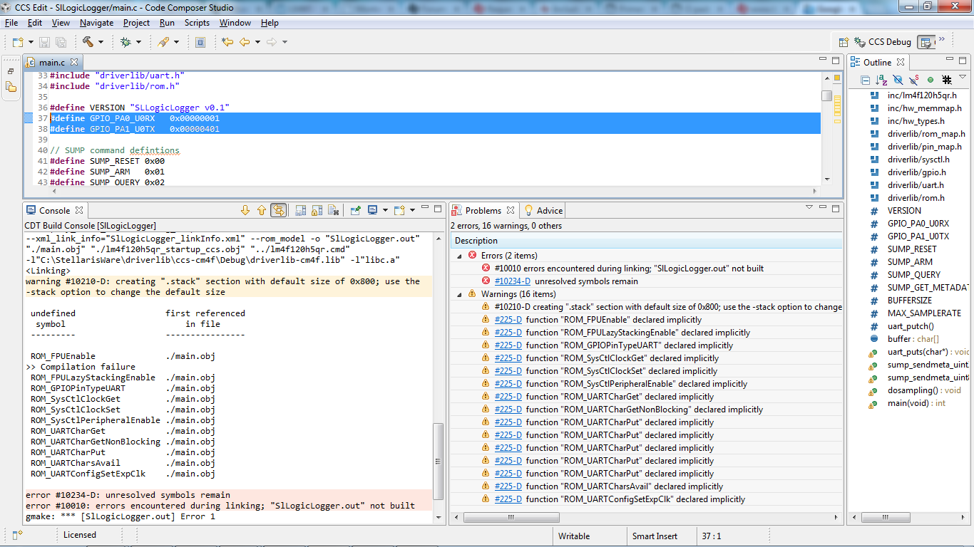

In the design of the logic analyzer initially used the library and StellarisWare had these errors.
I tried several changes that I found on the net and it showed but nothing worked, so I tried to change TivaWare and these two errors are gone, but another appeared.

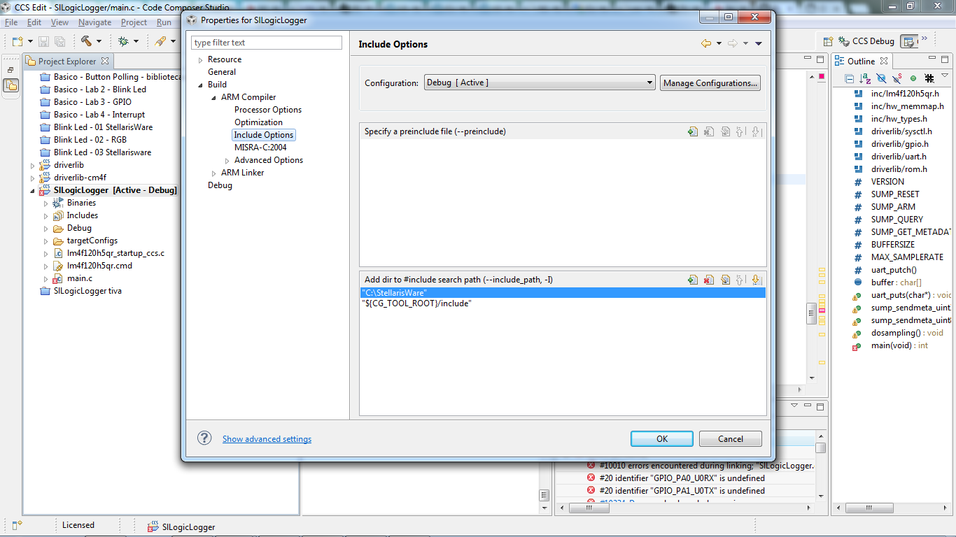

  • You need to setup TivaWare root in your project properties. You have broken linked resources.
    http://processors.wiki.ti.com/index.php/Include_paths_and_options
    Maciej

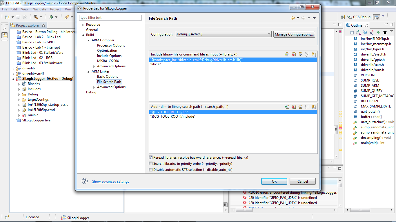

  • MaciejKucia I believe it had executed these settings as illustrated below. Also imported the lib into the workspace.

    You must add this two lines at the beginning:
    #include "pin_map.h"  // contain definitions of the GPIO_PA0_U0RX, but if defined PART_LM4F120H5QR - just open this file to locate by yourself these definitions.
    #include "rom_map.h" // make the link with ROM_xxx functions in ROM
    and pre-define PART_LM4F120H5QR (and the others two) in predefined symbols. If this will trouble you again for unfound GPIO_PA0_U0RX, you can define them also after "include" this way:
    #define GPIO_PA0_U0RX   0x00000001
    #define GPIO_PA1_U0TX   0x00000401
    Petrei

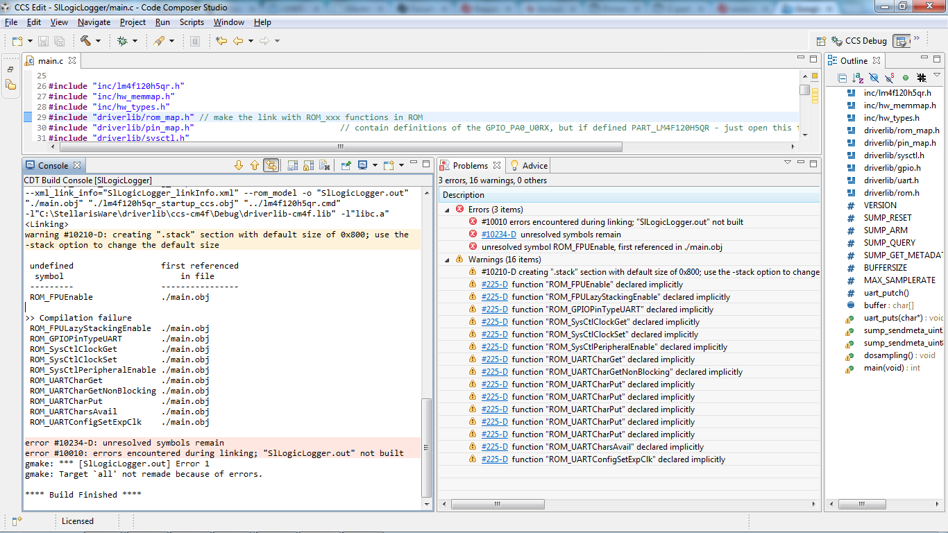

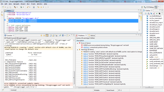

  • Hi Petrei, I followed your suggestions and put the two includes.
    When I put the pre-defined name PART_LM4F120H5QR, CCS show these errors.
    If i try to put the pre-defined and the two #define these errors appear.
    I tried with version 0.1 of code.

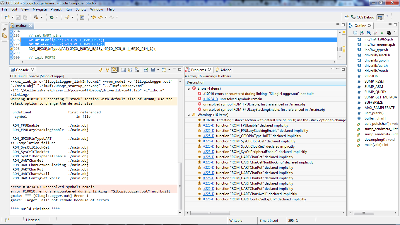

    I think you have made a small progress - the complaints about GPIO_Pxxx_xxx are not anymore present. As for the others (ROM_xxxx) functions not found - this is due to incomplete predefined symbols - you need to add these:
    TARGET_IS_BLIZZARD_RA1
    ccs="ccs"
    You can check these are needed by the rom.h file - only specifying something you will get ROM table use for them - so try again.
    Petrei
  • Petrei, I guess that worked. I put the two pre-defined, after this I compiled without errors.
