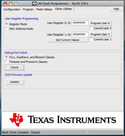

  • Jose,
    Please plug the board in and goto the "Other Utilities" tab, see below.
    Change the radio button to the Blizzard Class option, and then click the "Unlock" button.  The tool will walk you through the rest of the process.

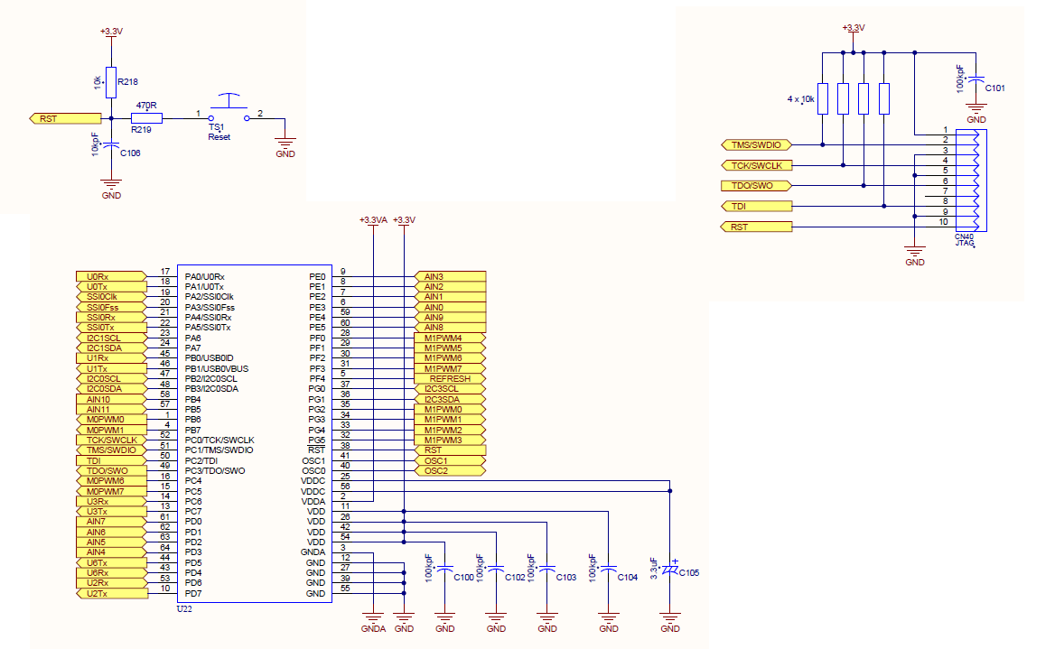

    4) I Attached the file "Circuit.png". As you can see, we assembled the minimal components besides power supply; JTAG ; VDD capacitors; RC for reset.
    José Fernando

    On your VDDC net you have a single 3.3uF which should be ok but also placement and ESR of the cap is important. Can you share these details. These care-abouts are explained with the Tiva C Series System Design Guide.
    I also see +3.3VA and +3.3V are separate rails and GND and GNDA are separate. What is the power sequencing for these? Are they connected together somewhere outside of this page? If so, how?  Depending on how these are connected I could see this being a source of a problem.

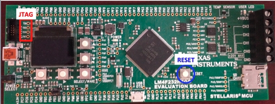

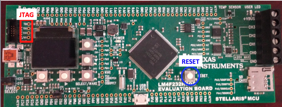

    In order to try the unlock sequence by jumping from the EK-LM4F232, please try the following:
    1) Populate the 4 JTAG headers shown in the red box below (TDI, TDO, TCK, TMS), and jumper wire these over to the corresponding JTAG pins on the 10-pin connector of your target board.
    2) Press and hold the RESET button shown in the blue circle below.  This keeps the MCU on the EK in reset and should allow the LMFlash application to execute the unlock sequence on your target board.
    3) Run the unlock sequence from LMFLash while holding the EK in reset.
    Chris

    While you report "one time working" - schematic shows no vital xtal nor xtal bypass caps (mounted close in to pins 40,41) - so often required - yet nowhere visible...
  • Hi Chris,
    After taking a while, we finally got unlock the processor.
    Besides the four Jtag signals (TMS, TCK, TDI and TDO), we have connected the 3.3V VCC and GND. And we mounted a reset button in our board to keep the RST in low level during the process. We only released after power be on, at the end.
    The mistake I did in my code, I forgot to inform you, is that we have selected external clock without mounted it in our board - using the SysCtlClockSet function in the wrong way.
