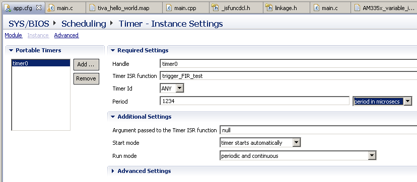

  • Elad Rind said:
    I am already using the Systick function to calculate time differences etc. However, I have not noticed any functionality which allows me to set a function to execute every X number of ticks without literary having to call her in my code
    (which is something I am trying to avoid as my code gets larger and has many sub functions).
    Have you seen SYS/BIOS?
    SYS/BIOS is supported for Tiva devices and allows user functions to be called at periodic intervals using a configuration GUI. E.g.:
    [The TI-RTOS which was a previous suggestion uses SYS/BIOS for the Kernel]

  • Chester,
    Thank you very much for this tip. I have noticed that it is already installed on my machine however I still haven't figured out how to find the GUI but I am sure I will soon.
