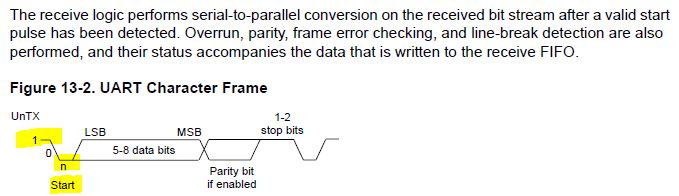

    Appears I stand alone (not the first - nor last time) and here's my reasoning: (this - true copy from MCU manual)
    Note that the non-debug (i.e. User's MCU) when in UART mode - normally outputs, "high."  The high to low transition (or level in some cases) signals the presence of the, "Start" bit.  Thus - to prevent this, "unwanted recognition - and possible reaction to a "start bit" - I suggested that the debug UART_RX's pin be tied high - not low - through proper pull-up!
  • Upon further review tying it off high is a more correct solution however as long as the UART does not see a 1->0 transition to sense a start bit it should be fine.
    Tying UART RX off to its idle state is the correct solution so a pull-up is the correct answer.
