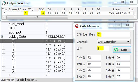

  • Here an IAR capture (Live Watch) of an 8 byte CAN tool transmission - received by an LX4F MCU - on PF0.  (using the essence of code corrections, post above)  Note: CAN tool only displays in decimal - we set IAR to receive/display via "char."
  • Thanks for helping!
    There must have been something wrong with the hardware. We connected the CANRX pin to PB4 -> PB4 and PF0 are now connected together. I changed my code to supprot PB4 and after that everything worked. Then I tried your solution with PF0 and it was also working. Then I tried again with my original code and it was also working.
    The initialization of  ROM_SysCtlPeripheralEnable(SYSCTL_PERIPH_CAN0) two times didn't matter. I checked this and also checked if it matters if I define this at first or later in the code.
