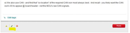

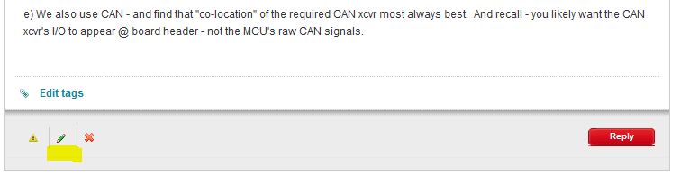

  • Robert Adsett said:
    There appears to be no method to edit these posts
    If you have "signed in" to the forum - the following should reveal - at the bottom of your past post:
    That green pen/pencil indeed enables editing - but only if you originated that post...  (enamel grinding managed elsewhere - suspect a new symbol, targeting that effort, "in the works...")
