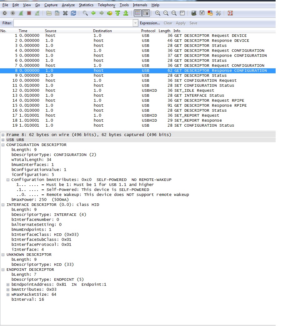

I'm trying to convert the keyboard example for the Tiva C arms over to a custom data pipe with 64 byte frame size in and out.  I started off by loading the keyboard example from the USB libraries (v1.1) into CCS.  I've got that ported over for the TM4C123GH6PM launchpad and running.
I'm now just trying to mod the example to enumerate as a custom hid device so my windows application will see it.  I have the custom data pipe running on an MSP430 board and it works fine with my application...no problems seeing the device.  This keyboard example seems to still be enumerating as a system device though.  I've got a packet sniffer to monitor the enumeration and it looks like no matter what I change in the usbdkeyb.c file (where all the descritpor values are) I can't change the USB_HID_SCLASS_BOOT and the USB_HID_PROTOCOL_KEYB.  Those defines are for the keyboard and from what I understand I need to change them both to 0x00.  I do this here, but when I check my packet sniffer log I still see it as 0x01 in the descriptors which says the subclass is of type keyboard.  I've been struggling with this custom data pipe for a while now.  I had to switch to these arm's and the usb support with the usblib library has been beyond confusing.  Anyways, I feel like after fixing this it shouldn't come up as  a keyboard anymore.  It would be a huge help if someone could at least point me in the right direction as to what to modify where and if I've been on the right track or not.  Below is some code snippets from the pertinant sections and I'll also upload my project.  It isn't much different from the example since all I've been trying to do is get it to not come up as a keyboard (system device) but rather a custom hid device.
Descriptors:

My report descriptor looks different because I initially thought it might be that and have tried a million different usage page configurations.  Thats formed from the MSP430 like code.  If that is wrong, I had something like this with the macros.
ReportSize(8),
        UsageMinimum(0),
        UsageMaximum(255),
        // Input report
        ReportCount(0x40),
        Usage(0x01),
		Input(USB_HID_INPUT_DATA | USB_HID_INPUT_VARIABLE | USB_HID_INPUT_ABS),

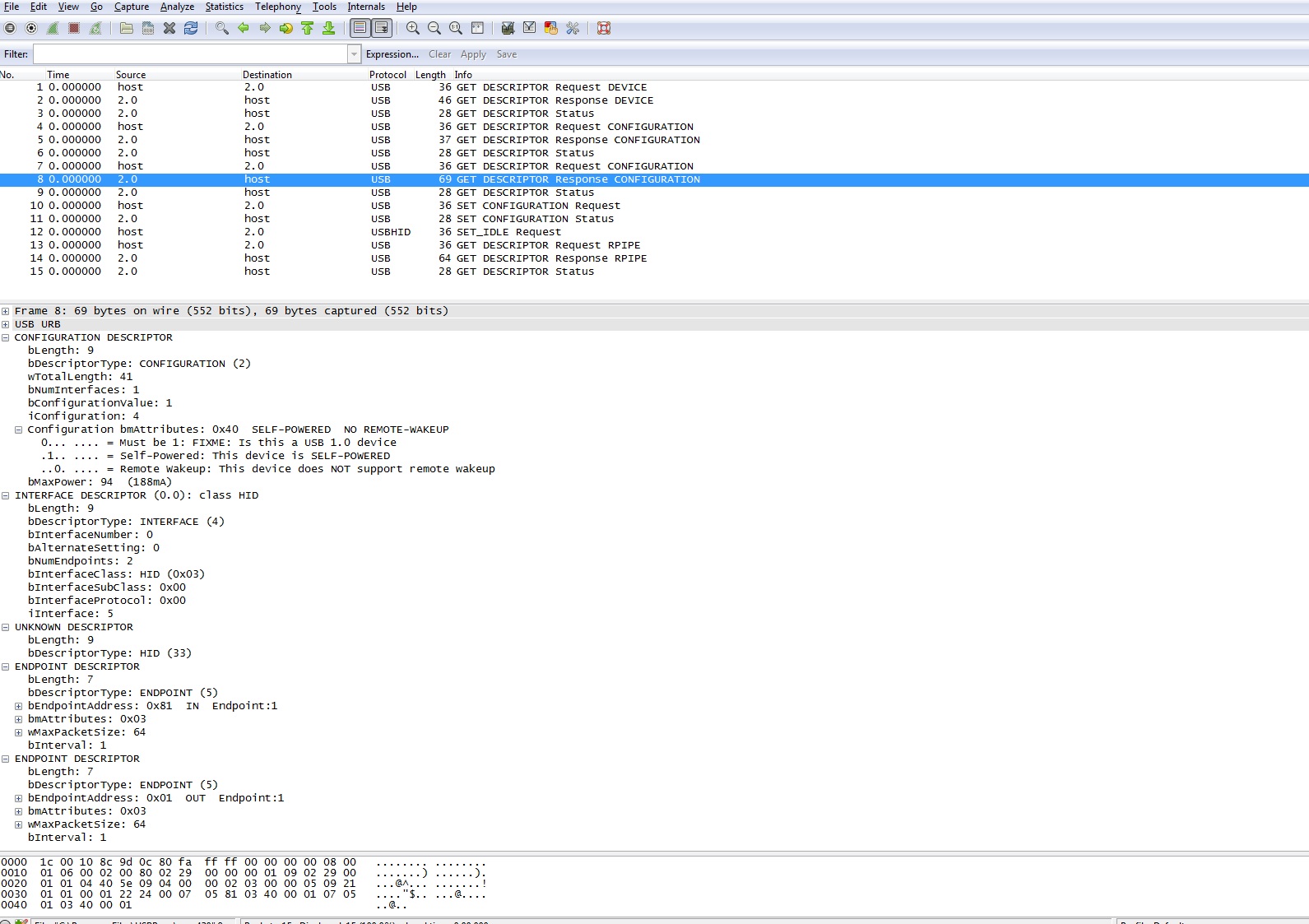

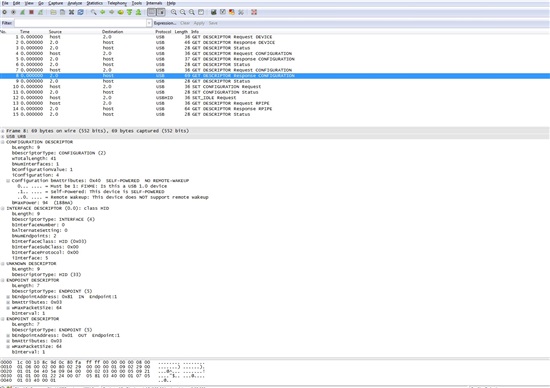

I realize these usb projects are somewhat complicated so I don't expect a solution, but after getting into the c files in the /usblib/dev directory I'm not sure where to go from here.  Also here are some screen shots of what I see on the sniffer when the device is truned one/connected to my computer.

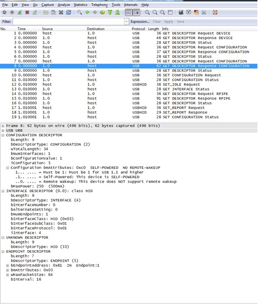

Here in the first descriptor response it looks like the subclass and protocol settings are applied b/c they are both 0.  For some reason though my bcdUSB status shows a 0x0110 which is usb1.1.  I set this to 0x200 (usb 2.0) in the descriptor in the usbdhidkeyb.c file.
Next is Configuration descriptor (I think first time it is sent) and it doesn't have a lot of info in it.  It looks like it gets the self powered, no remote wake up settings correct, but i'm not sure why it says must be 1 for usb 1.1 and higher.  It also looks like it gets the power setting correct.
This is the second sending of the configuration descriptor and this is where my settings are incorrect:
It shows the subclass and protocol, both, being 0x01 forcing it to the keyboard protocol.  I'm assuming this is messing up my custom hid functionality.  I'm not sure why one report says one thing and one says another.
That is the end of communication.  I get this every time and when I compare it to the MSP430 in datapipe mode I don't see the subclass and protocol 0x01's.  Here is a screen shot of the second configuration descriptor from the MSP430 board I have running the HID data pipe code:
My questions are:  Why do the two config reports say different things?  Is that a problem?  If so, looking at my code, what have I missed or where should I look for these settings other thant the usbdhidkeyb.c library file where I've already changed them?  Also, any input or advice to porting this project over to a simple hid data pipe would be greatly appreciated.
I've attached my project and the screenshots in case you can't see them well in this post.

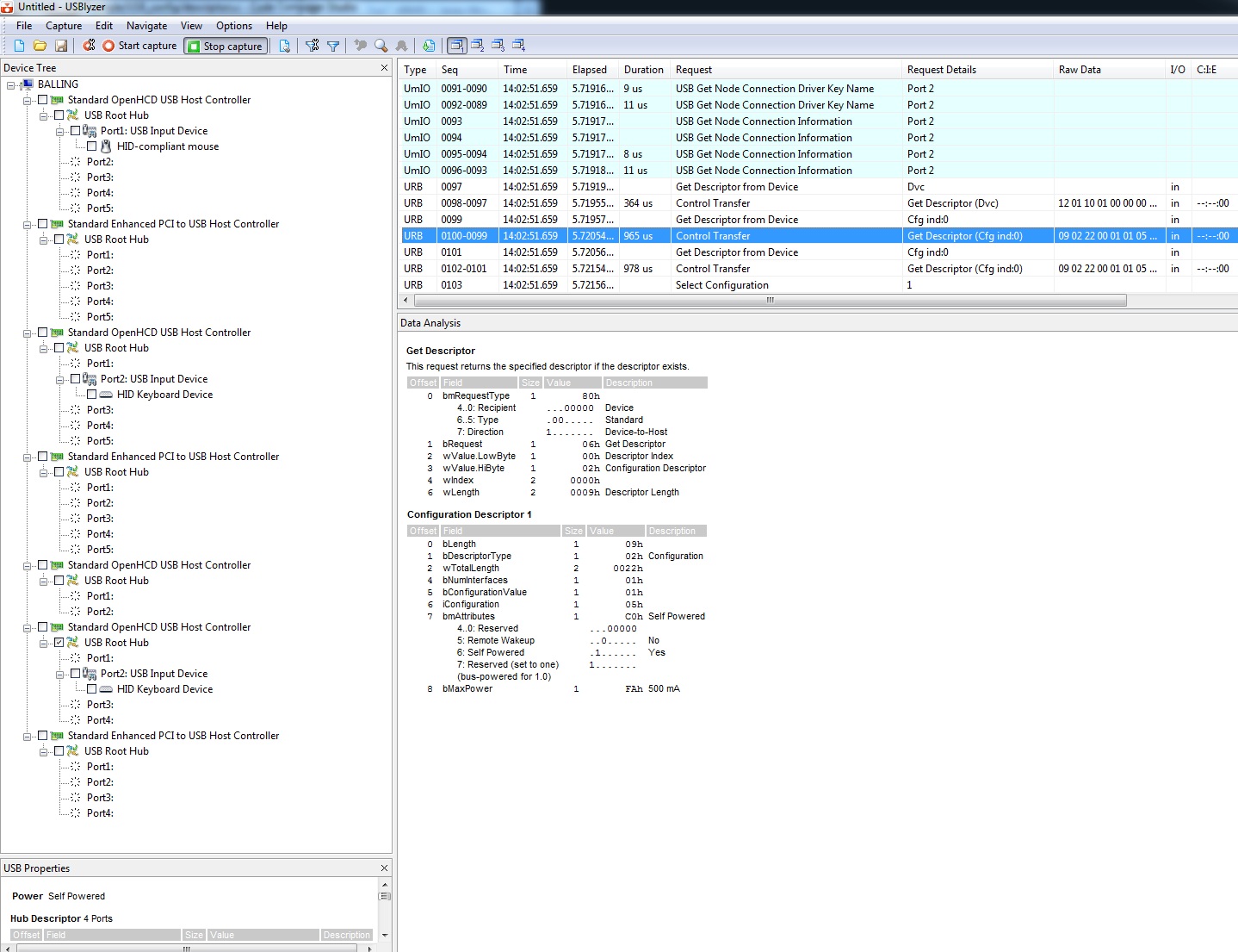

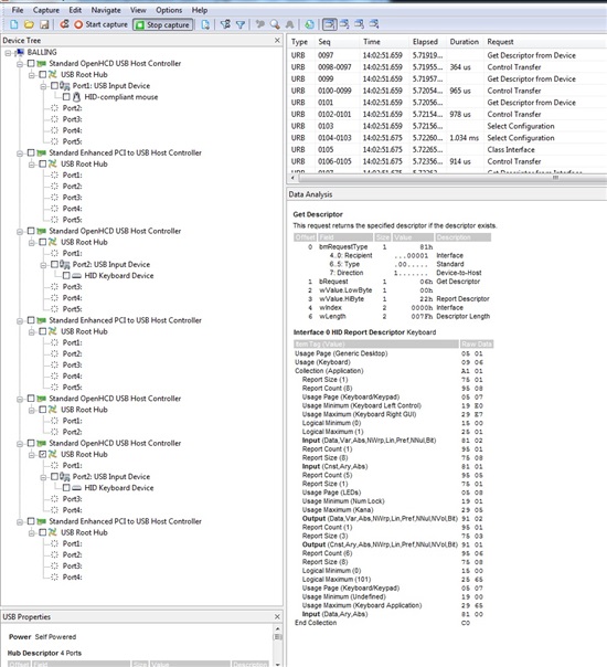

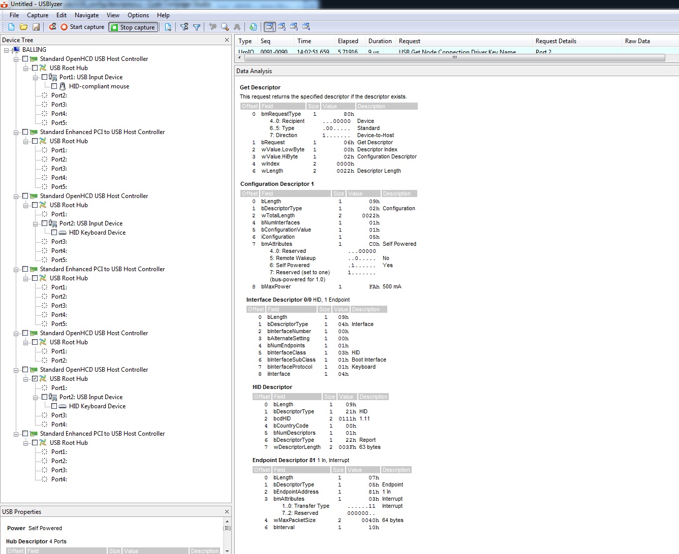

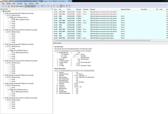

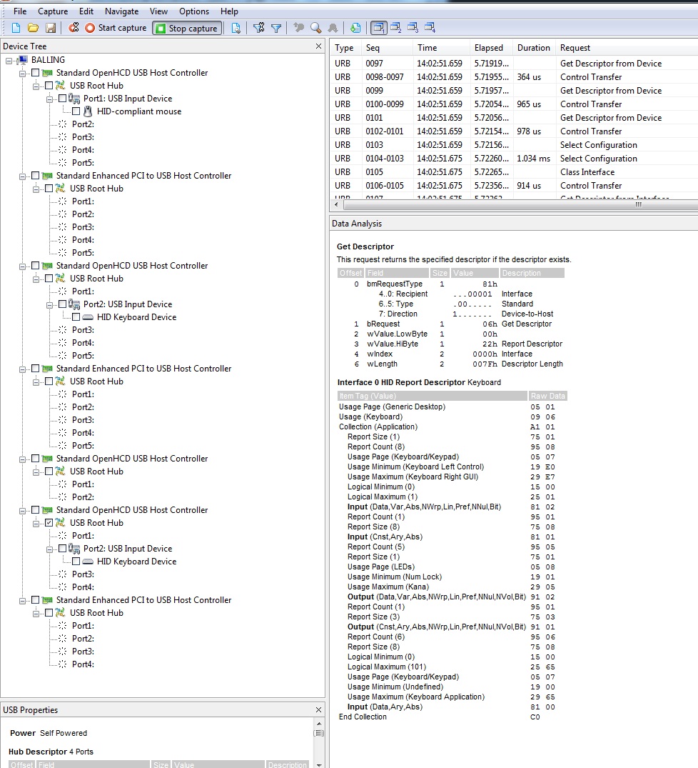

  • So Glen, I took your advice and downloaded USBlyzer.  It is very nicely formatted.  So, after recording the enumeration I see the same thing I saw before.  I also took your advice and set the USB_HID_SCLASS_BOOT definition in the library header to 0 and set the USB_HID_PROTOCOL_KEYB to 0 and still no go.  I also noticed, using USBlyzer, that the usage page stuff is still all keyboard settings.  It doesn't seem to be changing over to my custom one.  I'm not sure what could be going on here as I've changed all this in the code.  Also, the descriptor that has my correct information is the device descriptor.  When it requests descriptors a third time (it does 3 requests...the first and the third are the only ones that have any real info in them) the configuration descriptor, the interface descriptor, the hid descriptor and an endpoint descriptor are all sent over.  In this transmission the interface descriptor has the wrong subclass settings.
    After the transmission of all of the descriptors mentioned above there is a report descriptor that is sent and it is setup for the keyboard from the original project.  I've modified this as shown in my code so where is this coming from?  I feel like the USB framework is pulling information/settings from somewhere other than the usbdhidkyb.c file in the usblib/dev library.
    I understand that the wrong information is being sent to windows, but what exactly (in this wrong info) is telling windows this is a keyboard and not a generic hid device?  Is it the subclass value?  Is it the usage page?

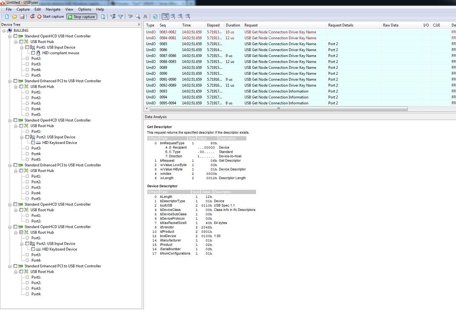

    Below are some screens of my USBlyzer captures.
    Device descriptor: (you can see here my subclass field and boot field are 0 like I want them to be)
    Configuration descriptor:
    Multiple Descriptors: (in interface, my subclass and boot fields have changed to 0x01!)
    Report descriptor:
    Its a bit frustrating because I feel like I understand the USB side I just can't figure out how to use TIs driver libraries!  Thanks again to everyone for the help!
    Rob

            writePacketSize=USBDHIDPacketRead(&g_sHIDDataPipeDevice,
                    myData->buffer,
                    MAX_PACKET_SIZE
                    ,1);
            if(writePacketSize==0)
                _nop();//Shouldn't happen
            }else if (writePacketSize!=readPacketSize)
            // TODO, may need to wait here for tx available.
            retCode=USBDHIDTxPacketAvailable(&g_sHIDDataPipeDevice);
            // Echo it out
            retCode=USBDHIDReportWrite(&g_sHIDDataPipeDevice, myData->buffer, writePacketSize,1);
            return 0;
    #endif
            break;
        case USBD_HID_EVENT_IDLE_TIMEOUT:
            // Not defining a timeout.
            countIdleTimeout++;
            break;
        case USBD_HID_EVENT_GET_REPORT_BUFFER:
            countGetReportBuffer++;
            // TODO: Check report id
            readPacketSize=(uint32_t)pvMsgData;
            if(readPacketSize>MAX_PACKET_SIZE)
                    _nop(); //Shouldn't happen
            return((uint32_t)RXData.buffer);
            break;
        case USBD_HID_EVENT_GET_REPORT:
            countGetReport++;
            break;
        case USBD_HID_EVENT_SET_REPORT:
            countSetReport++;
            // TODO: check report ID
            //set size to let the application know that there is data.
            RXData.size=(uint16_t) (ui32MsgData&0xffff);
            RXData.state=1;
            break;
        default:
            countDefault++;
            break;
        // Pretty sure default return should be 0. Need to verify
        return 1;
    // USB Descriptors
    const uint8_t g_pui8LangDescriptor[] =
    		4,
    		USB_DTYPE_STRING,
    		USBShort(USB_LANG_EN_US)
    // The manufacturer string.
    const uint8_t g_pui8ManufacturerString[] =
        (17 + 1) * 2,
        USB_DTYPE_STRING,
        'T', 0, 'e', 0, 'x', 0, 'a', 0, 's', 0, ' ', 0, 'I', 0, 'n', 0, 's', 0,
        't', 0, 'r', 0, 'u', 0, 'm', 0, 'e', 0, 'n', 0, 't', 0, 's', 0,
    // The product string.
    const uint8_t g_pui8ProductString[] =
    		38,
        USB_DTYPE_STRING,
        'M',0x00,'S',0x00,'P',0x00,'4',0x00,'3',0x00,'0',0x00,
        '-',0x00,'U',0x00,'S',0x00,'B',0x00,' ',0x00,'E',0x00,
        'x',0x00,'a',0x00,'m',0x00,'p',0x00,'l',0x00,'e',0x00,
    // The serial number string.
    // MSP code has 0, leaving with this
    const uint8_t g_pui8SerialNumberString[] =
        (8 + 1) * 2,
        USB_DTYPE_STRING,
        '1', 0, '2', 0, '3', 0, '4', 0, '5', 0, '6', 0, '7', 0, '8', 0
    // The data interface description string.
    const uint8_t g_pui8DataInterfaceString[] =
    		28,
        USB_DTYPE_STRING,
        'H',0x00,'I',0x00,'D',0x00,' ',0x00,'I',0x00,'n',0x00,
        't',0x00,'e',0x00,'r',0x00,'f',0x00,'a',0x00,'c',0x00,
        'e',0x00
    // The descriptor string table.
    const uint8_t * const g_ppui8StringDescriptors[] =
        g_pui8LangDescriptor,
        g_pui8ManufacturerString,
        g_pui8ProductString,
        g_pui8SerialNumberString,
    #define NUM_STRING_DESCRIPTORS (sizeof(g_ppui8StringDescriptors) /                \
                                    sizeof(uint8_t *))
    // From MSP code. Unused
    | String Descriptor                                                            |
    const uint8_t abromStringDescriptor[] = {
        // String index0, language support
        4,        // Length of language descriptor ID
        3,        // LANGID tag
        0x09, 0x04,    // 0x0409 for English
        // String index1, Manufacturer
        36,        // Length of this string descriptor
        3,        // bDescriptorType
        'T',0x00,'e',0x00,'x',0x00,'a',0x00,'s',0x00,' ',0x00,
        'I',0x00,'n',0x00,'s',0x00,'t',0x00,'r',0x00,'u',0x00,
        'm',0x00,'e',0x00,'n',0x00,'t',0x00,'s',0x00,
        // String index2, Product
        38,        // Length of this string descriptor
        // String index3, Serial Number
        4,        // Length of this string descriptor
        '0',0x00,
        // String index4, Configuration String
        22,        // Length of this string descriptor
        ' ',0x00,'U',0x00,'S',0x00,'B',0x00,
        // String index5, Interface String
        28,        // Length of this string descriptor
        'e',0x00
    // HUT =  HID Usage Tables 1.12 document
    // 			http://www.usb.org/developers/devclass_docs/Hut1_12v2.pdf
    // HID = Human Interface Devices (HID) Version 1.11
    //			http://www.usb.org/developers/devclass_docs/HID1_11.pdf
    // Note the byte ordering in HID 6.2.2.2
    // See 6.2.2.7 for global items. The Tiva USBlib seems to follow
    // 	the USB HID document's naming convention.
    static const uint8_t g_pui8ucDataPipeReportDescriptor[] =
        // 0x06, 0x00, 0xff,
        // HUT chap 3 table 1
        // Vendor specific value 0xff00
        UsagePageVendor(0xff00),
        // 0x09, 0x01,
        // Arbitrary number as we are vendor specific
        Usage(0x01),
        // 0xa1, 0x01,
        Collection(USB_HID_APPLICATION),
            // 0x85, 0x3f,
            // Vendor specific. Appears arbitrary.
            // ID can be left undefined if only one report type is created
            ReportID(0x3f),
                // 0x95, 0x3f,
                // The number of items in the report
                ReportCount(MAX_PACKET_SIZE-1),
                // 0x75, 0x08,
                // As this is just generic data, 8 bits in a byte
                ReportSize(0x08),
                // 0x25, 0x01,
                // Not sure why this is defined
                // Or why it's not max 0xff and min 0x00
                LogicalMaximum(0x1),
                // 0x15, 0x01,
                // See above
                LogicalMinimum(0x1),
                // 0x09, 0x01,
                Usage(0x01),
                // 0x81, 0x02, Input (Data,Var,Abs)
                // This shows we are describing the report that goes to the host
                // Second report, same except it's output
            ReportID(0x3f),
                ReportSize(0x08),
                Usage(0x01),
                Output(USB_HID_INPUT_DATA | USB_HID_INPUT_VARIABLE | USB_HID_INPUT_ABS),
        EndCollection
    // The HID class descriptor table. For the mouse class, we have only a single
    // report descriptor.
    static const uint8_t * const g_pui8ucDataPipeClassDescriptors[] =
    // HID device configuration descriptor.
    // It is vital that the configuration descriptor bConfigurationValue field
    // (byte 6) is 1 for the first configuration and increments by 1 for each
    // additional configuration defined here.  This relationship is assumed in the
    // device stack for simplicity even though the USB 2.0 specification imposes
    // no such restriction on the bConfigurationValue values.
    // Note that this structure is deliberately located in RAM since we need to
    // be able to patch some values in it based on client requirements.
    uint8_t g_pui8DataPipeDescriptor[] =
        // Configuration descriptor header.
        9,                          // Size of the configuration descriptor.
        USB_DTYPE_CONFIGURATION,    // Type of this descriptor.
        USBShort(34),               // The total size of this full structure.
        1,                          // The number of interfaces in this
                                    // configuration.
        1,                          // The unique value for this configuration.
        5,                          // The string identifier that describes this
                                    // configuration.
        USB_CONF_ATTR_SELF_PWR,     // Bus Powered, Self Powered, remote wake up.
        250,                        // The maximum power in 2mA increments.
    // The HID descriptor for the datapipe device.
    static const tHIDDescriptor g_sDataPipeHIDDescriptor =
        9, // bLength
        USB_HID_DTYPE_HID, // bDescriptorType
        0x111, // bcdHID (version 1.11 compliant)
        0, // bCountryCode (not localized)
        1, // bNumDescriptors
        USB_HID_DTYPE_REPORT, // Report descriptor
        sizeof(g_pui8ucDataPipeReportDescriptor) // Size of report descriptor
    // The remainder of the configuration descriptor is stored in flash since we
    // don't need to modify anything in it at runtime.
    uint8_t g_pui8HIDInterface[HIDINTERFACE_SIZE] =
        // HID Device Class Interface Descriptor.
        9,                          // Size of the interface descriptor.
        USB_DTYPE_INTERFACE,        // Type of this descriptor.
        0,                          // The index for this interface.
        0,                          // The alternate setting for this interface.
        1,                          // The number of endpoints used by this
                                    // interface.
        USB_CLASS_HID,              // The interface class
        USB_HID_SCLASS_NONE,        // The interface sub-class.
        USB_HID_PROTOCOL_NONE,     // The interface protocol for the sub-class
                                    // specified above.
        5,                          // The string index for this interface.
    const uint8_t g_pui8HIDInEndpoint[HIDINENDPOINT_SIZE] =
        // Interrupt IN endpoint descriptor
        7,                          // The size of the endpoint descriptor.
        USB_DTYPE_ENDPOINT,         // Descriptor type is an endpoint.
        USB_EP_DESC_IN | USBEPToIndex(USB_EP_1),
        USB_EP_ATTR_INT,            // Endpoint is an interrupt endpoint.
        USBShort(USBFIFOSizeToBytes(USB_FIFO_SZ_64)),
                                    // The maximum packet size.
        16,                         // The polling interval for this endpoint.
    // Not needed until the out interrupt is enabled
    // TODO: enable by adding this array to g_psHIDSections
    //      and setting g_sHIDDataPipeDevice.bUseOutEndpoint to true
    const uint8_t g_pui8HIDOutEndpoint[HIDOUTENDPOINT_SIZE] =
        // Interrupt Out endpoint descriptor
        USB_EP_DESC_OUT | USBEPToIndex(USB_EP_1),
    // The HID configuration descriptor is defined as four or five sections
    // depending upon the client's configuration choice.  These sections are:
    // 1.  The 9 byte configuration descriptor (RAM).
    // 2.  The interface descriptor (RAM).
    // 3.  The HID report and physical descriptors (provided by the client)
    //     (FLASH).
    // 4.  The mandatory interrupt IN endpoint descriptor (FLASH).
    // 5.  The optional interrupt OUT endpoint descriptor (FLASH).
    const tConfigSection g_sHIDConfigSection =
        sizeof(g_pui8DataPipeDescriptor),
    const tConfigSection g_sHIDInterfaceSection =
        sizeof(g_pui8HIDInterface),
        g_pui8HIDInterface
    const tConfigSection g_sHIDInEndpointSection =
        sizeof(g_pui8HIDInEndpoint),
        g_pui8HIDInEndpoint
    const tConfigSection g_sHIDOutEndpointSection =
        sizeof(g_pui8HIDOutEndpoint),
    // HID descriptor block.
    tConfigSection g_sHIDDescriptorSection =
       sizeof(g_sDataPipeHIDDescriptor),
       (const uint8_t *)&g_sDataPipeHIDDescriptor
    // This array lists all the sections that must be concatenated to make a
    // single, complete HID configuration descriptor.
    const tConfigSection *g_psHIDSections[] =
        &g_sHIDConfigSection,
        &g_sHIDInterfaceSection,
        &g_sHIDDescriptorSection,
        &g_sHIDInEndpointSection,
    //    &g_sHIDOutEndpointSection,
    #define NUM_HID_SECTIONS        (sizeof(g_psHIDSections) /                    \
                                     sizeof(g_psHIDSections[0]))
    // The header for the single configuration we support.  This is the root of
    // the data structure that defines all the bits and pieces that are pulled
    // together to generate the configuration descriptor.  Note that this must be
    // in RAM since we need to include or exclude the final section based on
    // client supplied initialization parameters.
    tConfigHeader g_sHIDConfigHeader =
        NUM_HID_SECTIONS,
        g_psHIDSections
    // Configuration Descriptor.
    const tConfigHeader * const g_ppsHIDConfigDescriptors[] =
        &g_sHIDConfigHeader
    tHIDReportIdle g_psReportIdle[1] =
            { 0, 0x3f, 0, 0 } // Report 0x3f never polled
    // From msp430 example descriptor.h
    // Configuration Constants that can change
    // #define that relates to Device Descriptor
    #define USB_VID               0x2047        // Vendor ID (VID)
    #define USB_PID               0x0301        // Product ID (PID)
    tUSBDHIDDevice g_sHIDDataPipeDevice =
        // Stealing the MSP430 id so it works with the java app
        USB_VID,
        // The product ID you have assigned for this device.
        USB_PID,
        // The power consumption of your device in milliamps.
        250,
        // The value to be passed to the host in the USB configuration descriptor�s
        // bmAttributes field.
        USB_CONF_ATTR_BUS_PWR,
        // This mouse supports the boot subclass.
        // This device supports the BIOS mouse report protocol.
        // The device has a single input report.
        1,
        // A pointer to our array of tHIDReportIdle structures. For this device,
        // the array must have 1 element (matching the value of the previous field).
        g_psReportIdle,
        // A pointer to your receive callback event handler.
        RXHandler,
        // A value that you want passed to the receive callback alongside every
        // event.
        (void *)&RXData,
        // A pointer to your transmit callback event handler.
        TXHandler,
        // A value that you want passed to the transmit callback alongside every
        // event.
        (void *)&TXData,
        // This device does not want to use a dedicated interrupt OUT endpoint
        // since there are no output or feature reports required.
        false,
        // A pointer to the HID descriptor for the device.
        &g_sDataPipeHIDDescriptor,

  • Hey stepman,
    Thanks so much for the data pipe example!!  I took your advice in your second to last post and moved all of the necessary files from the usblib directory to my project's working directory and that solved my issue with the settings not being changed in all the descriptors.
    I've been studying the example you sent me, but I need to spend some more time on it.  I think the descriptors are setup correctly after comparing my descriptor values to what you have which is good.  I got tripped up in thinking I need two endpoints (one in one out), but now I see you can just use the control end point 0 which doesn't count in the numEndpoint value in the HID interface descriptor.
    The RxHandler and some of the other code is a bit daunting to me so I need to spend some time studying it and working through the usual compilation bugs etc before I can really begin to understand it well.  I'll report back after after this though.  Thanks so much for that file!  It looks like a great solution/learning example!
    One quick clarification. What does the #if 0 -#endif do in this section?

  • Ok cool that makes sense now.  I've got a project put together using that code and it looks like CCS is having problems with structures in usblib.h that are using the PACKED directive.  What compiler are you using?  I'm wondering if I"m seeing a compatibility issue.
    It looks like your code compiles, but all of the included libraries have issues with the structures and what not your main is calling.  I've attached to console log file for example sake.  Still working on this...
    The source code you gave me is making a lot more sense after spending some time with it.

  • Hey Stepman,
    So I got your code up and running after pointing out the GCC extensions issue.  I can't thank you enough for this!!!  The ARM is now being recognized by my python application just like before!  I don't think I could have quite figured this out on my own so thank you so much!!  It makes so much more sense to me now though after seeing a working solution.  I was wondering though...
    You don't seem to use the below structure anywhere...was this just for reference while you were writing the other report descriptor with the macros?

    With the direction from step man I can attest this works on the Tiva C launchpad with the TM4C123G
