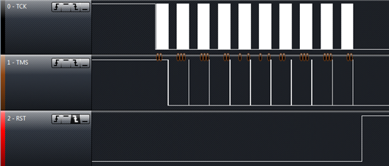

Using an Arduino, I’ve pumped in the unlock procedure. Reset is asserted low and held before and when the device is powered up, TMS is held high as 64 TCKs are clocked in, the JTAG-to-SWD command is clocked in on TMS and stable from the rising edge to falling edge of TCK (LSB first) followed by 64 more clocks with TMS high, then the SWD-to-JTAG command, repeated for a total of 10 mode switches, Reset is de-asserted, I wait a few seconds, and finally cycle the power. Still, I can’t connect to the device.

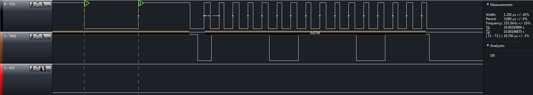

UPDATE - Waveforms:
1. Overall Signal

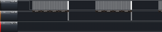

2. Close up on beginning pattern. After looking at the XDS100 JTAG waveforms, I noticed that the "reset" of 50 or more TCKs is done at a slower speed than the rest of the actual data, so I've emulated that as well. (Also, I know that TMS wasn't high during the slow ~50 clocking of TCK after the first, but I've corrected that and it still doesn't work)

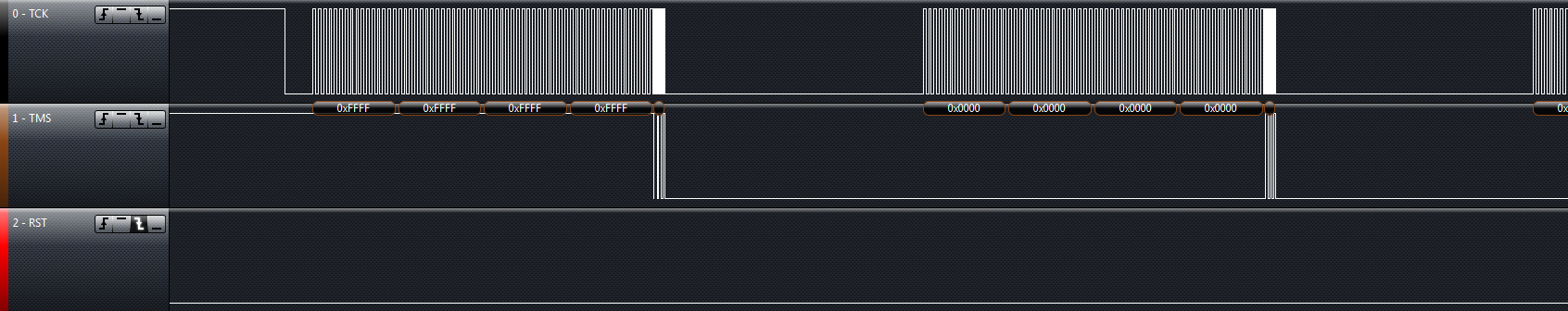

3. Coming out of slow TCKs into actual data. The Jtag-to-swd command, 0xE79E, is clocked in at 333kHz with the transitions while TCK is low and data stable throughout TCK high.
