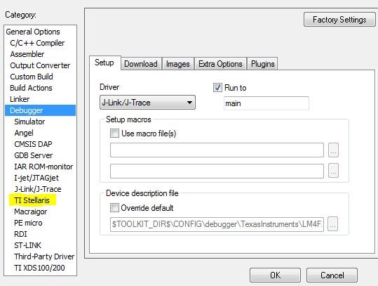

  • While in general TI Austin's, "update to latest/greatest" proves sound - perhaps not this time.
    Ours is paid IAR - and updated to ver 6.60.2.5507.   And this critical bit reveals:
    Unstated is whether JLink (JTAG probe) or PC to launchpad (via USB) is connection medium.  Note the yellow highlight - appears TI Stellaris is the only means (presently) to attempt to attach - if you are w/out JLink.
    Suspect the issue may be the (possible) new ICDI MCU employed under rebrand.  Or not - but perhaps worthy of consideration...
