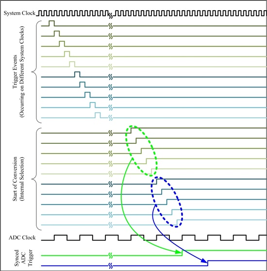

Timer A1 triggers the ADC and is pre-loaded with the offset time. This can be a one-shot or periodic timer .
Timer B1 is a one-shot up-counter for timing the ADC conversion time.
Timers A1 and B1 use the wait-for-trigger (daisy-chain) mode to wait on timer B0 to timeout. A1, B1 are configured, pre-loaded, set into wait mode, enabled, and then fire on the next timeout of timer B0. This works very neatly except for a small limitation in daisy-chain mode – a timer must be reset (with ‘peripheral reset’) after each wait-for-trigger, which is a little untidy and will increase the sampling window time.
Using a ‘shadow’ signal (timer B0) with the same period as the PWM test signal means that triggering is guaranteed to occur, for the same offset, on exactly the same 12.5ns tick. If triggering depended instead on a signal on an input pin, then noise introduced onto the signal may introduce jitter.  A second advantage is that the PWM test signal A0 can be moved in precise 12.5ns steps relative to the trigger B0. This is very useful feature for validating the accuracy of results, i.e. the trigger and ADC do not change, and the measured waveform should move by 12.5ns steps (which is demonstrated easily).

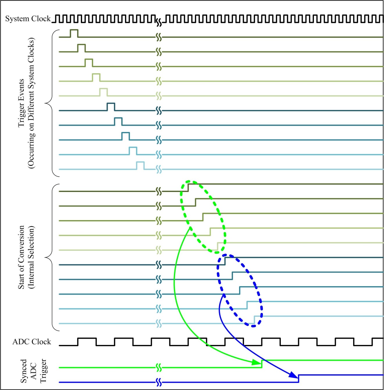

An ADC interrupt service routine first records the time B1, then reads the sample. The ‘conversion time’ from the initial trigger (B0 timeout) is then the B1 time plus the timing offset. Only one sample is collected per trigger event B0 for the experiments here (thus A1 in one-shot mode is sufficient).
With the MCU at 80MHz (ADC at 16MHz), and trying for 80MS/s, the sample values at a sharp pulse edge (e.g. 10-15ns) seemed to vary rather wildly (which might be expected), but I noticed that the same five values seemed to repeat themselves, and these matched up with the conversion time returned in timer B1.
What appears to happen is that for a fixed offset (12.5ns steps) in timer A1, the conversion time varies over five (12.5ns) steps (obviously 80/16). Recording ADC sample values against conversion time, instead of against time offset in timer A1, shows a highly correlated set of samples (see table below). A narrow, sharply rising/falling pulse is the most demanding test here, as just one tick (12.5ns) of timing jitter would destroy the coherence of the waveform at the transitions. To obtain a uniform distribution of times for one offset (in A1), it helps if a small random delay is added between each sampling event (e.g. using the low ADC bits to add a random delay of a few cycles).
Clearly the switch on the ADC sample-and-hold input circuit must open on a discrete 12.5ns step, and the conversion time returned (via B1) maintains this precision.  Clearly also the interrupt latency (for the ADC ISR), plus any other latencies, are exactly the same every time (though it is possible that some incidental feature or interaction may be maintaining this precise latency, which would be a great shame!).
However, when the test signal period is a multiple of five timer ticks, only one time is returned, limiting the resolution to 16MS/s. The obvious explanation is that for a fixed offset, successive samples over several test signal cycles do not range over the five steps available inside a 62.5ns (16 MHz) interval, as they do when the period is not divisible by five. (For an external signal, this is less likely to be an issue in general.)

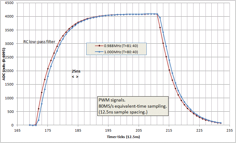

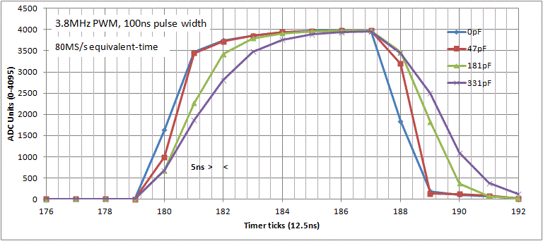

Here is the same PWM pulse (case C=0pF) along with pulses for a range of capacitance values between ADC input and GND :-
The pulse rise/fall times for case C=0pF are in the range 10-15ns (nb. signal into a 1.5K resistance), the data sheet indicates 8-11ns (20% to 80% full-scale).
The trajectory of the waveforms at t=180 suggests that the pulse starts about 5ns before t=180, not at t=179.
Using the case C=331pF, a quick calculation (adding 10pF ADC input capacitance from data sheet) for the rise time (0-3500 in 45ns) gives R=63, and a signal source impedance of 53ohm (i.e. minus 10ohm from the potential divider).
Now a good question is how meaningful are the ADC readings which catch the fastest pulse transitions, i.e. within the range 0-47pF? Rise/fall times of order 10ns would suggest rates of change here of 300V/us. As this is trying to track a change of about 400 ADC units in 1ns, the variation in the samples indicated by the rms value seemed too good to be believable. So, at first glance, I tended to dismiss the readings at the pulse edges, especially since the value returned can be different after a MCU reset (but begging the obvious question, why else should the samples be so consistent?).

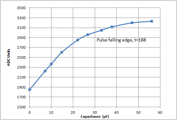

An experiment using low capacitance values (0-47pF) to slow the signal rise and fall times very slightly (e.g. 1ns steps or less) should give distinct and repeatable readings just at the pulse transitions, if there is meaningful resolution available. Here are results using ceramic capacitors between the ADC input and GND for the rising and falling pulse edges (at t=180,188):-
These ADC sample mean values were surprisingly repeatable (e.g. +-2 ADC units) after re-inserting the same capacitor(s) (sometimes a day later!), and the plots show predictable movements. For each C value, the pulse was essentially the same shape (with peak =3980+-2) except at these two times. The rms error from the sample mean at the pulse transitions trends downwards with capacitance (typically 10-20rms for 0pF, 4-7rms for 47pF), the obvious explanation being that the signal rate of change is decreasing.
So this experiment suggests that within a range of about 5ns (see PWM pulse graph for t=180, 188), perhaps ten (and rather more) increments could be resolved, quite easily, by the timer/ADC sub-system, thus indicating a useful 0.5ns resolution. This was very surprising to me, but then I suppose the advantage with this configuration is that the test signal, trigger and the measurement sub-system are highly synchronized (and we have clocks available with a resolution of eight decimal digits!).
The ADC value recorded at a sharp transition seems to be consistent and repeatable after resetting timers, stopping and restarting the test signal and trigger timer (A0, B0) etc.  But after a MCU reset, the transition samples can vary greatly (though resetting the MCU a few times will return eventually to the original values) – this suggests that the timer and/or ADC blocks may synchronize at slightly different points with the (master) PLL after a MCU reset, leading to a slight shift in time which is very obvious at any sharp transitions? (though I would need to look at this further.)
So whilst there is high resolution (<1ns) at sharp transitions, the absolute values there may be less meaningful (though calibration should be possible via a simple circuit to find the position). Anyway, the purpose of this small experiment was simply to estimate the timing resolution, which appears to be very good indeed.

Quite high sample timing resolution (<1ns) would seem to be available using the timer and ADC blocks in the configuration outlined.
In general, a single ADC sample (at MCU=80MHz) can range over five distinct values with timing resolution about 50ns. (This is sufficient in many applications, but much higher resolution is possible.)

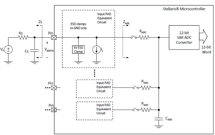

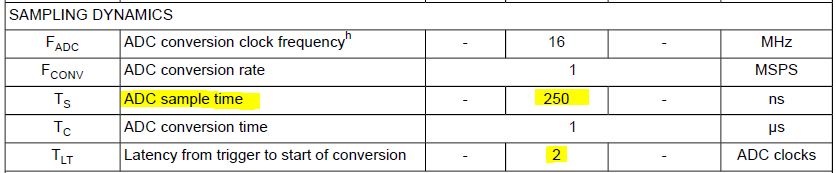

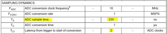

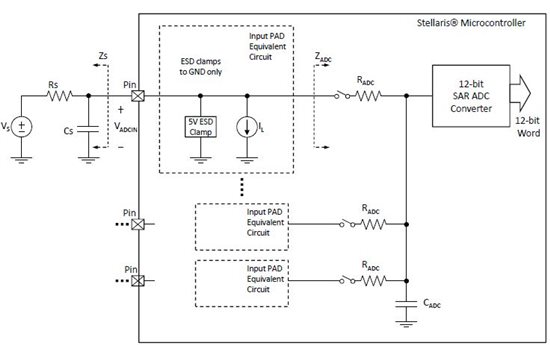

    That said - maker's ADC spec (this from similar LX4F) reveals:
    That "Nominal" 250nS sample time stands in harsh contrast to your findings.  Yet - I've not found a clear, tightly defined "bounding" of that ADC sample time.  (believe that friend Source2 so past requested - this space)   And:
    Where:
    Cadc & Radc enforce (by my calc.) 25nS of "charge/discharge time" which may be further increased by Rs & Cs. To my mind - this casts against the, "80MS/s headline."  Perhaps true - over a very narrowly banded set of conditions - but far too soon, test population (2) too small, (and insufficiently documented - despite this post) for this reporter to support.
    As past suggested - a rapidly ramping, properly bounded, linear signal applied to the ADC may better "prove" such performance claims... (thus the "80MS/s grabber" may not fully meet, "truth in advertising.")
    As always when, "casting far from friendly port" (i.e. this vendor's ADC spec) one must beware of part to part variations - among & between devices, their revisions, device aging and temperature.  (to list a few)  When substantially challenging & exceeding vendor's tech "spec/guidelines" - much caution should be employed.  (do not ask, "how" I know...might uwanted, unanticipated legal exposure be thus invited - overwhelming any/all potential, "ADC gains/savings?")
    You are right, cb - the entire 100ns pulse fits within the data sheet 'ADC sample time' of 250ns !

  • Jim,
    There is no way around the 16 MS/s limit.  This is due to the synchronization between the System Clock domain and the ADC clock domain.
    Once the ADC receives a trigger event, the ADC Controller determines if the appropriate conditions have been met to generate a Start of Conversion (SOC) to the ADC.  The Start of Conversion selection is performed in the System Clock Domain.  To initiate the conversion, this signal must be synchronized to the ADC Clock Domain for the ADC.
    As can be seen from the drawing below, a trigger event that will generate a Start of Conversion can be grouped with four neighboring trigger events.  All five of these trigger events will be synchronized to the ADC Clock Domain and result in a Start of Conversion signal that asserts at the exact same time.
  • @TI Austin,
    Thanks much for your effort in creating this presentation.  (many here felt that, "Ten foot pole rule" was in play - your group.)
    Suspect that Jim may (properly) ask for some explanation/justification for his, "regular, repetitive measurement results" which appear outside of - and in some conflict with - your report here...
    The, "Start of Conversion" timing has been nicely illustrated (above) but the analysis has not extended into the significance of data sheet's ADC "sample time" (250nS) - might that be of some significance - as well?  (may "torpedo" 16MS/s (sustained) claim)

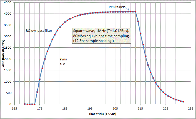

  • Hi Austin,
    Thanks for your reply ... but, following on from poster cb’s comments, I too am unclear, from the information provided, what is happening inside the hardware ...
    Let me approach this from a different angle (and very briefly this time!) ...
    Here is a measurement on a 1MHz square wave with the samples highlighted (red squares). :-
    The signal (internal PWM) has been low-pass filtered to increase the rise and fall times, spreading out the samples to show clearly the step change in measured voltage every 12.5ns sample. The curve closely fits v(t)= 4095 * (1 – exp(-t/RC)) (rise) and v(t) = 4095*exp(-t/RC)) (fall).
    There is good resolution here at 80MS/s (12.5ns) sampling, with low rms variation.
    Now, from what you know of the internal operation of the ADC and timer modules, can you explain how this result comes about? (I have an explanation, but it is necessarily without the benefit of inside knowledge!).
    Jim

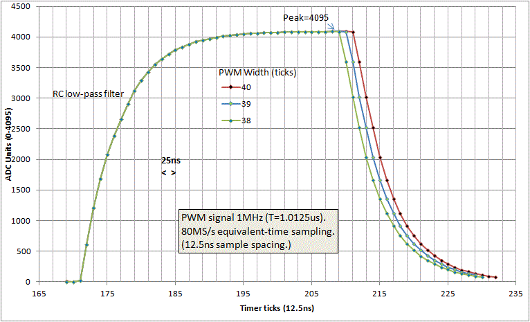

  • Thanks for your comments cb ... yes, I should repeat for anyone new to this thread :-
    These results are for 'equivalent-time' sampling on a repetitive (periodic) signal, i.e. the waveform is reconstructed by sampling over many cycles.
    (NB. 80MS/s equivalent-time sampling is not possible when the 'signal period is divisible by five', as explained in the original post.)
    Here is another result on PWM signals. The pulse width is reduced in three 12.5ns steps, illustrating an unambiguous 12.5ns resolution:-
    The precise parameters are:-
    Signal PWM:- load: 80, match: 40, width: 40, clk: 80000000
    Signal PWM:- load: 80, match: 41, width: 39, clk: 80000000
    Signal PWM:- load: 80, match: 42, width: 38, clk: 80000000
    Jim

  • [Sorry for the delay in responding, but I like to include something new with any reply...]
    Thanks again cb for your valuable comments ... very true, what I am able to demonstrate is good repeatability and resolution (quantitatively), but for assessing absolute (as opposed to relative) accuracy I have only theoretical prediction to work with (which looks good, but ‘how good’?).
    Unfortunately I am an experimenter with basic equipment including an analog scope which is nowhere near accurate enough. I fear that to prove anything useful, I would need a rather accurate (and expensive) digital scope. On the other hand, in my toolkit, I do have a PhD in EE (RF) from many years back and I do like experimenting! Following on from some of the things you have said, I am next going to synthesize some ‘arbitrary waveforms’ to test against.
    Back to the immediate issue, I have a partial answer to one of my questions ...
    I have discovered a way to measure signals which are a multiple of five clock ticks (MCU=80MHz), e.g. at exactly 1.0MHz (T=80), I was only able to achieve 16MS/s equivalent-time. This is by micro-shifting the signal relative to the timing trigger. Such tampering with the signal may not be permissible/possible in some situations, and it will introduce a transient into what might otherwise be a steady-state signal.
    Timer B is the timing trigger, and PWM timer A is the signal :-
                                    HWREG(WTIMER2_BASE + TIMER_O_TAV) =
    HWREG(WTIMER2_BASE + TIMER_O_TBV) + uOffset ;
    The offset is varied from 0 to 4 inclusive, essentially ‘filling in the gaps’ between the 16MHz ADC clock, and the 80MHz MCU clock. Note that any additional lag in setting timer A like this does not matter so long as the lag is constant, otherwise there will be gaps in the range. These timing changes will mean that the subsequent signal PWM timeout/match will occur slightly sooner or later than expected, usually by only 12.5ns, but more when the offset returns to zero.
    To my surprise, this works quite precisely :-
    (The second curve is shifted by one tick in time simply for comparison.)
    The rms variation is up for the case 1.000MHz, and one might expect that the longer the delay after shifting the signal the lower the variation.
    Jim
