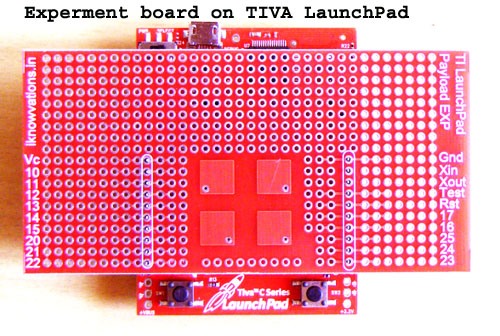

  • We have got experiment board, which can be used to do many experiments with TIVA and MSP430 Launchpads.
    Hope it will help you. Below is the pic of Experiment Board from iknowvations for your information.
