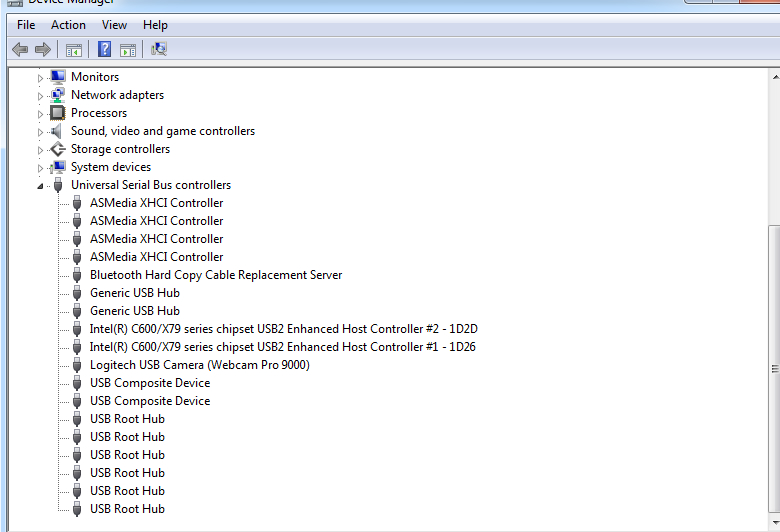

So I connect my TM4C123G to my computer via a USB port. In my PC I check the device manager tab to see whether there's a change, none. I repeatedly pull/plug the board -> refresh. Still there's no change under the device manager -> usb.
In the guide it ask me to search under device manager -> other device. However, I do not see "other device". Also, the board is not defected, when I connect the board to my computer, the lights are blinking. The print screen of my device manager -> usb is shown in this post. Please help, I really want this to work. Thanks

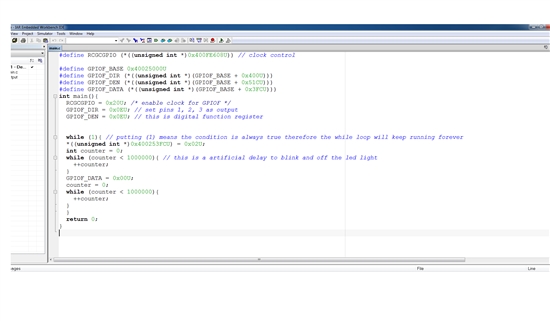

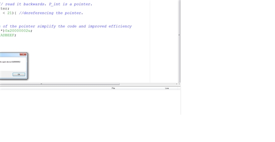

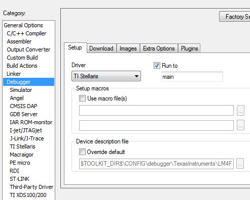

The code I am using to blink the led is also shown in this post. The simulator version works, but when I change project->optoins->debugger->setup->driver to TI stellaris and on the download tab I chekced verified download and use flash loader(s) and run the code. I got
" Fatal error: ***error**. Unable to open device 0x00000002 session aborted"
and
"fail to load flash loader c:\program files\IAR system\embedded workbench\......\LM4Fxxxhxxx.flash.

  • My code is shown here. It works perfectly fine on the simulator. The code is exactly the same as my instructor so I don't think it's the code's fault but just in case.

    I have the same problem. ICDI installed. I was able to upload a program from the board to the hard drive just for trying that system can see the board. However, when I tried to download my small program from IAR Kickstart recommended by TI site, I got the same error message as the topicstarter. Cable definitely connected to the top USB connector (DBG)
    All the Debugger setting are as same as shown in spmu354.pdf for TI Stellaris Driver

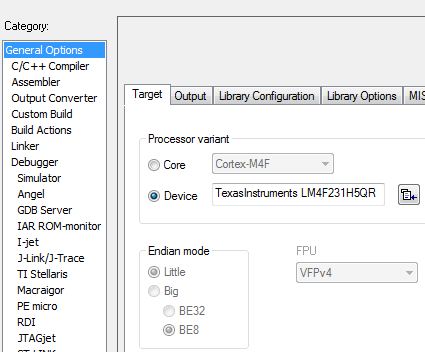

    First - insure you've chosen proper target MCU.  (Note - we don't use Tiva - you must enter your MCU)

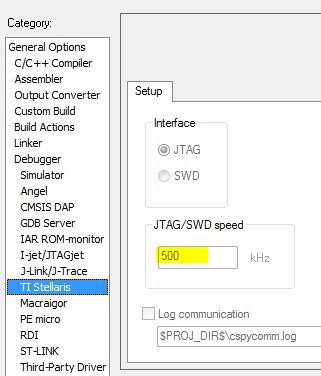

    Then - under Debugger insure you're not using J-Link (use as shown)
    and then (note that 500HKz may be too high - dial down to perhaps 5KHz to start - then increase)

    Tried to set 10 kHz. Downloaded once. Then tried increase the speed up to 100, 50, 20 kHz - did not work. After that could not load neither on 10 or 5 kHz. Started to work at 2 kHz
    Update. Downloaded the code @ 2 kHz and stopped at main. However, trying to make a step stopped IDE to work :(
