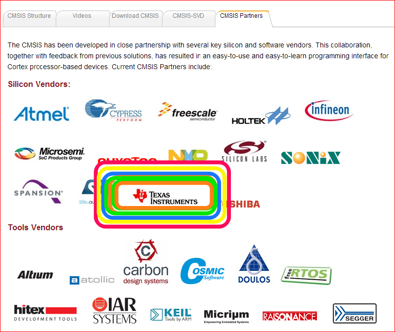

  • CMSIS is running version 4 since February....since TI is a "close CMSIS partner" of ARM....what a great chance to implement it!!!

  • Sigh, so I will try again.
    TI: When will you have the CMSIS DEVICE header files for the TIva 129 and Tiva 123????
    Putting up the "CMSIS compliant" logo is wonderful and all, but the actual header files would help me in the port of a real-time kernel I'm doing.
