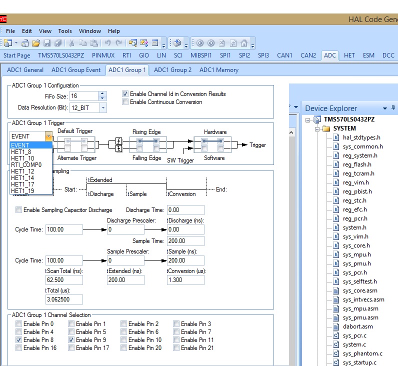

I am using the LaunchPad TMS570LS04x. Right now I'm trying the ADC module. I know how to configure it and work with one channel, however when it comes to use multiple channels, I do not know how to select a specific channel to read the converted value.
I enabled ADIN0 and ADIN9, then with the function adcGetData I read the converted value but I asume that the first time I call the function, I get the value from cannel 0 and the second time the value from channel 9. Is this assumption correct or is there a way to read the value of a desired channel?

    Our ADC module has internal buffers used to store conversion result.
    On your device you have 64 buffers.
    These buffers are used by the 3 conversion groups: Event, Group1 and Group2.
    For each of these group you can select 1 or more channels to be converted.
    Halcogen provides a screen to define the split of these 64 buffers between the 3 groups as shown below:
    In this example, 0 buffer are assigned to Group event, 4 for Group1 and 60 for Group2.
    Each buffer handles the converted value, the ID of the channel converted and additional status bits.
    To convert more than 1 channel, use the following screen in Halcogen:
    Group 1 is configured to convert channel 8 and channel 9.
    Enable Channel Id in Conversion Results is checked. In addition to the converted value, the Channel Id will be stored in the buffer.
    The trigger used to start Group1 conversion is set to be GIOB0 rising edge.
    In this example, the GIOB0 will be set high and low to create the trigger condition.
    On each rising edge, Channel 8 and Channel 9 will be converted in sequence.

  • Hello Jean-Marc,
    Thank you for your reply, it was very useful. Apparently I was missing to check the box "Enable Channel Id in Conversion Result".

  • When I tried this example, I could not select GIO0 as trigger (see attached screenprint) The GIO pins were not in the list of selectable events.
  • Hello Jan,
    The reason why you couldn't find the GIOB0 in the trigger options is because the example provided by Jean-Marc was developed for a different board.
    I pressume you are using the Hercules LaunchPad as well. The MCU of the board doesn't have a port B. Even though, most of the code can be used to make your own code that runs on the LaunchPad.
  • Ah, ok. In that case, I'd probably have to set up a hardware trigger on a GIO pin, and run the code when the notification handler of that trigger is fired. Right?
