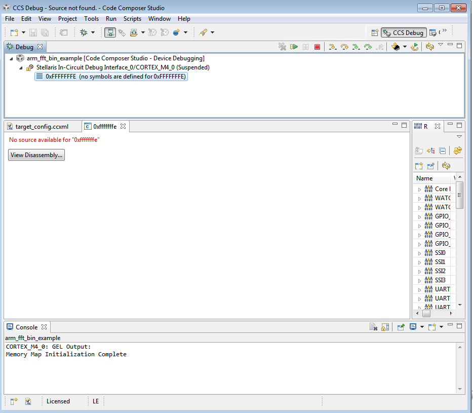

i cannot debug one project. The debug interface und board works well in other projects. Since ours i try different settings, without success.
Which setting causes this behavior ???    CCS5.5  Win7,  TM4C123GX Kit
I please you for help!!
best regards, Walter
1) directly after Flashing i have this state:
2) After klick "SUSPEND(Alt+F8)"  this:

  • Walter,
    It sounds like you never reach main() ?
    The debugger, by default, will try to run to main() after flashing the code.  But if you're taking an exception before getting there the debugger may not stop.

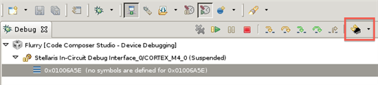

    Please try the following.  Flash the code, then do a system reset by hitting the drop down arrow on this icon:
    You should find yourself at _c_int00().  Single step until you either get to main() or branch to 0xffff.fffe.
    Have you changed your linker script at all?  Or switched from one device to another such that your code doesn't really fit in memory?
    --Miles

  • Hello Miles,
    thank you! I "lost" my linker script file.
    Funny that the debugger dont knock me on the fingers before i start with debugging.
