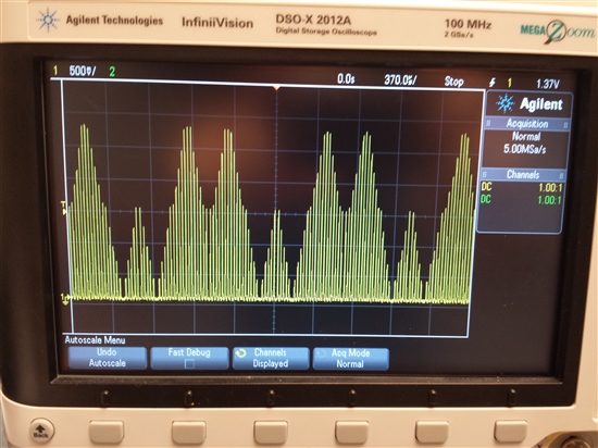

  • Thanks for the response. Well I am trying to create a sine wave using using the R-2R latter DAC method. In order for my code to work, I have to reset all of the pins to low. This causes spikes in the wave. Here is an image of what I am talking about. If I could set multiple pins at the exact same time, I wouldn't have to reset the pins to low before setting them again. I am sending multiple voltage values in a loop to create this signal. Is there any way make a smooth sine wave using the Tiva Launchpad and a DAC or using the R-2R method?

  • R2R DAC,
    OK that gives restrictions and goals.
    First is there a reason not to use PWM?  It is likely to be easier. Also R2R beyond a few bits is going to show accuracy and probably linearity problems.  How fast do you need your output sine way to change?
    However, assuming you want to continue with an R2R setup, I suspect your biggest problem is not non-simultaneous switching but rather the normal glitching you would expect to see on transitions as a result of the output capacitance of the drivers.  This has to filtered out but it can be minimized by careful design.
    Assuming you already have your outputs on a single port or have taken cb's suggestion of an external latch to synchronize the outputs your biggest noise is going to come from switching multiple lines at once.  So design you output code to minimize that switching.  Take a look at the gray code, it is designed to only switch a single bit as you count up or down.  For a sine wave gray coding should make a big difference.  You will end up switching only a few bits worst case near the 50% point.
    If you are outputing essentially random values then you are going to have to filter the output (You probably want a post resistor driver anyway).  The good news is that this should all be high frequency noise and relatively easy to filter out.  Truthfully you probably want to filter the output in any case but covering the all on/all off transition is harder than a few bits.
    You will note that commercial high frequency DACs have a maximum glitch specification.  Now you know one of the sources of the glitches.
    Robert

    *** Best speeches - "now even further along on ride home."   From Carlos, "In order for my code to work, I have to reset all of the pins to low."  Appears that statement sits unchallenged.  Carlos - why is that?  If it's an 8 bit parallel DAC does not the input of 0xFF yield full scale DAC output.  And as we pass thru that max - would not 0xFC as the very next byte passed to the DAC - cause the DAC output to reduce by 4 bits?  And - there has been no "drive" to DAC zero!
    Unstated is "Why all pins must be reset low?"  (haven't built/used R2R style DAC in decade(s)) - but should not that R2R respond to inputs in any sequence - w/out being forced to zero?  Quite often the problem is not w/in the MCU - but w/in the problem description & presentation - seems quite possible, here...
  • I'd missed that "must reset all outputs to zero".  That makes me think the outputs are spread over multiple ports (the 'scope trace also suggests this) but that doesn't fully explain things without a better description.
    Carlos, please describe the symptoms of what you are seeing and fully describe your electrical setup as well as how you are driving the port pins in software.
    Certainly if you are spread over multiple ports you will have an even larger problem and cb1's suggestion of a latch is the first thing to do.

  • There is one small advantage I can see to zeroing.  The signal looks cleaner on an oscilloscope capture.
    It's a worse match to the wanted output but it is visually easier to interpret.
    That's really only useful if the goal is to produce an oscilloscope output though.
