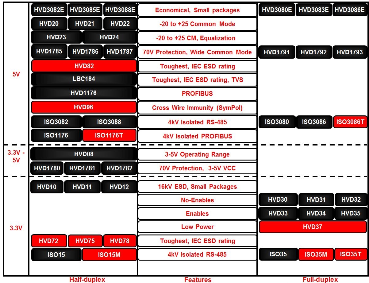

    Andre, in case you are also looking for a transceiver, I thought I could give you some of the transceiver solutions from TI! We offer a large portfolio of transceivers both half and full duplex, with and without enables. Please let me know if you have any questions.
