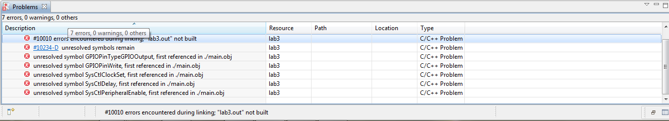

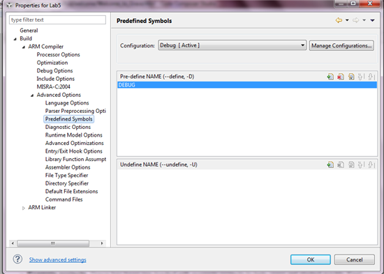

  • Sir,Here i am see that i was remove the predefines "PART_LM4F120H5QR TARGET_IS_BLIZZARD_RA1" from the lab3 then it's give seven error which are this photo.
    and if i add predefines "PART_LM4F120H5QR TARGET_IS_BLIZZARD_RA1" in the blinky project then it show the error which is blinky.out file could not open.
    Buy This two observation i find this error(.out file could not open) is related to predefines.
    my blinky project is working as i remove the predefine.
    but lab3 is not working.
    now what to do??
    For sure the predifines must be added to each project.
    Now about your errors: the easiest to overcome may be to prefix each specifierd functions with ROM_ prefix and to add rom_map.h file as includded file. Explanation: the error message means the function is called with declaration but no definition (i.e the code for that function is not found). The cure is to add that, either by specifying to take the code from ROM, either from driverlib library.

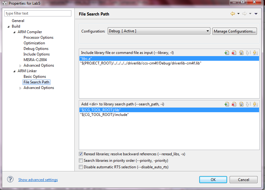

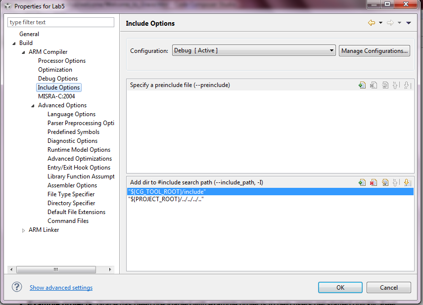

  • --preinclude="ROM_prefix" --include_path="C:/ti/ccsv5/tools/compiler/tms470_4.9.5/include" --include_path="C:/Users"
    The preinclude is incorrect, remove it.
    You don't have enough include directives. Compare it to the build that works. Is it the same?
    I would recommend deleting this project and importing again.
    It's possible CCS is having issues with the workspace location, but it's hard to tell. Try importing lab5 again. If it fails, post the build log again and a screen shot of the Includes of your build setting.

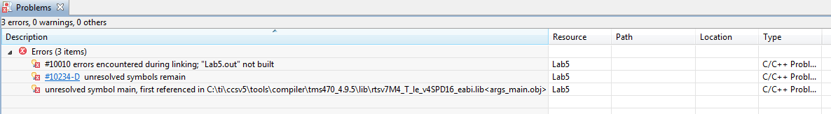

  • Build of configuration Debug for project Lab5 ****
    C:\ti\ccsv5\utils\bin\gmake -k all
    'Building file: ../main.c'
    'Invoking: ARM Compiler'
    "C:/ti/ccsv5/tools/compiler/tms470_4.9.5/bin/cl470" -mv7M4 --code_state=16 --float_support=FPv4SPD16 --abi=eabi -me -g --include_path="C:/ti/ccsv5/tools/compiler/tms470_4.9.5/include" --include_path="C:/StellarisWare" --define=DEBUG --diag_warning=225 --display_error_number --preproc_with_compile --preproc_dependency="main.pp"  "../main.c"
    At end of source: warning #97-D: a translation unit must contain at least one declaration
    'Finished building: ../main.c'
    'Building file: ../startup_ccs.c'
    "C:/ti/ccsv5/tools/compiler/tms470_4.9.5/bin/cl470" -mv7M4 --code_state=16 --float_support=FPv4SPD16 --abi=eabi -me -g --include_path="C:/ti/ccsv5/tools/compiler/tms470_4.9.5/include" --include_path="C:/StellarisWare" --define=DEBUG --diag_warning=225 --display_error_number --preproc_with_compile --preproc_dependency="startup_ccs.pp"  "../startup_ccs.c"
    'Finished building: ../startup_ccs.c'
    'Building target: Lab5.out'
    'Invoking: ARM Linker'
    "C:/ti/ccsv5/tools/compiler/tms470_4.9.5/bin/cl470" -mv7M4 --code_state=16 --float_support=FPv4SPD16 --abi=eabi -me -g --define=DEBUG --diag_warning=225 --display_error_number -z --stack_size=256 -m"Lab5.map" --heap_size=0 -i"C:/ti/ccsv5/tools/compiler/tms470_4.9.5/lib" -i"C:/ti/ccsv5/tools/compiler/tms470_4.9.5/include" --reread_libs --warn_sections --display_error_number --rom_model -o "Lab5.out"  "./startup_ccs.obj" "./main.obj" -l"libc.a" -l"C:/StellarisWare/boards/MyLaunchPadBoard/Lab5/ccs/../../../../driverlib/ccs-cm4f/Debug/driverlib-cm4f.lib" "../lm4f120h5qr.cmd"
    <Linking>
     undefined first referenced
      symbol       in file
     main      C:\ti\ccsv5\tools\compiler\tms470_4.9.5\lib\rtsv7M4_T_le_v4SPD16_eabi.lib<args_main.obj>
    error #10234-D: unresolved symbols remain
    error #10010: errors encountered during linking; "Lab5.out" not built
    gmake: *** [Lab5.out] Error 1
    gmake: Target `all' not remade because of errors.
    >> Compilation failure
    **** Build Finished ****
    Here ,I am sending you the screenshot of many window.
    here if i remove the include ROM_prefix than get the that three error.
  • Is main.c empty?
    You'll want to follow the workbook and add the code. Feel free to post main.c if you run into issues.
