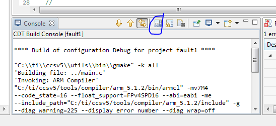

  • Did you import the project?
    Can you post the build log?
    Or you can compare the build log from the working project with the failing project
