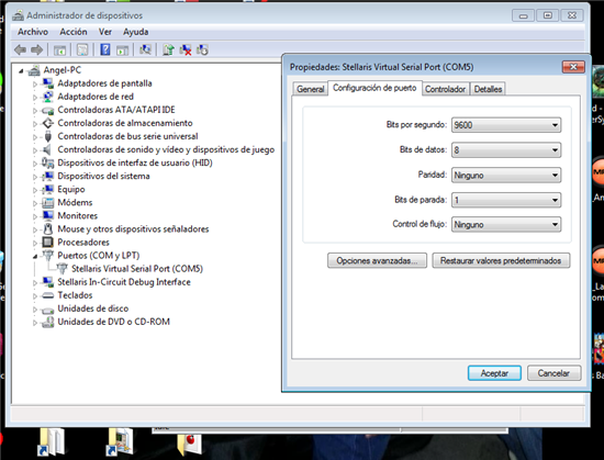

  • Has the launchpad ever worked for you?
    Which USB port are you using on the launchpad?
    Is it detected by your computer? Assuming windows, what does the device manager show?
  • launchpad TIVA, iam using COM5, and yes its detected but the divice manager show the same look:

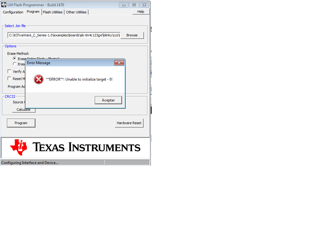

    but when i want to use the LM Flas Programmer, show this:

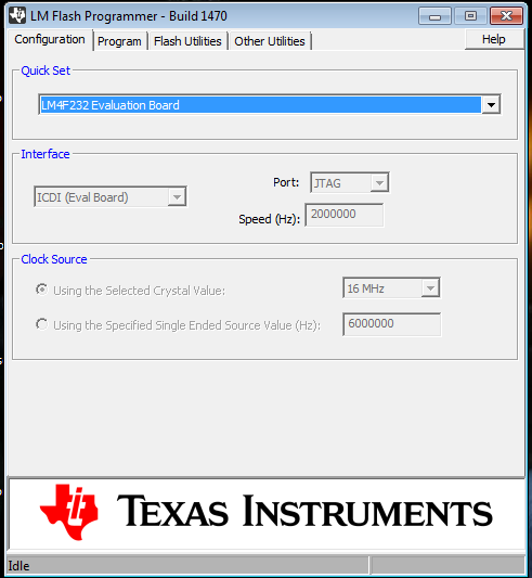

    and this its my configuration:

  • The error from the lmflash means it is having trouble communicating the the device, but the ICDI is working.
    1. Verify that the VDD jumper is installed. You can get this error if the target device is unpowered
    2. Change the quickset from lm4f232 to "TM4C123G Launchpad"
    3. Try unlocking the debug port:
    http://e2e.ti.com/support/microcontrollers/stellaris_arm/f/471/t/143216.aspx
    The Tiva device on the Launchpad is a Blizzard class device
