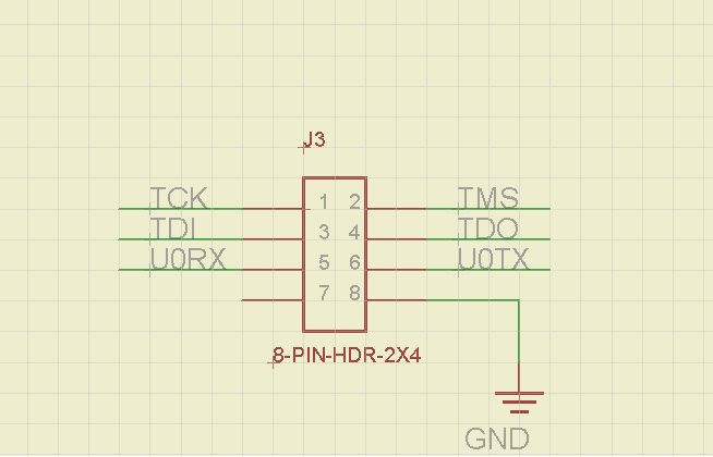

I've got some hardware up and running using the TM4C123GH6PMI Tiva C arm.  My question is about the VDDC pins.  I accidentally connected them to my VCC (3.3V) rail in my layout.  I powered up the circuit like this and it basically shorted out the board.  I realize this is probably damaging, but I was wondering if it would destroy the part or not.  I wasn't sure if there was some kind of diode protection or not.  The pins are now lifted so they are not connected to VCC and just floating.  I know now they are supposed to be connected to a cap specified in the datasheet, which I've found, but whats done is done.  Should I assume this part is bad and just build up another board since I'm getting "error communicating with target" and "frequency out of range"? The board shows up fine in windows device manager.  I also have the jumper under the power led removed per link:
http://processors.wiki.ti.com/index.php/Stellaris_LM4F120_LaunchPad_Debug_How_To
Also, I'm trying to program a second board using a Tiva C launchpad.  My connection header is shown below in a screenshot.  It sounds like, from reading TI's wiki page on programming target devices using the Tiva C launchpad as a  programmer, that you just connect TCK, TMS, TDO and TDI and ground.  Is this correct?  My board doesn't seem to be recognizable by CCS and I'm wondering if I'm missing a signal or something.  I've also tried connecting the reset pin on my board to the reset pin on the launchpad and still no luck.
The actual error that I get is "frequency out of range".  I can get this to go away if I don't connect the EXTERNAL DEBUG pin on the launchpad to ground.  If I let that float then CCS just freezes up upon entering debug mode.  I've tried to copy the schematics for the launchpad as  closely as I could regarding   the wake pin which I have tied high through a 100k and the HIB pins i floating.  The VBAT pin is tied high as well directly to the 3.3V rail just like the launchpad schematics.  I've also added a 4.7uF cap across vddc pins by moding the second board (which didn't experience the VDDC problem as described above) and still no luck.

  • Hi Rob,
    I'm sorry for your troubles.  There could be a lot going on here.  First a couple of comments:
    1. I would assume that the part that was subjected to 3.3 V on VDDC is damaged.
    2. 4.7 uF on VDDC is a bit high.  The spec is 2.5 to 4 uF.
    3. The System Design Guidelines app note is a great resource to help you review your design and ensure that you have a sound hardware platform.
    How do you have the debugger configured in CCS?  Open the target_config.ccxml file inside your project and check the following:
    1. On the Basic tab, the connection should be specified as Stellaris In-Circuit Debug Interface, and select the part you are using.
    2. On the Advanced tab, click on CORTEX_M4_0 and ensure that the JTAG Frequency is 1000000 Hz or less.  Try something slower and see if you get any different results.
    Open the project properties box and click on the Target tab, and then select the LM3x Flash Settings.  Ensure that the crystal frequency matches your board frequency.
    You can also try using LMFlash Programmer to see if you get different results.

  • Sue,
    Thank you so much for the input.  I finally got my target board programmed.  I went though all of your suggestions which were very enlightening, but the problem was that the chip was locked.  I could connect the header on the launchpad and program that chip fine, but could not switch over to my target.  After I ran the unlock utility in LM Flash programmer (following the directions in the pop windows after starting the unlock routine) I got it successfully programmed.
    I also changed the 4.7uF cap to two 4.7uF caps in series cutting the capacitance in half which also may have been one of my problems.
    Some notes for others:  If you are trying to do the same thing make sure to check each pin in detail to know how to load it so you don't make similar mistakes to the ones I made with VDDC.  Also, if you do not tie the reset signal into your target from the launchpad (like i didn't) you will have to manually reset your target board to reprogram.  At least thats what I have to do.  I left Ext. Debug disconnected and everything seems to work fine.  I also have a additional 10k pullup on the JTAG signals.  Make sure you have a common ground between the target board and the launchpad as noted in the wiki.
