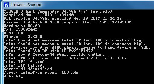

hello guys,
I am using Stellaris EKLM4F120XL evaluation kit which is almost equal to Tiva board.At first I used to run any code and it used debug successfully with IAR Embedded workbench.After I ran qs-rgb programme given in stellarisware.It also ran successfully.but after that i ran led blinking programming of my own there was error in downloading:
 Verify error at address 0x000000E2, target byte: 0x00, byte in file: 0xD8
Verify error at address 0x000000E3, target byte: 0x00, byte in file: 0xFF
I tried to erase flash using LMFLASH Programmer.But it still doesn't work.And there was increment in number of errors.
There is any way i can stop this??

         Try the LM Flash Programmer Debug Port Unlock Utility (select Blizzard Class). See, post below for further info.
         JTAG Communication Failures

  • Vishal,
    Can you post the entire project here? One of us can take a look at it and suggest a few pointers.

  • Ok here i am posting.My programme is very simple.I have used simple pointers to turn on all the bits of RGB LED.
    int main() { *((unsigned int *)0x400FE608U) = 0x20U; *((unsigned int *)0x40025400U) = 0x0EU; *((unsigned int *)0x4002551CU) = 0x0EU; *((unsigned int *)0x400253FCU) = 0x02U; *((unsigned int *)0x400253FCU) = 0x04U; *((unsigned int *)0x400253FCU) = 0x08U; return 0; }
    As you can see it is very basic code.No complications
    Now here the errors after formatting flash:

    That JTAG speed @ 500KHz seems high - and had you intended to switch to AHB (fast) bus?
    We also run IAR but via J-Link - note 100KHz speed in our successful exchange, below.  (and via SWD)
