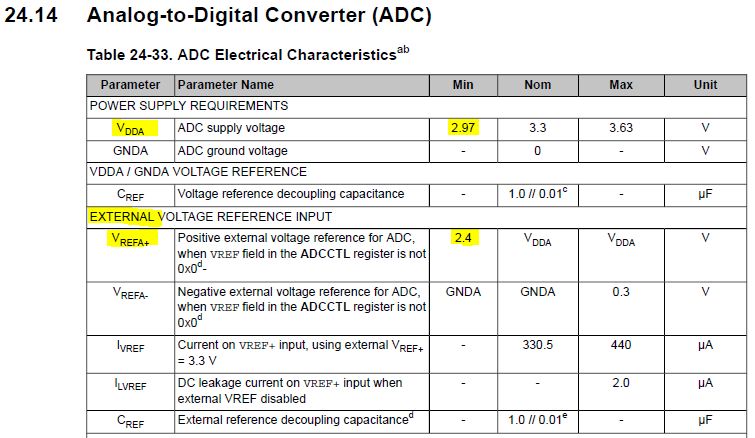

  • @ Sugita,
    Thank you - the details you've supplied are now sufficient - we're in your debt - much appreciated.
    Believe I see how friend Petrei made his 2V97 recommendation - suspect others may benefit as well.  (Petrei may wish to edit his "Verified" post in regards to his 2V97 as minimum VRef recommendation - which I believe will be revealed as incorrect...)
    Below is the pertinent part of the ADC spec for those MCUs which accommodate external VRef.  (most smaller pin count MCUs do not!)   Note that the 2V97 (2.97V) is the prescribed min for VDDA and that 2V4 is the min for VRefA+, thus your choice of 2V5 is indeed w/in spec. (and some w/in my group (moi?) thought as did Petrei - but no longer...)
    You must bear in mind that while your ADC resolution has increased w/use of this lowered V reference - you have "surrendered" some V_ADC input signal range - and must now limit your input signal V to 2V5. Input signals - reaching to VDDA will "cause no harm" - but your ADC will saturate @ 2V5 - thus signals beyond that level will not be properly registered...  (i.e. input signals between 2V5 & 3V3 will all register the same {0x0FFF, or 4095)
    @cb1_mobile, mea culpa! - thanks for warning me about. This comes from my habits to supply the VDDA from the reference voltage (although the current from VDDA pin is not specified…), and maybe because I never used a reference smaller than VDDA - besides the implication shown by you, (saturation) also the board design should be more careful in minimizing the electrical noise.
