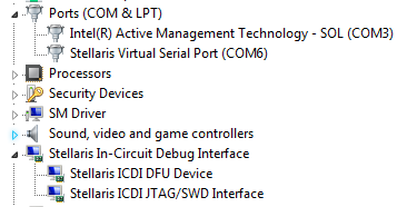

    I'm sorry, I'm not familiar with lab 2. However, if you are using a LaunchPad, it does not have an FTDI device.  The on-board debug is supported by a Tiva device and requires the Stellaris ICDI drivers.  Please carefully follow the instructions in this document.  If this process fails to solve your problem, please provide information on what Windows Device Manager indicates about connected devices.
    Sue
  • Sue,
    Thanks for getting back so quickly. I did follow the  document that you referenced. The Window driver shows that the ICDI drivers are properly installed (same as Figure 22 of  document

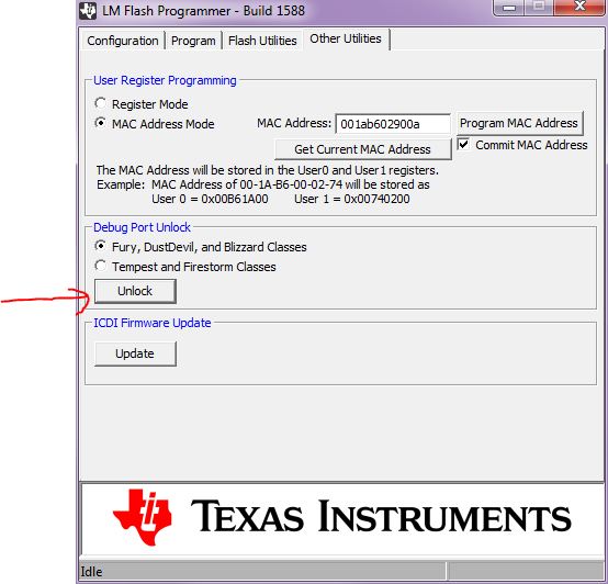

  • Thanks for the reply, Karl.  I'm going to assume that you have never properly connected to the board.  Please try using the Debug Port Unlock utility in LM Flash Programmer.  Use the Blizzard setting and follow the on-screen prompts.  You may need to try it a few times.  Please let me know if using this utility allows you to connect with the board.
    Sue
  • Sue,
    Please give me instruction for running Blizzard.
    Karl
  • Karl,

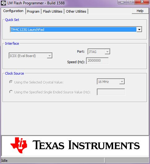

    Run LMFlash Programmer and select the TM4C123G Launchpad in the Configuration Tab.
    Go to the Other Utilities tab and select the Fury, DustDevil and Blizzard classes button.  Then click on Unlock.
    Follow the on screen instructions carefully.  You may need to run the Unlock utility multiple times to regain communication.  Once it unlocks successfully, go the the Program tab and select a TI-provided .bin file, such as blinky.bin to download and see if that works to know if your JTAG connection is working properly.
