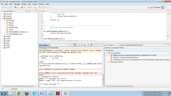

  • 2311.keypad tiva.docx
    I am trying to attach a keypad of 3x4 matrix. The errors found are confusing me. I tried adding the keypad.h file for the same and also checked all the libraries added. Kindly let me know what is the issue with my code. The code is also attached herewith.
    Revert asap. Thank you.
    Mit Morbia
  • Hi Mit.
          Did you declare your function prototype at keypad.h as "extern"? Post your keypad.h

  • Hi Mit,
    In the test file that you attached which I think is main.c, there is no call for main function call from tm4c123gh6pm_startup,c
    Amit

  • Hi Amit,
    I added the main.c file which was missed by me. Thank you.

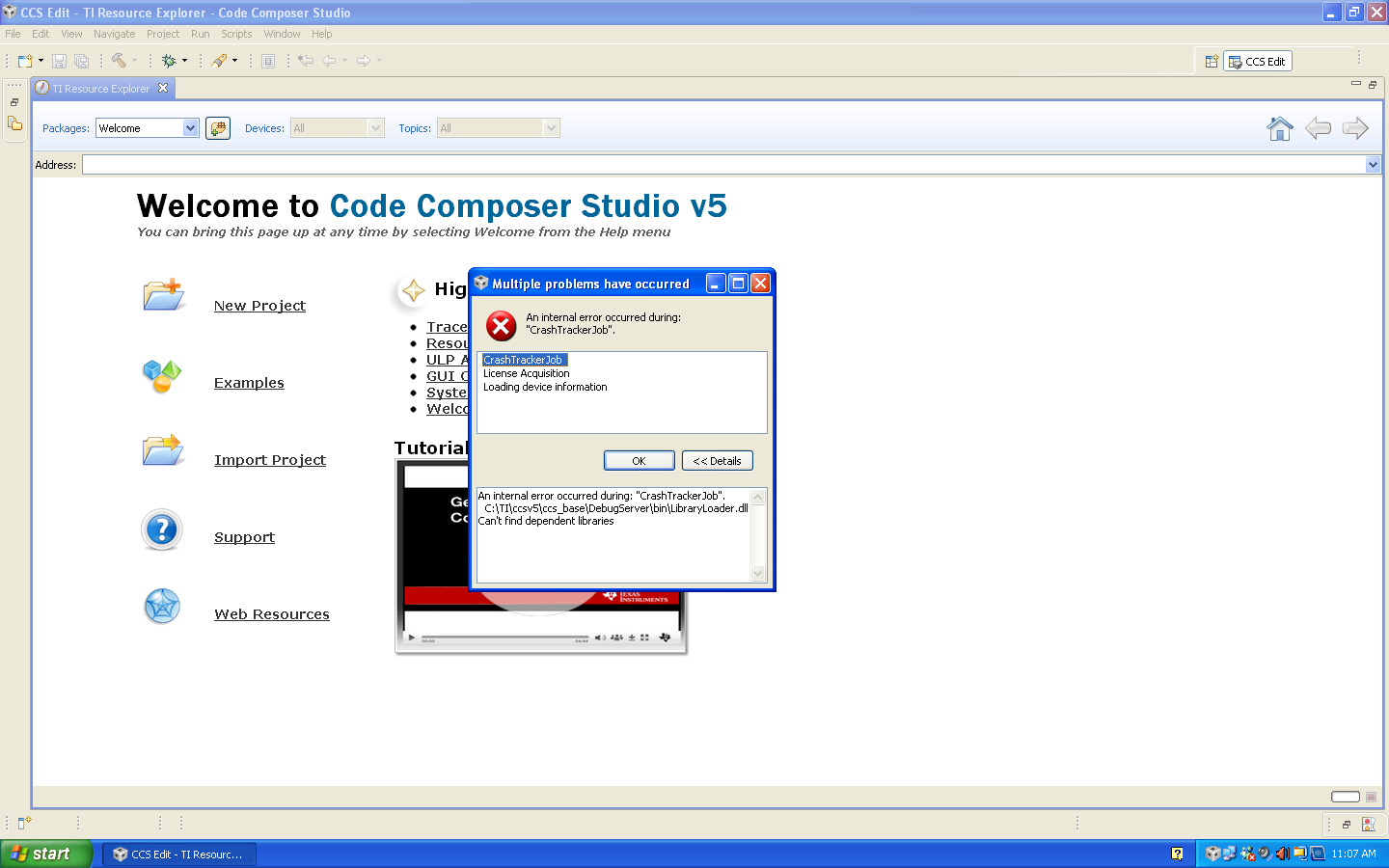

    I tried installing the CCS v5 software on my desktop and it is showing errors after installation is completed. Though I have it installed in my laptop, also need to install it in my desktop. Can you suggest me the steps to solve the problems shown in the image attached.
    T hank you.
    Mit
  • Hi Mit
    CCS E2E Forum would be the right place to get this resolved..
